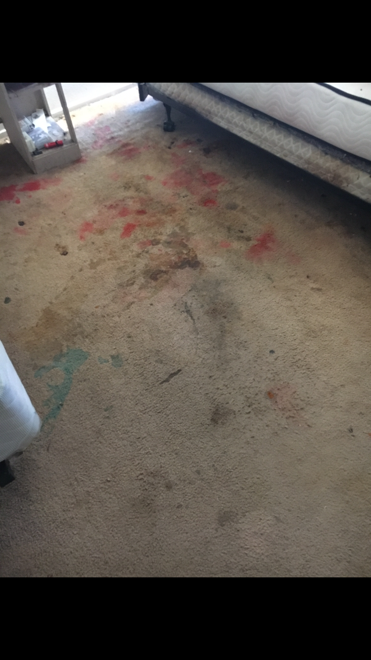

From the pictures, it looks like it's about 200sqft. You're saying you charged $400 to clean and dye it?
C
Chris Howell
It was more than 200 sq ft. It was a living room, hallway, and two bedrooms all together. I don't remember the overall square footage. I just remember that we charged two dollars per square foot for the spot repair, urine decontamination, and dyeing.

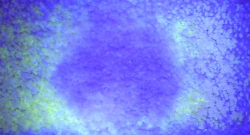

I'm annoyed at the clients who buy their own UV light, and thus can never be satisfied that their carpets are usable.
You can get rid of the UV fluorescence, but it takes a strong UV light plus oxidizer :
http://www.cobbcarpet.com/uvstain.html

We would apply the Fabric Brightener (15% peroxide) diluted 1 to 1, or 7.5%.
We are working on generation of Hydroxyl ions in solution for deodorization.
