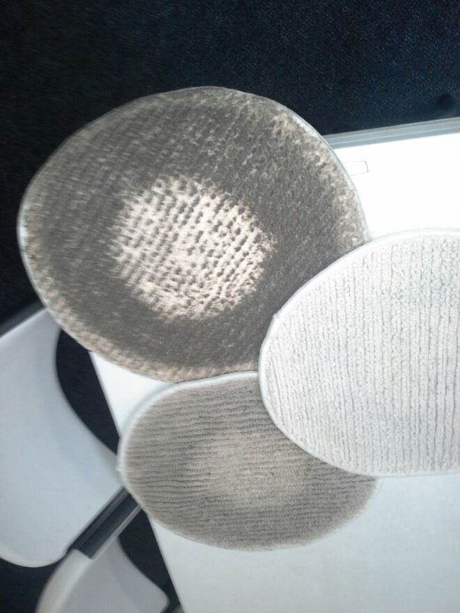

Just a little friendly testing between 2 op machines on cgd. The 3/8 orbit, slower machine actually pulled alot more soil than the large orbit, high speed op in this testing.............
Physics at work is all it is.

The OP producers used to actually transfer dirt to cotton pads, and did remove a fair amount of dirt.
Raising the orbit and speed of the machines seemed to happen at the same time encapsulation was becoming popular. The higher speed and abrasion quickly destroyed OP pads that worked well on the slower machines.
Manufacturer found they could "do" carpets much faster by giving up on "removing" dirt, and instead used more durable pad combination to just encap the dirt. Voodoo that worked well and sold a new generation of machines.
Time will tell...

I'm not a guy to bash any particular machine, however I am against saying a machine is more than it is. large orbit, high speed machines do great at encapping, but I'm in the business of removing soil.
Thanks Mikey. Yea, the steamin demon, as small as it is, does amazingly well in my business model, and I use it quite often.

My thought is the actual speed plays a huge factor in soil removal. How? On a 3/8 orbit, the rotation is slower, even though the orbit still oscillates at 1725 or so. This allows the pad to dig in a little deeper and actually absorb soil more efficiently. A downfall is the 3/8 oscillation doesnt travel past the fiber before returning, and does pose a risk to tip bloom.
On larger orbit machines, the offset forces the driver to spin twice as fast, and the added 1/4 inch of orbit forces the pad past the individual fiber before returning, never really digging in at all. The only benefit to this is the reduced chance of tip blooming. As Lee stated, the manufacture realized the reduction of soil removal and decided to attempt to be a direct competitor for high production machines such as a cimex.........Which is, and should never be a stand alone process unless vacuuming is done often,...........and correctly, ( and that is rarely the case)
Nothing wrong with this type of cleaning or the machine. For what it is, and for the educated on what it truly does, it does great, but it isnt by any means a type of pad extracting op machine.
But to answer your question, Naw, it doesnt have a soul..............but the operator should have a conscious on where it can and should be used.

The faster the pad driver spins the easier or faster it will glide over the carpet but gliding over the carpet fast doesn't equate better cleaning.
I can get the same cleaning level of cleaning with a 50lb fixed orbit towel machine as the larger op machines, it will just clean slower.
The pad driver doesn't spin with the towel machine so it digs in better.

The testing was between a cx17 and a trinity.
Now Larry, I dont necessarily mean to undercut any machine. Its not necessarily comparing apples to apples here. While one is designed more to pad extract, the other is designed more for encap.
