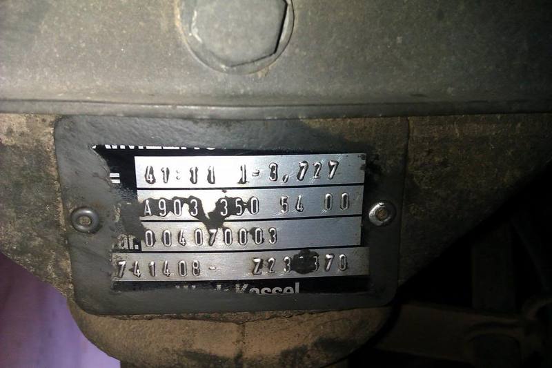

can anyone ID the gear ratio on this rear diff tag?
Giorgio
Apr 14, 2011
1,817
Giorgio
my sprinter van has a bad rear end. I need to know whether it's a 4.11 or 3.72 gear ratio.
Both numbers appear on the differential tag.
Can anyone tell me what it is by looking at it?
The van is a 2003 Dodge Sprinter 2500 w/ ABS.
Thanks!
41:11 = 3.727
Ring 41 teeth...pinion 11............41 divided by 11 = 3.727
Dan is correct as far as standard nomenclature with 3.73 (rounded up from 3.727)
just showing what the numbers on the plate mean ..... and providing the answer to the question that appears to have been asked of you (4.11 or 3.72)
