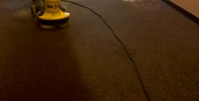

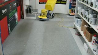

Hells YES!
This is basically a metal box with some carpet glued down, tons of traffic no vacuuming. Filthy, i was shocked.
We use releaseit but i am sure others are just as good.
PS. i still have a blackberry so pic is not great, sorry.:dejection:

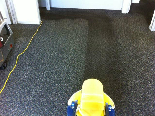

What is your production rate Richard? Say an open area heavy soil 3k sf. I have never done better than 1500 sf per hr. One tech one cimex
Al

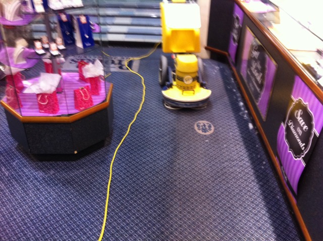

Al I agree on heavily soiled you're not going to knock down great numbers and you may not be able to price that as cheaply as moderate and light. However you can consistently produce the 1500sq/ft. Where if you were slinging a wand your numbers would drop off as you Honestly if is its any dirty than what is pictured we would HWE the area and the encap the rest. Its not unusual for us to HWE the entry and maybe even funnel areas and encap the rest.
