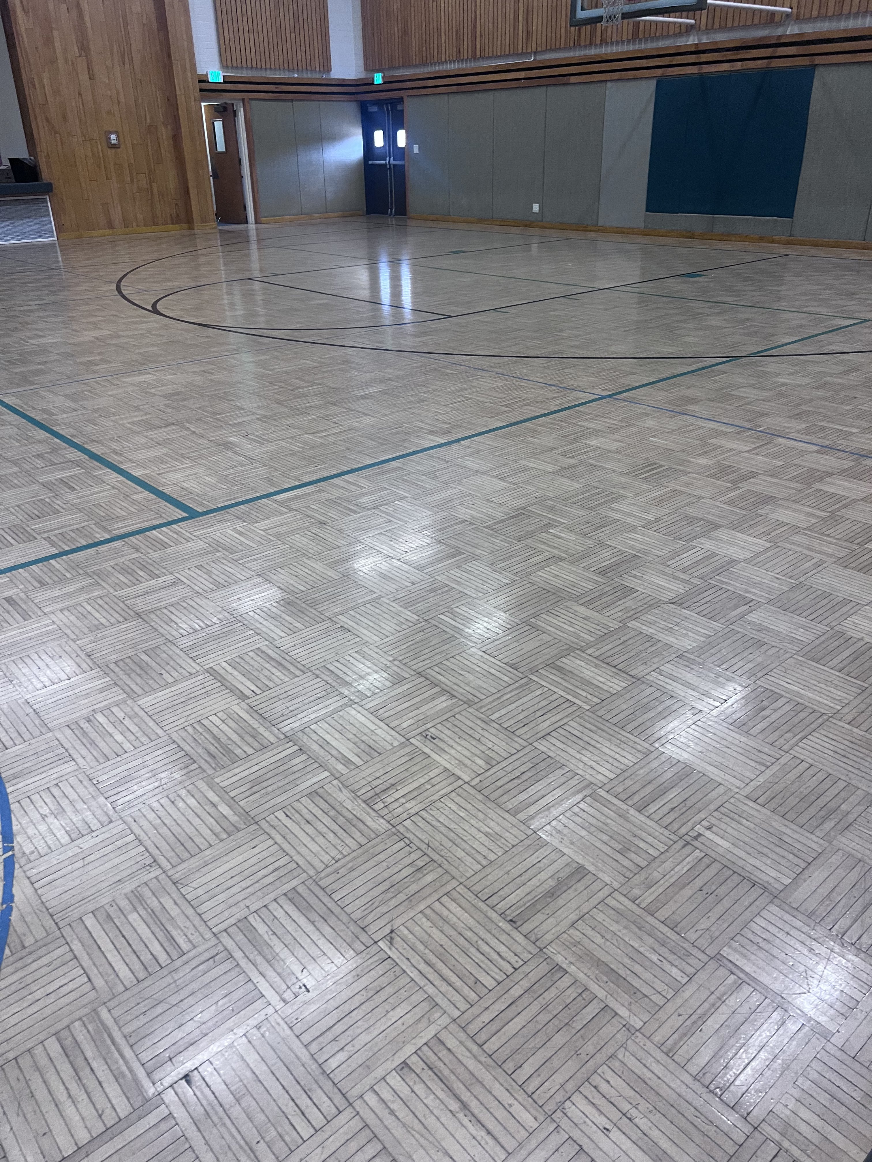

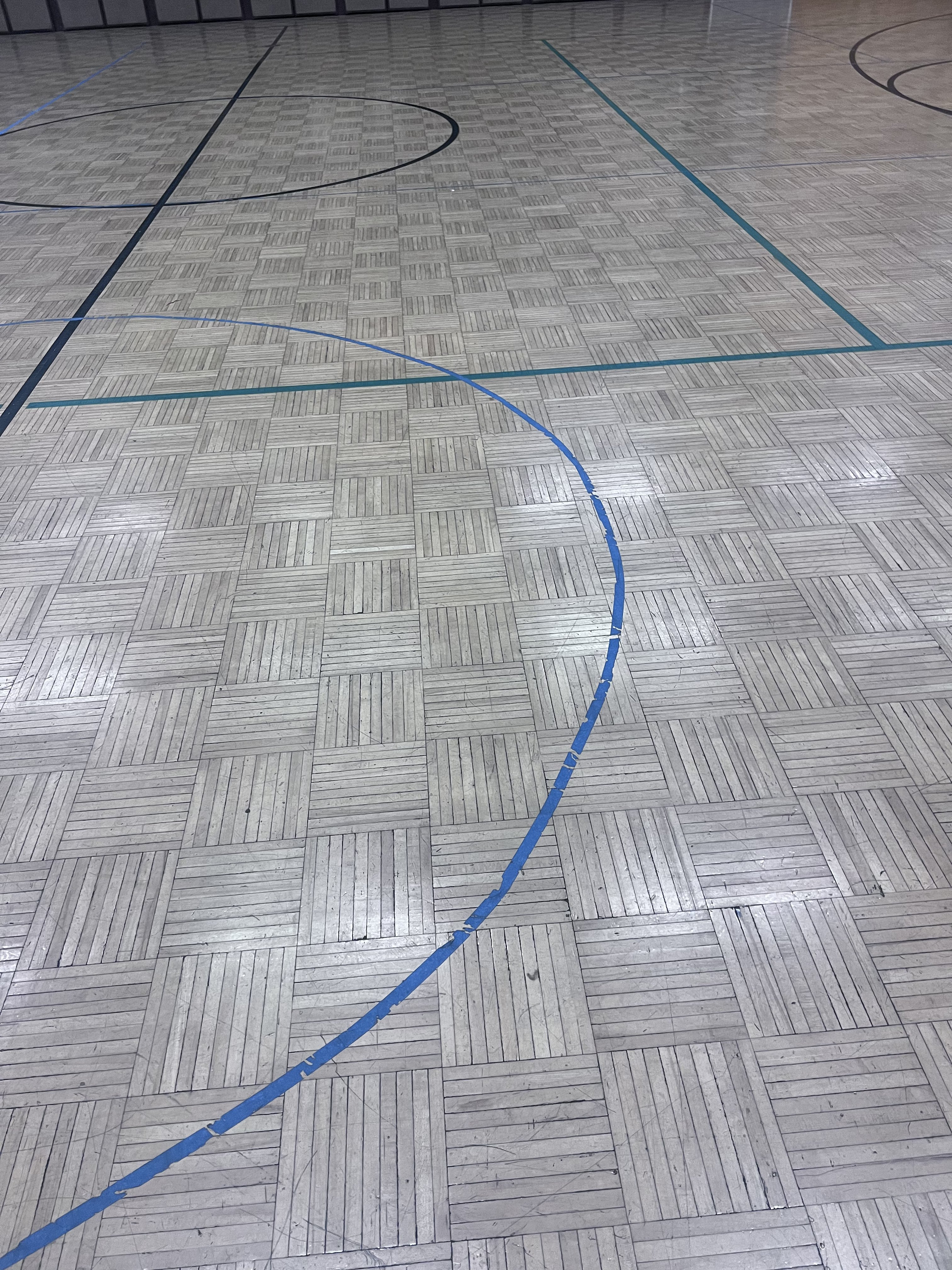

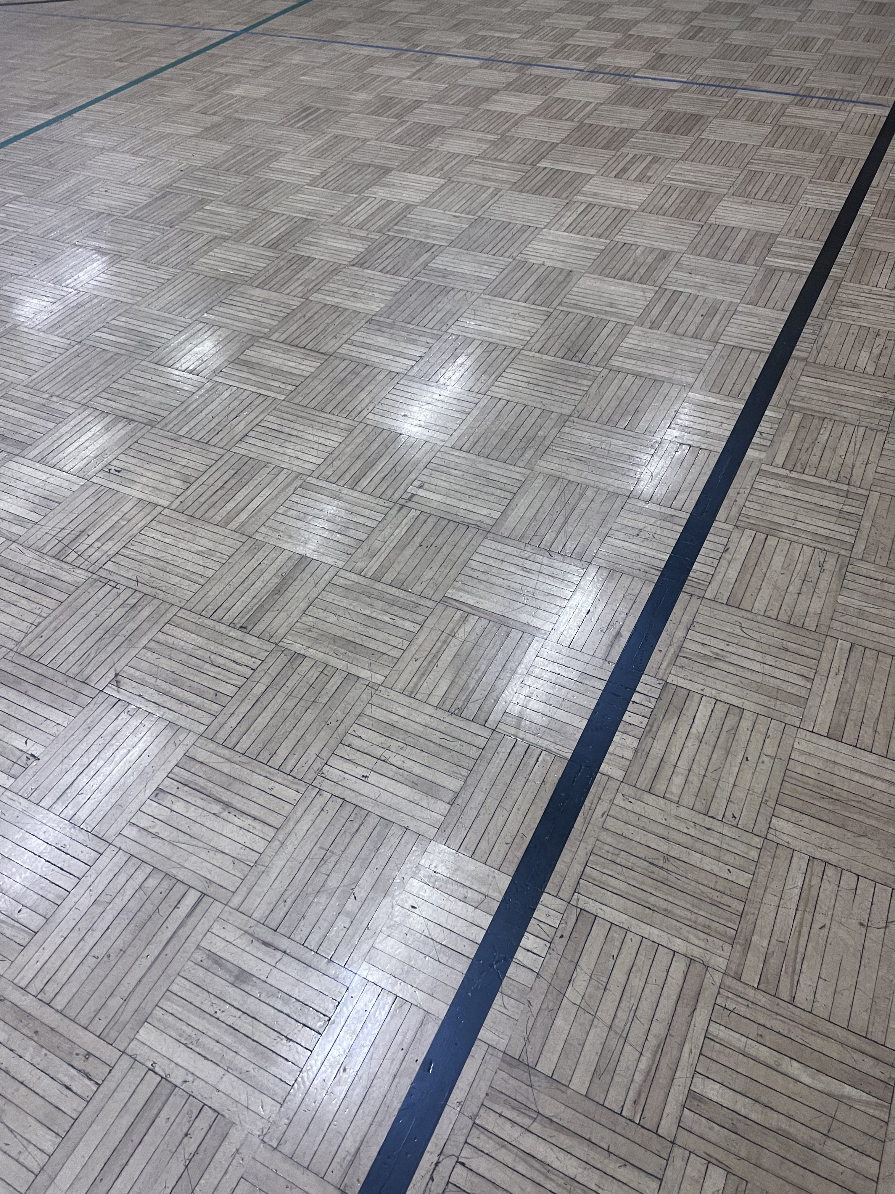

My church building basketball court needs to be redone. Is there an easy way to make this look better? What would be the best process?

That's a lot of freebie for one of the worst looking gym floors I've seen. Follow Marty's video find to stay out of trouble.
Just imagine what screen sanded vinyl looks like.
7,952
Yukon, Oklahoma
However, vct was Never was meant to be screened and wood is. Screening is not scary.
You could do a test patch in a corner area. For goodness sakes it couldn’t hurt it. That being said, using the 175 and orbital sander is easy with spp’s. That is a big first time floor! I think Basic coating is easy to work with.
