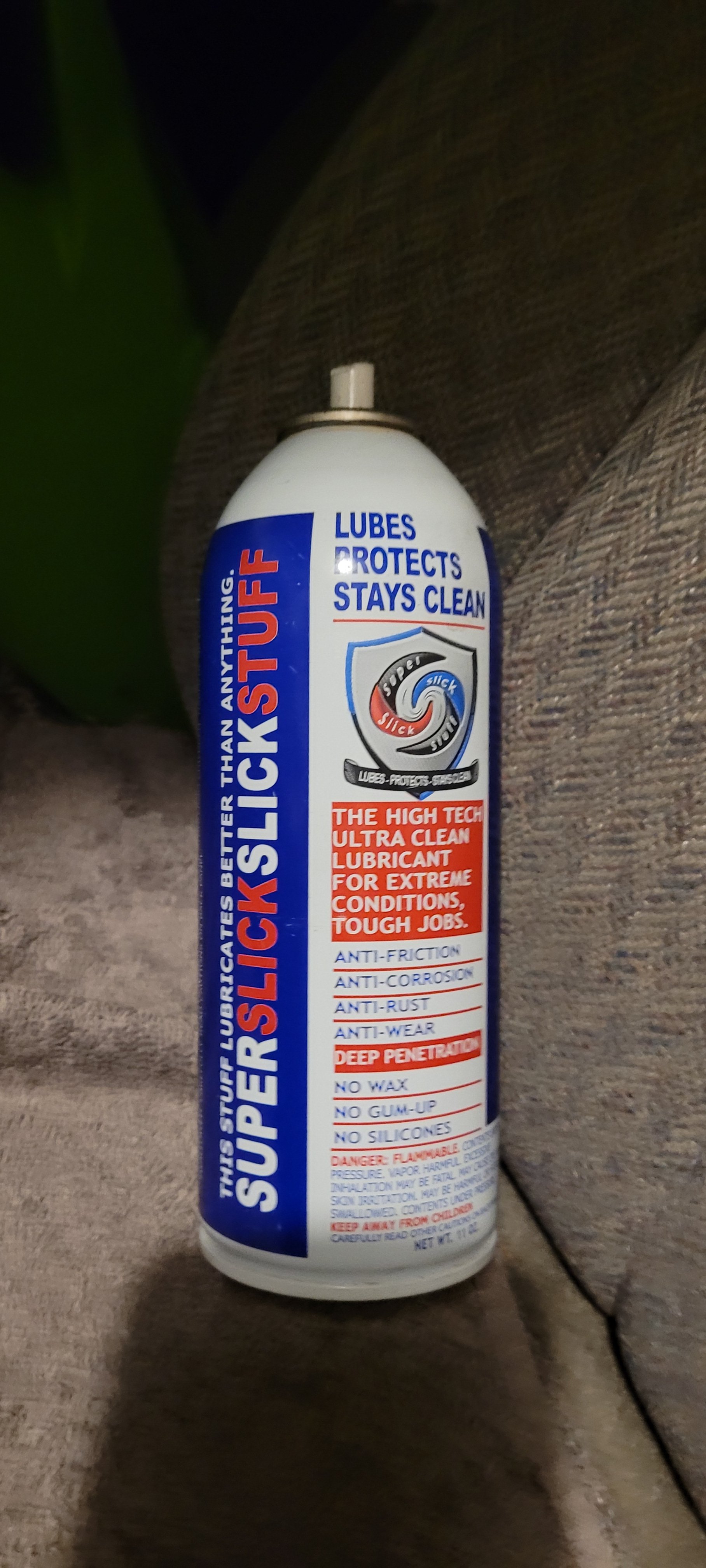

No grease ports. It's not the bearings. When the blower heats up the tolerances tighten up. It's why it's important to keep it clean.
Get it hot then hit it with water for ten minutes then let it heat back up about ten minutes then hit it with lube. It helps break the carbon and rust off restoring the original clearance.
Sometimes this is why belts get eaten up. Too much resistance in the blower.
Don't be afraid to use lubricant in your new blower or you may eventually have the same problem.

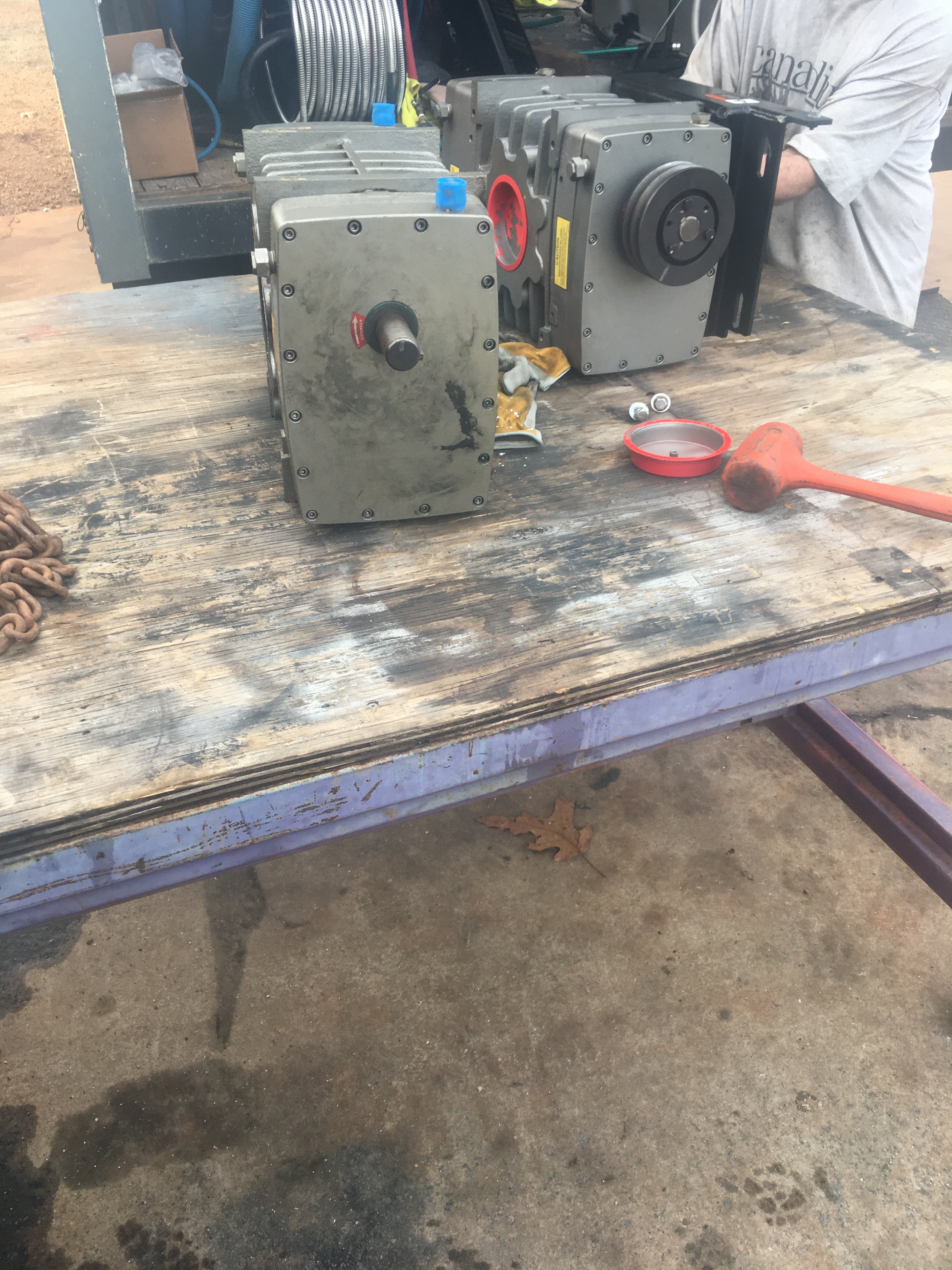

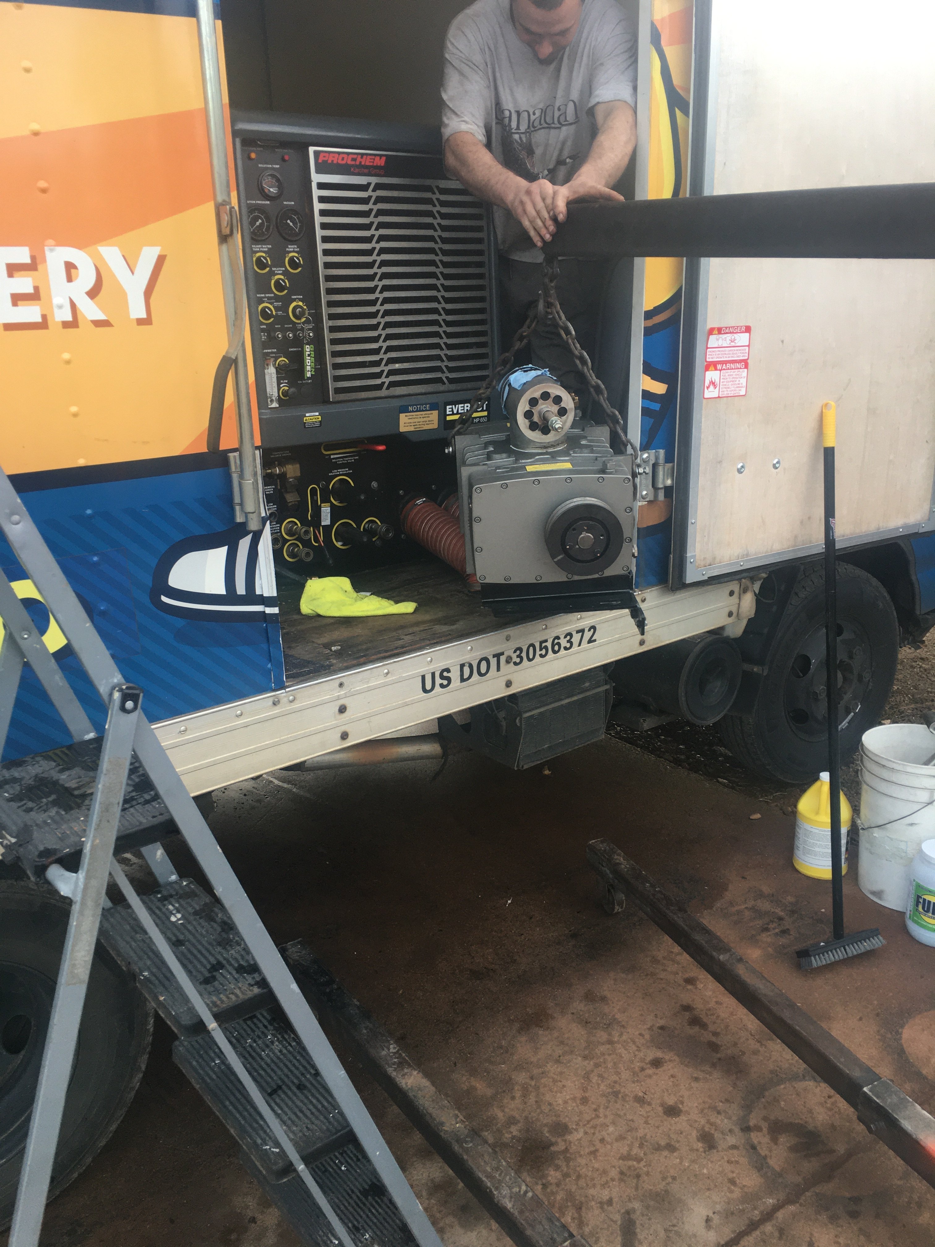

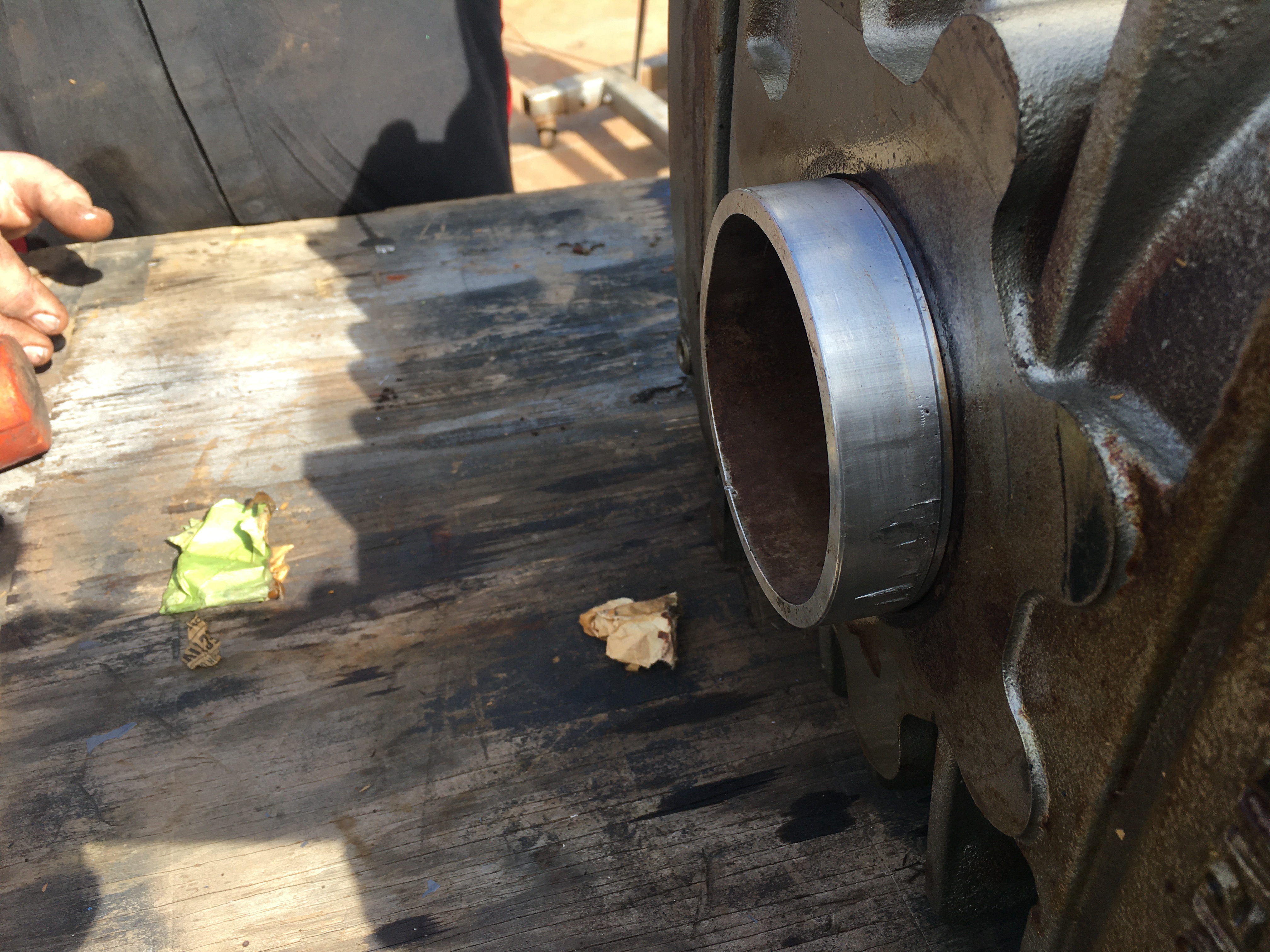

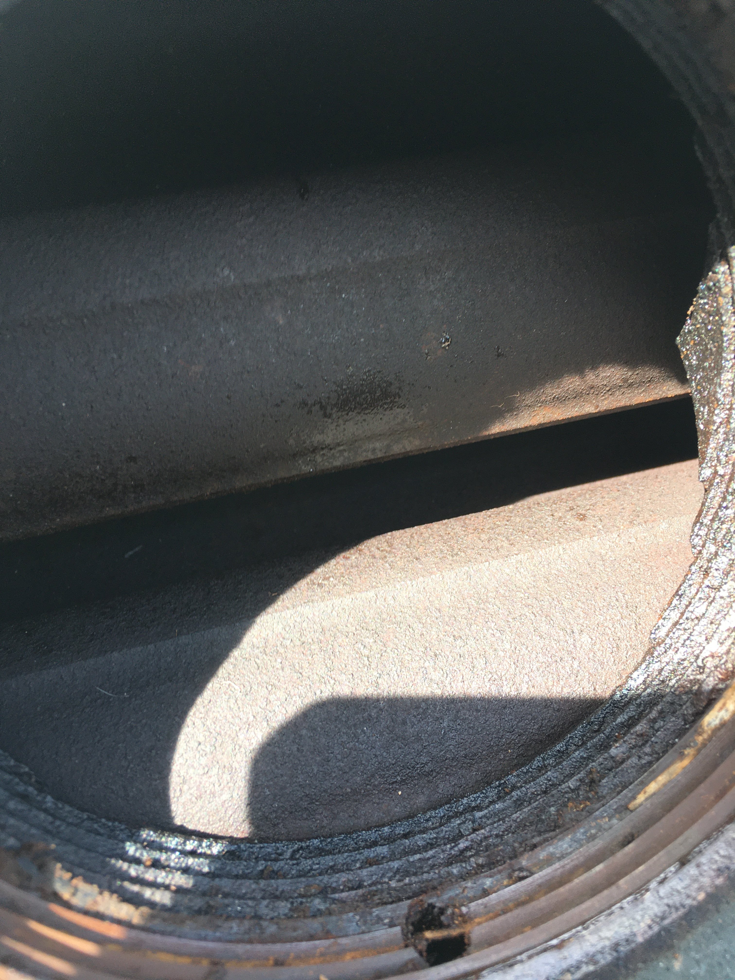

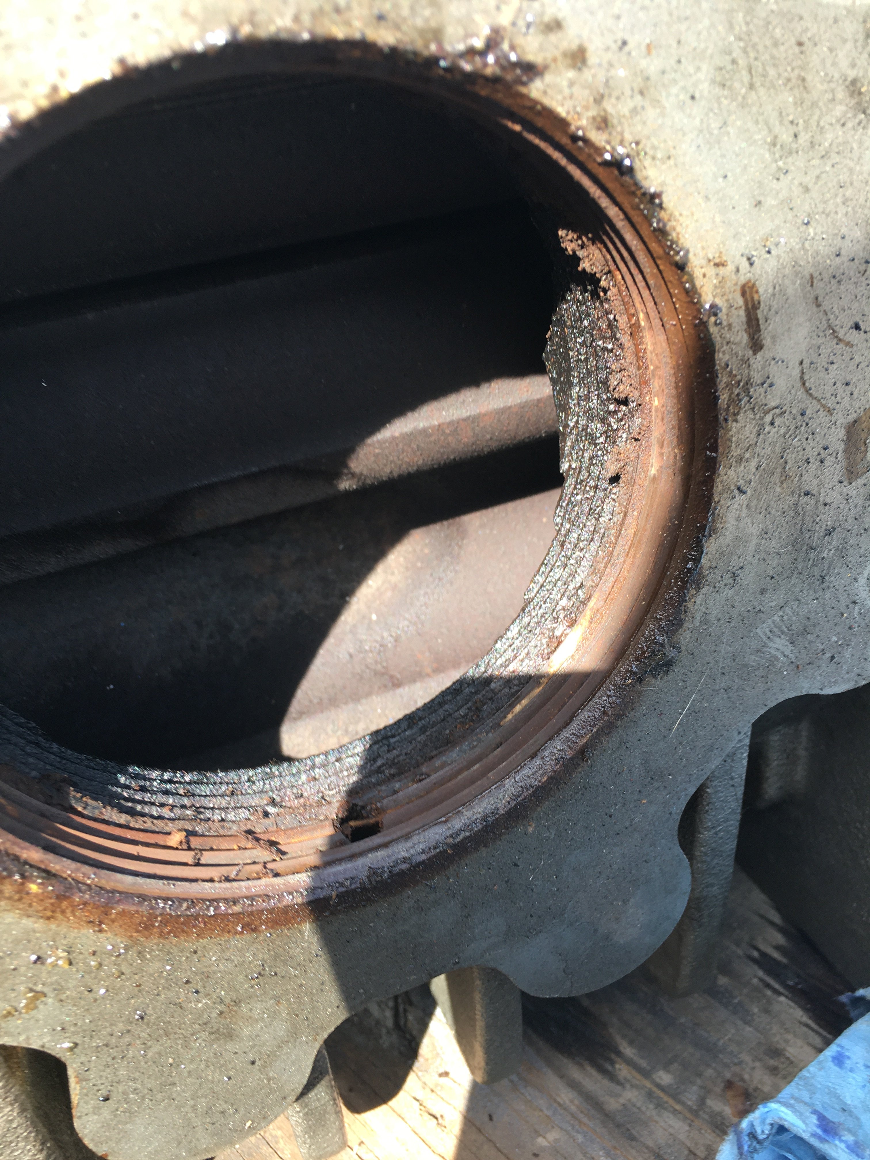

Got the blower out. Can’t remove the bottom pipe, so I’m having a new one made Monday. ☹️
Here’s a couple pics of the lobes. I hear a mild grind when I turn the shaft. I tried moving the shaft side by side and it didn’t have any play this time. Weird
View attachment 120539 View attachment 120540 View attachment 120541

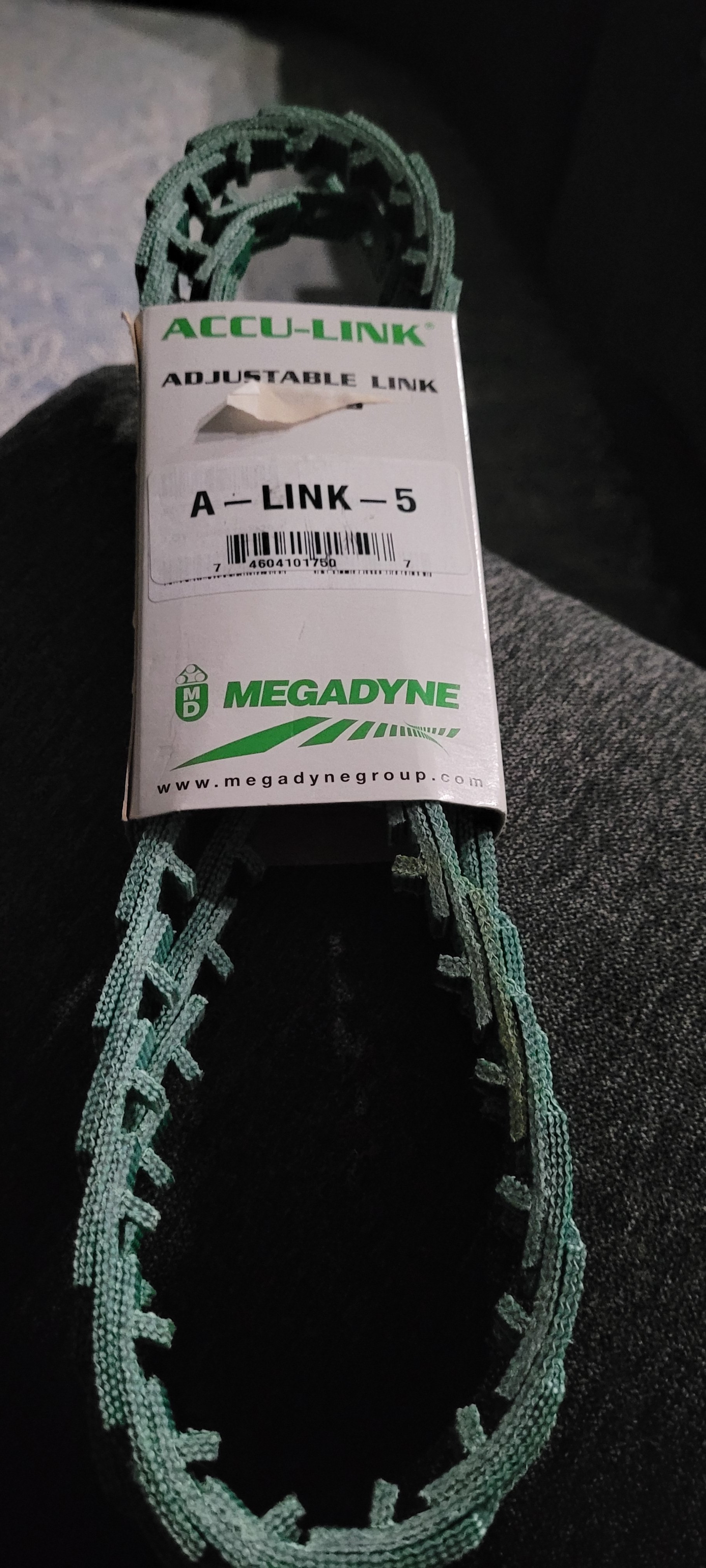

Hello there, I did scroll through many answers, and you've got some sound advice. " Court has ruled on the defective blower." Before you accept that ruling, I want to point out that the positions of shafts (once set correctly) shouldn't be variable unless the blower is removed and set back. On my setup, I'm using TB Woods coupler -8J, and Accu- link belt( I searched history ), and there is no mention of it, so I thought I shared the info. Before starting to use this belt, I found out that this belt is used in many industries, and the foremost benefit is eliminating vibration and desired tension. You have to adjust it ( remove one link at a time) quite often, but after that, you are going strong for months. I have used five belts so far. The Reliabilt unit has 2800 hours. It has an actuary motor to move the Kohler engine ( 2") to replace the coupler, but that's the only occasion. One more thing I learn about my blower. Its favorite lubricant is Super Slick Stuff( it emits a pleasant citrusy scent); it's not dingy as other lubricants.
I hope you'll find this information useful.

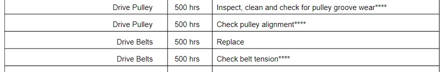

So if im doing the math right you've gone thru 5 belts in 2800 hours?? you're getting on average 560 hours on a belt?? and you feel this is good??
  • Wow
Reactions: Dolly Llama
Dwain Ray
Jul 22, 2020
1,141
I think I would look into clogged belts and stop changing belts with each oil changeon my blower but that's just me
That's alot of belt changes, on my pto i change the Serpentine belt around 1000 - 1200 hours, blower belts whenever they fail or look bad during routine maintenance(easy to change 10 minutes tops with just a crescent wrench) they usually last 2¹/² - 3 years. pump belt about every 5 or so years
but half your truckmount is up front
this is relatively compact design with a gas 4cyl with a layout that means the belts are going to be subjected to more heat
and it isn't like Matt hasn't went well beyond the suggested interval
another thing Matt may want to look at is that they suggest a specific belt model, BP40 predator, which according to gates is more well suited to the application than "whatever autozone has in stock"/standard B belt
