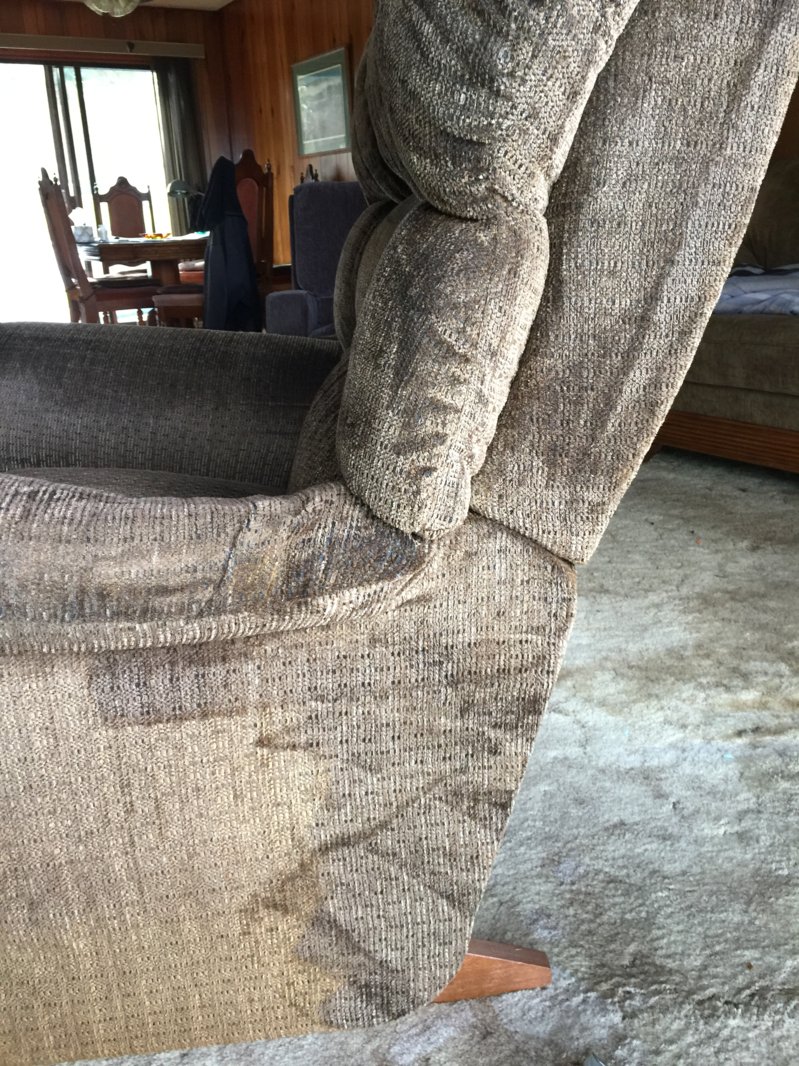

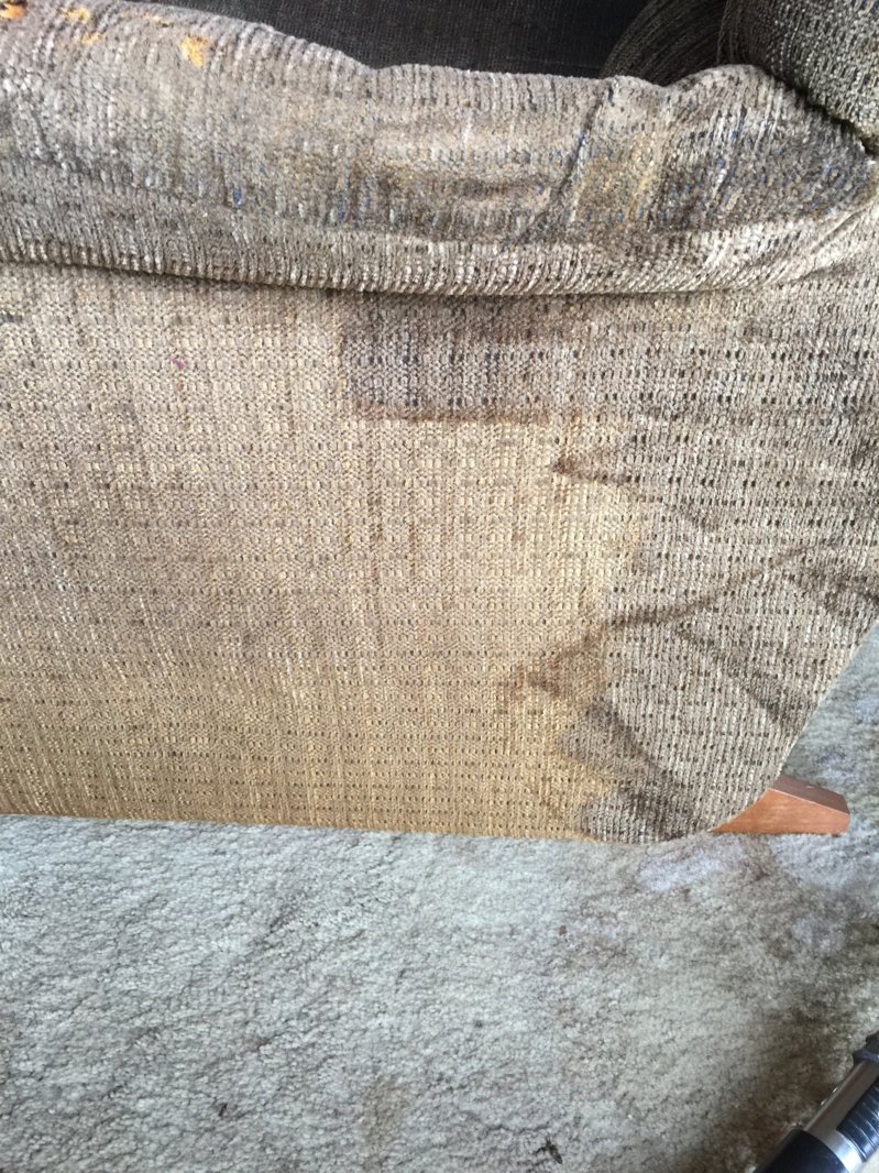

Finished the carpets, just about ready to pack up. Customer asked about a quick chair touch up. How about a full restoration clean?

That particular chair has two issues that need to be addressed:
1. There are holes in the fabric on the arm. That explains their desire not to spend much on it, but such people are just the type to blame you for those holes. I don't know whether or not you mentioned them, but never assume "they had to know they were there".
There are ugly people on this earth who plan to take advantage of the naive and well intentioned of the world. In my mind, its the same mindset that has a person pretend their car is disabled on the road and then rob the good Samaritan who tries to help. Its the same thought process, it only varies in the degree of money stolen and violence involved...but the sociopathic evil is the same.
2. Nicotine staining such as you see there sometimes will wick to the surface as the fabric dries. I could see that same sort of person calling you back to reclean the furniture they abused so badly and wanted cleaned at a discount in the first place. Something that heavily soiled needs deep cleaning, not "touched up".

I did qualify the cleaning of the chair with the customer first. Once I cleaned a small area, I showed the customer the result. She was happy. So I proceeded to finishe the job. I did setup air movers for fear of wicking, I had a job just up the street so I returned to pick up the air mover on my way through.
And THAT makes me happy (imagine that!) Just be careful out there.
