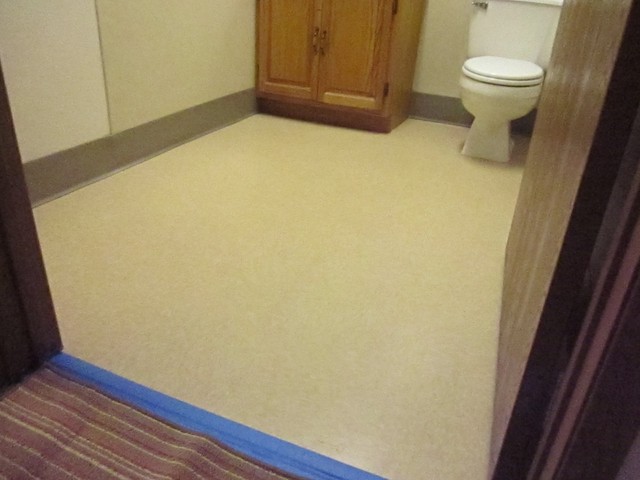

OK, I did the job and now I have a few more questions about some problems I had.Here are a couple of pictures.
Pic one is after I cleaned and stripped the floor.
It was pretty easy to get to that, since the floor tiles just had the light factory finish on them.

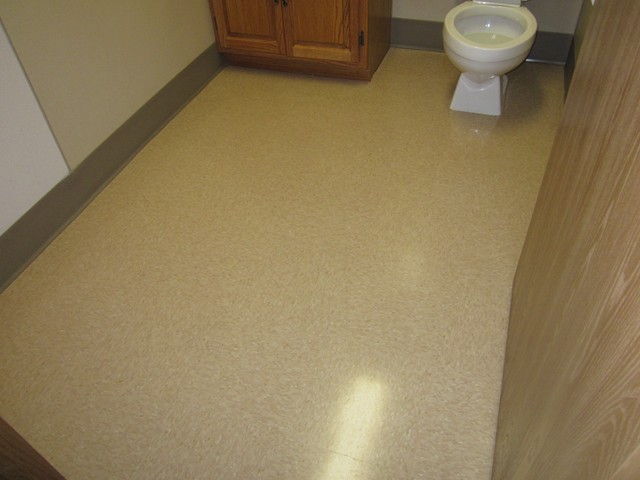

Pic two is with 4 coats.
The problem I ran into was that even though I cleaned and dried the floors, by the time I got the first coat of wax on, there had been some dust particles and even a few small hairs that had settled onto the new finish. The stuff was just in the air and on every subsequent coat there was a little more of that dust settling..I didn't know what to do about that.
I did not have a fan so it was just what was in the air.
On a couple of places on the sides the finish puddled up a little, I saw I had put down too much but by that time it was drying and I didn't know how to fix it at that point. Is there something I can do after the fact?
Anyway, this is how it turned out. Semigloss not the shiny mirror like I was hoping for.
Is this semi glossy finish acceptable on a job like this?
The office opens tomorrow and I'm hoping the customer is happy, but I'm not sure how much better it would have been if one of you experienced guys would have done the job.
I also don't know how high customers expectations are on something like that. Does this look OK to you?
If the customer has any complaints about the dust flakes that are visible in the finish what can I do to remedy that? Would buffing take that out? How soon after the last coat could I start buffing the surface?
I suppose if I'm going to take more vinyl jobs I'd have to get some type of rotary machine but right now I don't have one . On a small job like this it might have not been useful anyway, what do you think?
Looks good what finish did you use?
how many lights other than the one is in the space?

I think it looks great...
here is a few things to remember...
You are NEVER going to get it perfect....like you said "stuff in the air"...or there is sometimes thing stick to mops, and you dont see it til there is finish, which gives things DEPTH.
Also, brand new floors, hold finish differently...cant really explain why...it just never looks as good brand new, as a job i have stripped 1 or 2 times after installation...
You probably freaked out after the 1st coat, because it may have looked blotchy?? After over 20 yrs of doing it....I STILL DO :lol:...just trust that it will fill in and look ok...
The puddling, isnt a huge issue more so against the wall....if it were in the middle, then there would be a problem, because it would show....
looks good, not bad for a newb

Hey Doug, thanks, I'm glad you think it's OK. I wouldn't know, I have nothing to compare it to. Yes the first coat did not look great. Jeremy already told me to expect that.A youtube video I saw suggested putting down the finish on the perimeter first, then I fill in the center. That's probably why it puddled on the sides. Very little, but it still bugged me.The applicator was loaded too much and by the time I saw it it had formed a film. I guess then there's nothing you can do,is that right?
I used a lambs skin brush attachment.I vacuumed it off first and checked if any hairs would come off it.That was definitely not the reason why I had the dust on the finish. If I'll do it again I'll try the sock over the doodlebug and a pad. I had trouble getting around the narrow spaces next to the toilet. That swivel would have made it easy. I didn't think of that. On my first coat i used a bucket with a linerbag. That didn't work well either, because the attachment was just wide enough that I wouldn't get to the bottom of the bucket. I ended up buying a deep paint tray at a Walmart which was closeby.That was great, I could load up the brush and then squeeze out what I didn't need on the flat part of the tray.
