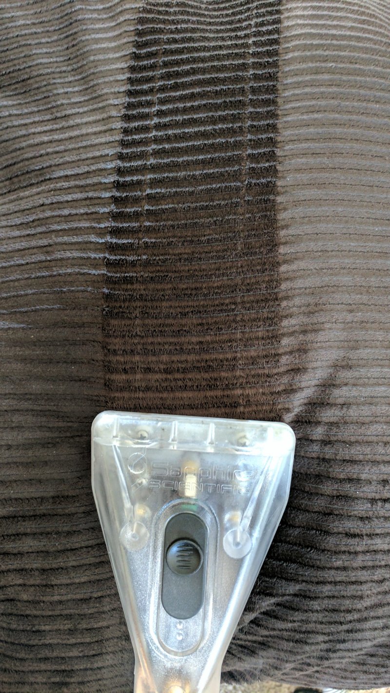

Can't get any easier than this..
117,261
Can you possibly mess up a Poly Corderoy?
I suppose over use of chems would leave it stiff.
Pre vacuum
Hose down with HydraForce and Procyon. Makita/ beige pad, SSPro against the grain to clean, with the grain to dry. Palm groom.
I wish more people bought this instead of Ultra Suede crap..

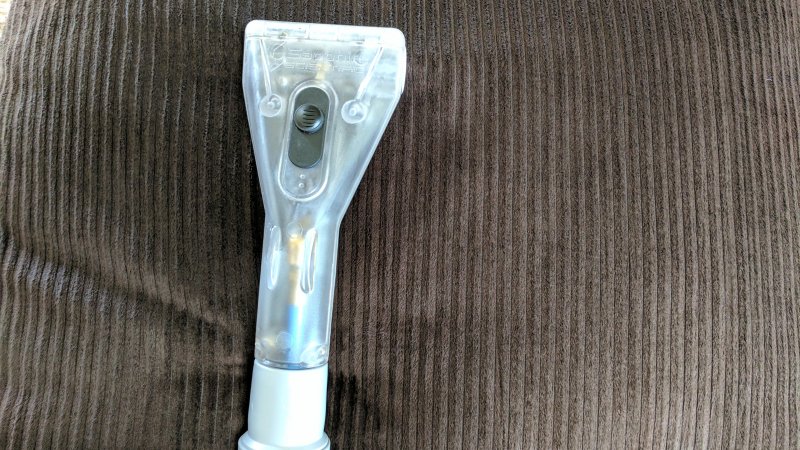

15,253
How does that SS tool compare to the rotovac? Can they both be used forward and backward like the rotovac?
And I wonder if those little solution holes get plugged up a lot on the rotovac.
117,261
I like it better Jimmy
Less knuckle contact with the fabric.
Once you go clear there's no going back.
No piss spot.
Nicer trigger.
The RV does provide a bit more aggitation due to it's spray bar design

Love the ss pro. Only bitch is you have to clean it out a lot
