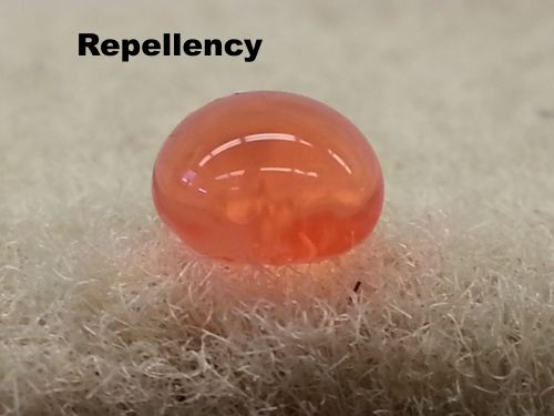

For any protector to perform well. It needs to adhere to the carpet fiber. Residues from cleaning, especially surfactants, and various soils prevent the protector from adhering well. It will not perform as well as it should nor last as long as it should. The point - protector should be applied to clean carpet!

We agree with clean carpet before protector application.
That is easier said than achieved.
A solvent-based protector will do a better job of displacing residue,
since most carpet fibers are synthetic fibers, and have an affinity for the solvent-based protectors.
