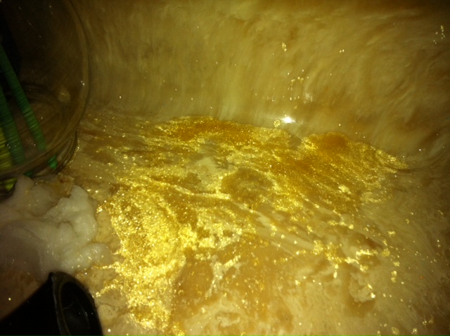

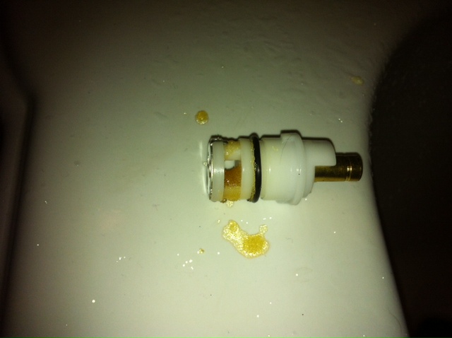

7 days later and still removing gold dust resin from the faucets in the home! Yesterday the company agreed to order a new pump from Wintrax, I told them I would install it.
He acted as if I had taken advantage of them! I said first of all I have never received an apology for the fact that their tech/company caused me all this stress and the fact that I have put over 15 hours of my own time into getting the problem solved. I told him what I could have done was take it to have it serviced, have a new pump put on with the labor cost plus the labor cost to clean out the system and all would probably have run his company around 3k, then I could have taken them that bill instead. So I figured I had saved them over 2k. Not to mention if I had not had a back up TM then they would have been out lost income for that.
And what if the new pump (and possible uploader) don't solve the problem, we'll see next week.

if you did not do it already.....drain and flush out your homes...hot water tank.... and if you did...do it a few more times......bet it looks worse then the bottom of your fresh tank.....probably why you are still seeing this crap in your house.......
If it is gas..turn it off at heater....if it is, electric....turn it off at panel......
turn off water supply to hot water heater....put a hose on the drain valve and drain it as much as possible....once it it drained down...leave drain valve open and turn water supply back on and let it flush for a while....the drain valve is about 3 inches taller then the bottom of he tank so those little hell beads are probably nesting in it.....

Oh crap. Thought it was installed in the truck. In the house really really really sucks. I should read everything I see now your faucets are all plug damn. Sorry Billy you have big problems bigger then just the pump.

Yeah, this faucet is from my daughters bath, it was the only one I didn't get a chance to flush out last weekend. It also was closest to hot water tank, so with this the washer, dishmachine, one other faucet, & 3 commodes it took about 3-4 hours all together to mess with the house.
Jim, I did drain the hot water tank, and alot came out of it also, but not near as much as went through the V. I will do the extra step you suggested on the tank, thanks.
This is a commercial system installation so bigger tank of resin. My suggestion to anyone having a system installed "IS to STAND OVER THEIR SHOULDER" when they hook it up to make sure it's right! lol
