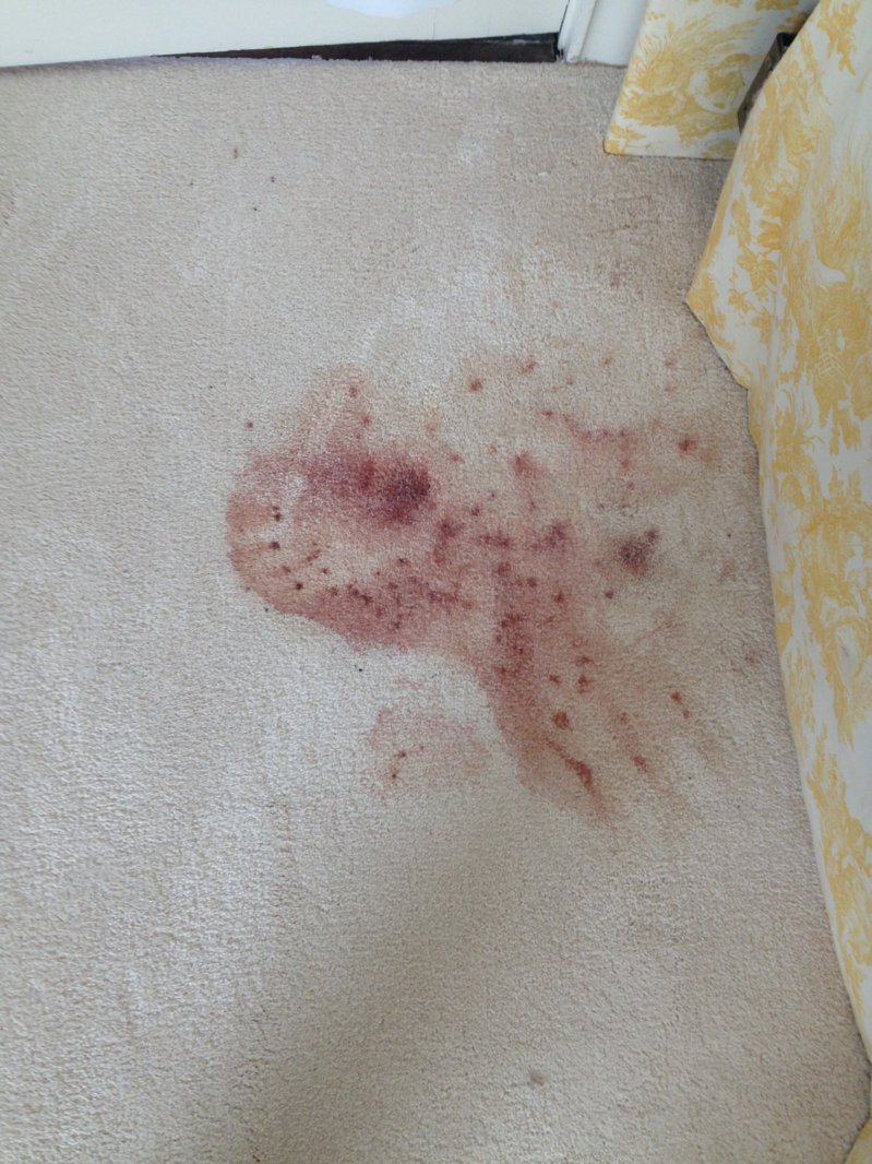

I should have done a video because it was amazing to watch the process.

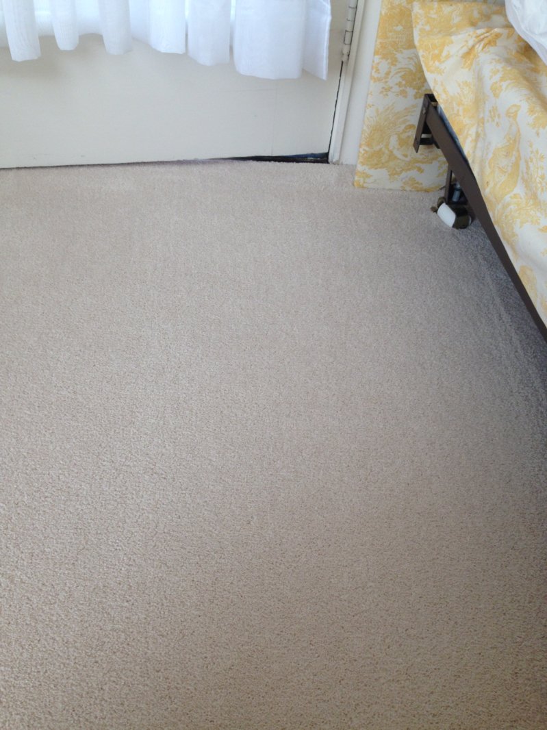

1st I used a Drimaster uph tool with Oxygen Release Emulsifier running thru. Several passes removing layer after layer. Blood seems to come up better before adding any products to it. I used this tool to avoid pushing any blood deeper into the carpet. Once I removed the large amount of blood, I was left with a light discoloration - like a yellowish brownish tint. I then applied some Stain Zone and took a hand brush and brushed it back in forth gently. That seemed to make it disappear. I let the SZ sit while I cleaned the rest of the bedroom. Before I left the room I did a light back stroke rinse with extra dry passes. Then I applied a light mist of SZ then groomed it in.
He was reaching under the bed trying to get the cat. Old man grabbed a hold of the cats hind leg and Im guessing the cat didnt like that. That blood pile sat for about a month while they were on vacation. I told them if anything wicks or discolor to call me back right away. I guess it worked out.
