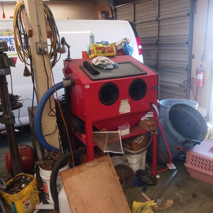

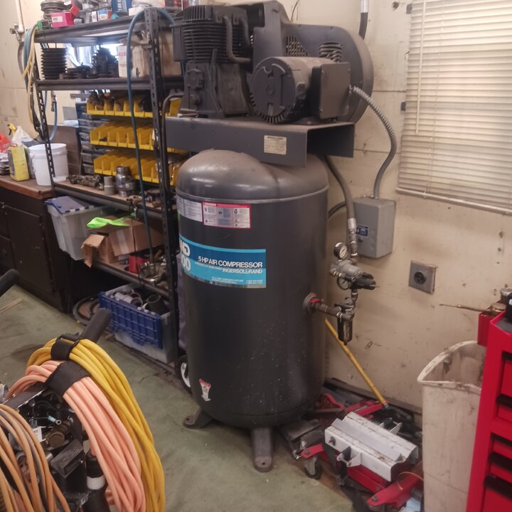

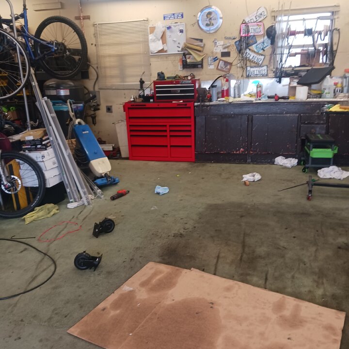

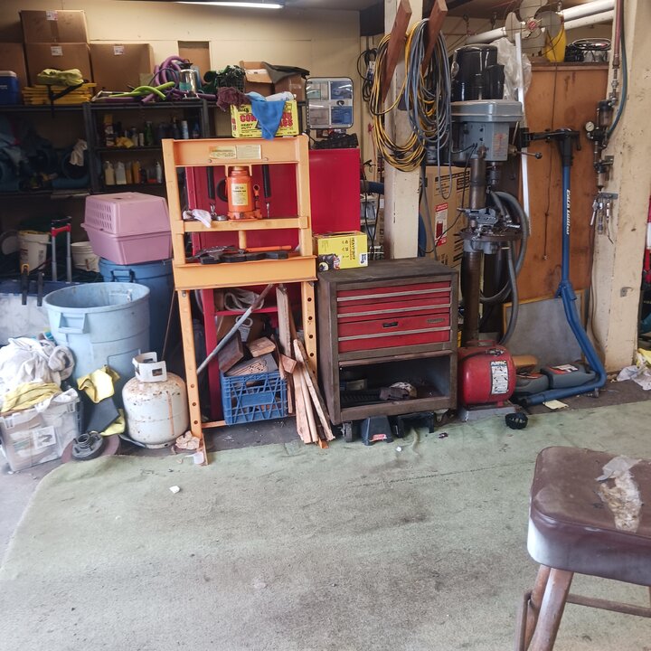

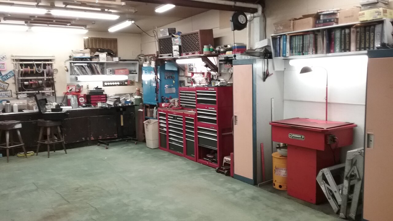

20170328_215327 (1).jpg IMG_20161113_154756631 (1).jpg 20201101_082403.jpg 20250119_140446.jpg 20250524_133823.jpg 20250119_140822.jpg 20250524_133808.jpg 20250524_133814.jpg 20250119_140715.jpg

Thanks Dwain. That's impressive all around. Hard earned I'm sure.
I don't have the desire to go as far as design and fabrication. But it would be nice to learn how this CDS truckmount works, and be able to use, maintain, and repair it. My business depends on it.

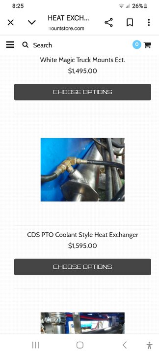

Thanks Dwain. I thought it was going to $1500 or more. $900 would be a relief to me. I'll get on it. And hopefully tomorrow the 4 bolts holding the exchanger on behave differently.

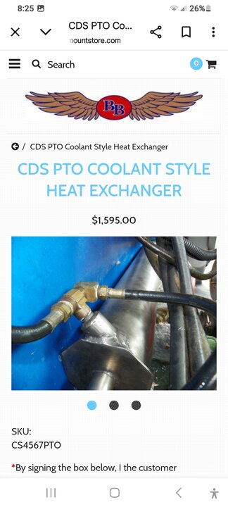

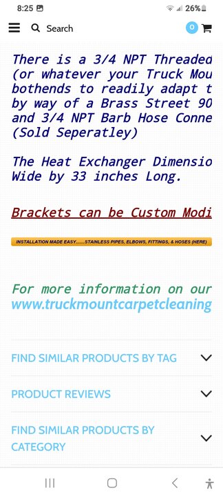

I just had a thought, Blue Baron used to and maybe still does make an all stainless heat exchanger for hydramaster ptos. Is was touted as higher quality and much higher pressure rated than the copper ones . From what I've heard i myself wouldn't buy a machine from this company ive heard alot of complaints about him but i have heard that they do make a great heat exchanger that will retro fit a hydramaster pto and its rated at 3500psi where as the copper ones are only 900psi but i personally won't run um above 500 and i have 4 bad ones setting on my shop floor because o went a little higher. Might ask around on this and other fourms if your interested and see if you can a few people that has um and see what they say. There's also a bunch of YouTube videos on there heat exchangers

Thanks guys. I'll read more about them and then call these folks once I get my heat exchanger off the waste tank so I can look at it the way Dwain showed me. I have a feeling the small fresh water tubes are crushed. The previous owner of this tm had the coolant still hooked up but all the fresh water lines removed and bypassed from the heat exchanger, probably no flow.
I like the idea of stainless steel small tubing inside with a much higher psi rating! Hopefully the mounting bolt locations are or can be made on these upgraded heat exchangers in such a way that they line up with the stock CDS heat exchanger, so I can bolt it in the same location to the waste tank.

I called TTI fabrications and I first received the coldest "hi" one can imagine when calling a business. I thought I may of dialed the number wrong and got some random persons cell phone. They asked that I email them some pics of my heat exchanger, so I did along with some measurements right away. 24 hours later I hadn't heard anything so I call them again. The phone just keeps ringing and ringing, nothing... 2 days later still no response.
I called Peter at Blue Baron and he called me right back, and he was helpful and enthusiastic. Looks like I'll go with Blue Baron. About $1700 with shipping for the heat exchanger. Seems like it will be built to last, all steel tubing and fittings, 3500 psi rated, and he told me I can use it on coolant and exhaust heated systems... I sense this thing will last a long while, could maybe transplant it truckmount to truckmount for some time.

I read some folks mention major problems with Blue Baron on old threads. Are they generally alright to do business with?
Dwain Ray
Jul 22, 2020
1,111
I have heard both good and bad.i personally would not consider buying a complete machine from them. Most all complaints ive heard has been with there machines and delivery delays.ever sence covid its as if they don't have the funds to get or have the parts to assemble on hand. However ive heard only great things about their heat exchangers. With that said i myself would consider and possibly buy a heat exchanger from them but i wouldn't pay 100% up front most of these companies that build heat exchangers build them to order i myself would put up a down payment but not 100% not untill it's ready to ship
