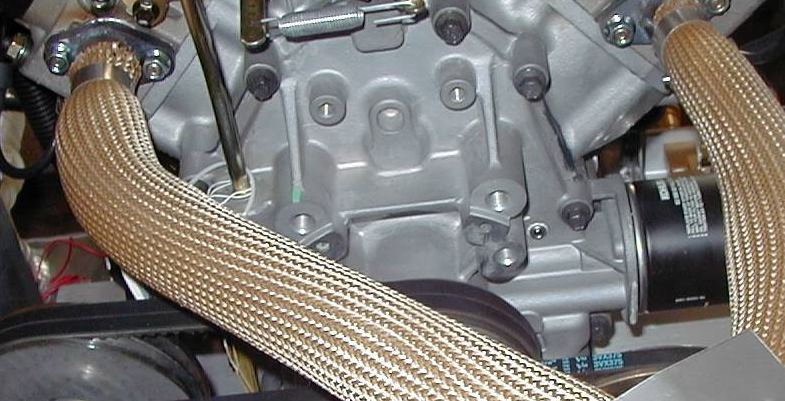

Shane;
We use a high temp woven cover over our TM stainless exhaust system.
It is a tubular product that expands similar to a chinese finger puzzle.
It also delivers more heat to the HX.

Larry Cobb
5,795
Dallas, Texas USA
Larry Cobb
Shane;
Wrapped is quite different from the tubing shown.
The tubing has air space that provides more insulation to the exhaust pipe.
Larry
Larry Cobb
5,795
Dallas, Texas USA
Larry Cobb
Shane;
The hi-temp tubing stretches to fit over the flanges.
I talked to a ceramic coater at a trade show and he said that our tubing was better than the ceramic.
Larry
