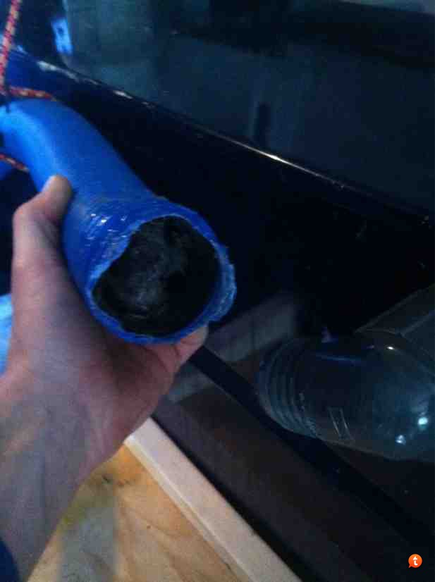

Problem;
System went from high velocity free sukin to under load. Water pouring out wand head when disconnected.
Source
Hairball
Solution:
Removed it.
Maintenance!

Bobby Pin stood straight up in the hose causin the hairball to form, glad it was there and not in the midddle of a fity footer : )
Actually never made it to the elbow
