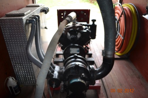

Steam Master Terminator 65 H.P air cooled wisconsin gas engine has a 68 MD Blower 3000 psi pump with electric cluth a 350,000 btu propane water heater and a 110 gal alum diamond plate wate tank with 3 vac hook ups comes with 250 foot vac hose reel 2 sol reels 150 feet of vac and sol lines 1 carpet wand 1 stair tool 1 furniture tool unit has 300 hours on it call dave 815-304-921

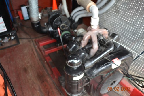

Looks like 3 to the tank. Also looks like one of Johns units. Instead of the correct diameter from the blower to the tank he uses the smaller hoses. Claims that's all that's necessary.
Fort Worth , Texas
Don't understand the logic on the three smaller 2 inch hoses as the unit does not need load as it is not producing heat for the heat exchanger.
I would redo the blower to waste tank connection and open it up.
Should be a good unit.

Pretty sure because it's easier.
