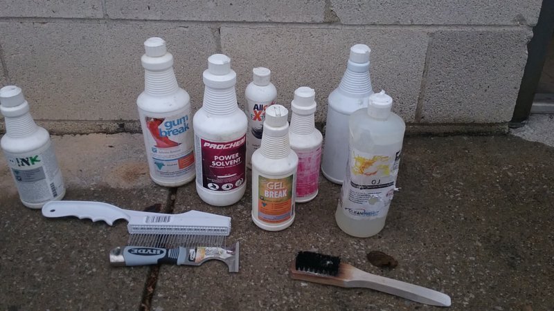

Had another one the other day, have, and used all of these. The one with no label is a quart of Hel Gel. None really performed as billed.
Of course I will still be getting some of John's stuff to try.
Vacant re-hab home. Dark brown tufted olefin, and in two rooms tufted poly.
All in good shape , for the setting. Cleaning was easy, but the paint and gum!!!!

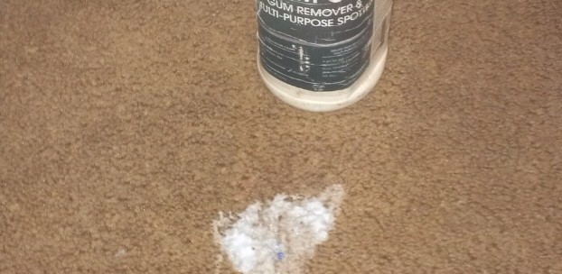

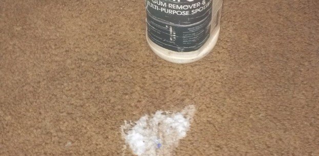

forgot I had this from way back. Another failed product on gum. Took the pic after a lot of poking , scraping at a piece of gum , with all that product on it. (Groom's). My interlink swore it was the same as BP's at the time. Had it in the BP spot on the shelf.
Have both of CTI's as well.
what the heck are they making gum out of anyway.??LOL! You can have a big wad in your mouth for hours and hours, chewing- mashing along with all those pre-digestive juices (ENZYMES!!!!!) Swallow it , and find it later on if you care to look!:yawn::yawn:
I keep thinking I will bury some , in a marked place and see if it breaks down in the soil.
I think this is the real environmental crisis we are facing.
All this gum eveywhere!!!
