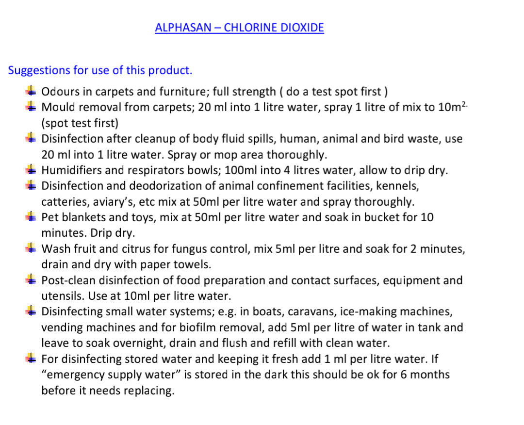

this is the instruction sheet I got from company that supplies 1-10% liquid, but Its the same instruction sheet regardless the percentage??
They said they normally supply 1% and leave the rest up to the experience of the operator
As its a true gas I was originally after gas vs using ozone but they only supply liquid
