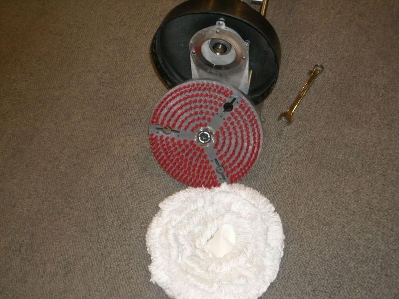

I'm going with a 175 from cleanfreak. I'm gonna get the carpet shampoo brush and a hard surface brush for tile but my only question (I'm sure I'll pay for this) is , do I wand the pad driver or the bristle pad driver for bonnet cleaning. This is a new process for me. I'm not sure about bonnet cleaning/encapsulation. Ive seen it done and get the gist, spray, bonnet and vacuum. Not sure I'll ever use the red scrub pads. I would love to offer an array of services.

Get the bristle pad driver as opposed to the black ones with the spikes. You will use this driver with all bonnets and pads. You can get red\white scrub pads at HD. Some guys prefer them to the brushes, especially on commercial, but decide for yourself. A lot of different style bonnets you can play with......microfiber, cotton, scrubbie strips.
Be sure the shower solution feed tank also.

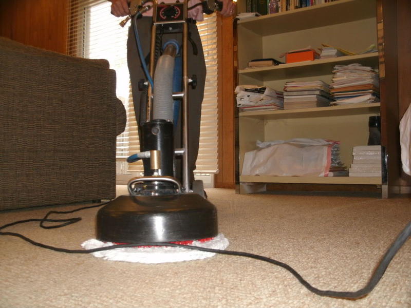

But you can encap with a 360i Sox, probably find bonnets for it awell. You don't have to run vac and solution too it bud. Swap heads, hook up your hoses and your cleaning tile and grout.
It has a speed control knob homie!
Down side is head size on commercial work.

Bonnets run easy on a 360i. Very versatile tool.
