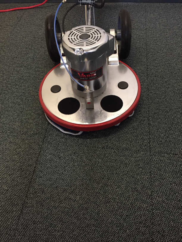

The OP can be a little more aggressive on carpet tiles. We try not to use OP on the tiles.
We have actually cleaned a whole lot of carpet tiles with the Vario machine and we've had no problems. Here's a picture of the Vario on some fairly haggard old carpet tiles. No detrimental effects whatsoever.
Do you think its the weight difference? We make sure there is plenty of lubrication but its still has a tendency to fuzz edges.

I don't know. We've been running the Vario on quite a lot of carpet tile, newer stuff, and some older stuff too. Running the Microbeast bonnets. Running the machine with and without the optional weights. Nothing has shown any fray or damage.
