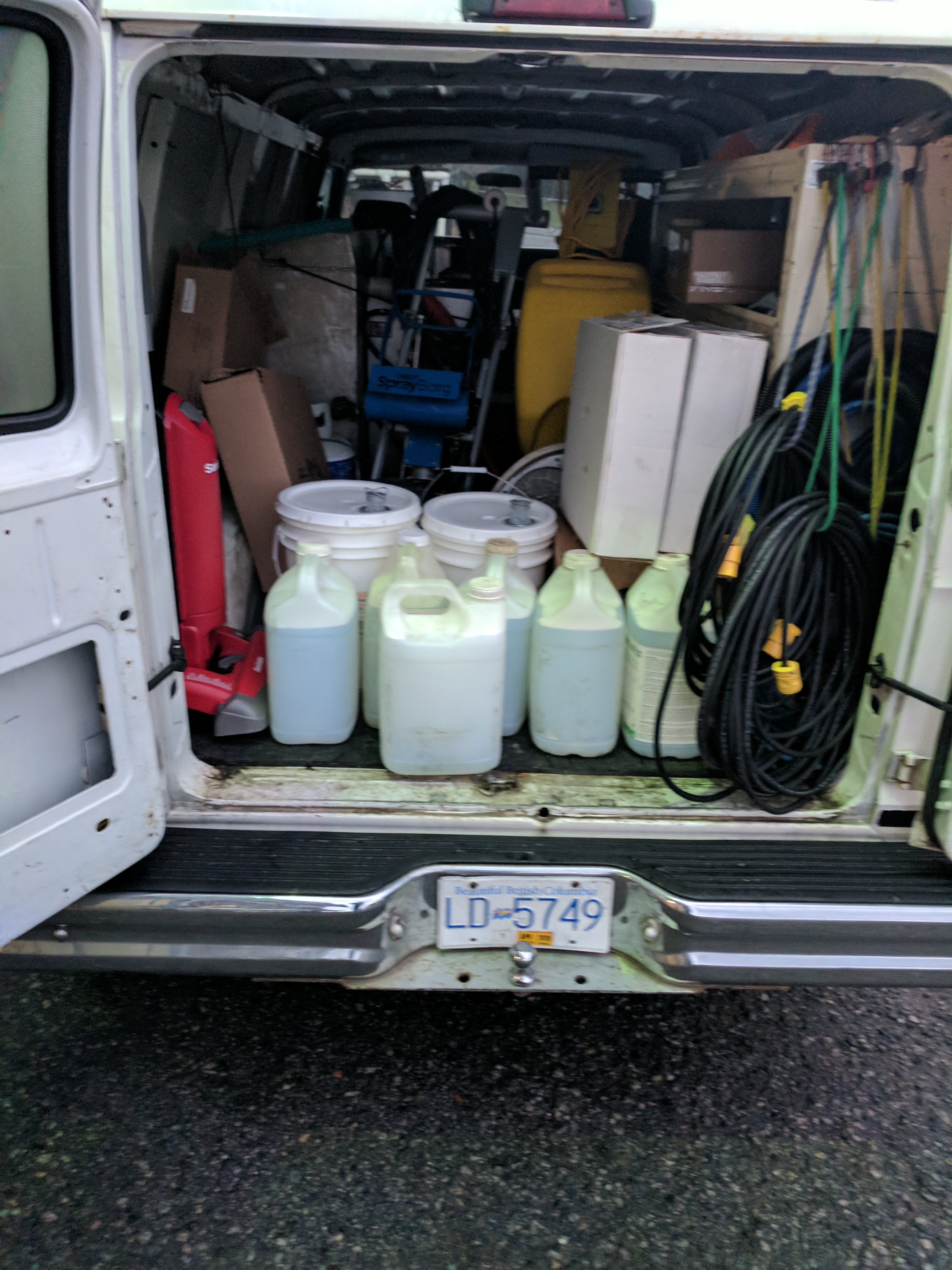

That's what I said to my interlink supplier as I picked up their last case of bridgepoints o2. Miracle of all miracles, they actually had a case of beige Cimex pads. So now I'm fully loaded. My good helper said he can work tomorrow but not on Sunday. Probably going to be a long tomorrow. I'll be at the shop at 7 am mixing up enough solution to get a head start. They have a good janitors sink nearby so we can mix on site easily as well. Going to be fun.

Good advice Shorty, I am just bring enough to get started. Am going to use the spray Borg as well on the less soiled areas. I have 6-2 1/2 gallon jugs for the sprayborg. Plan is as soon as we get there, get the helper vacuuming. Get the Cimex going, bring in the spray Borg and get r done. Going to snow on Sunday so will be nice to get done in one day. The food court is right outside the store.

Loaded for bear. Just waiting waiting for the helper now.

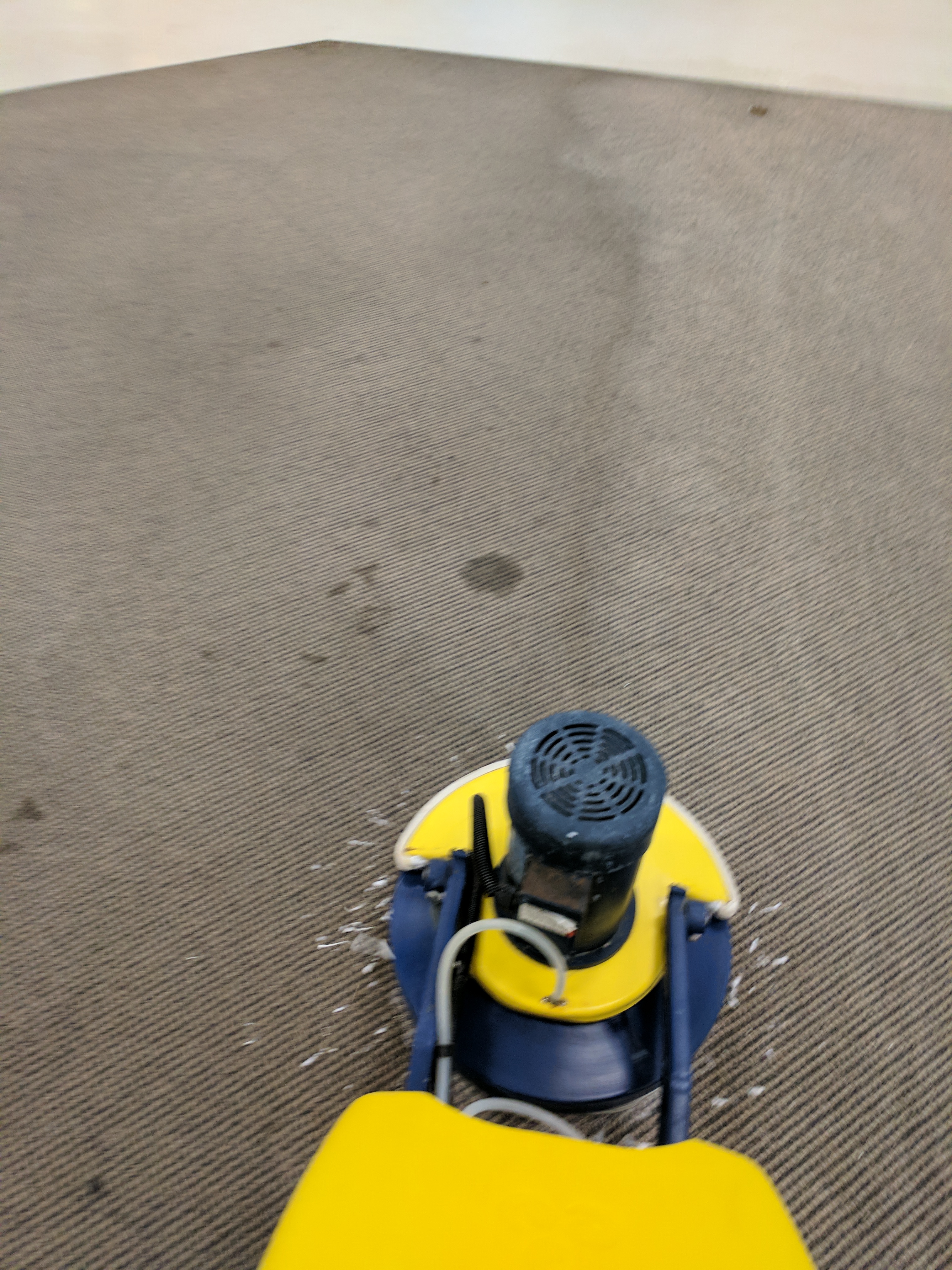

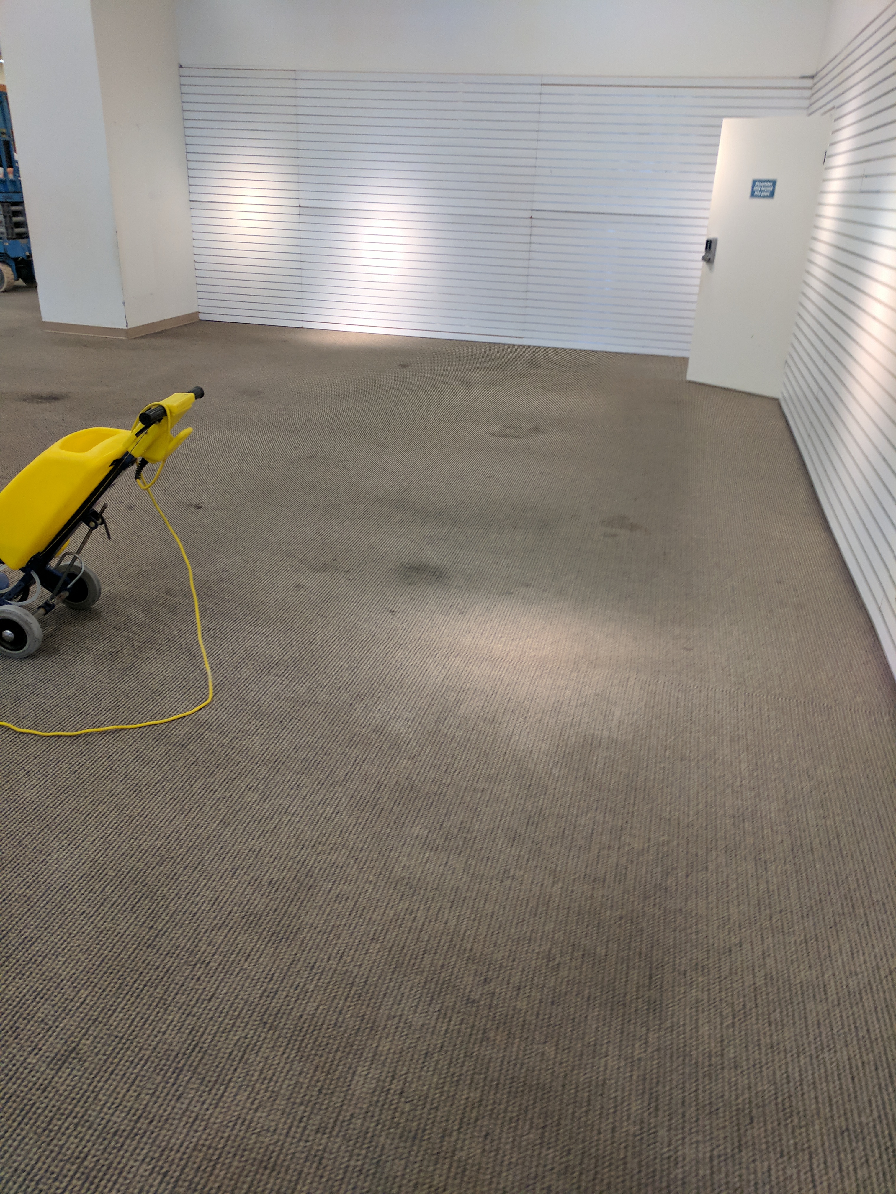

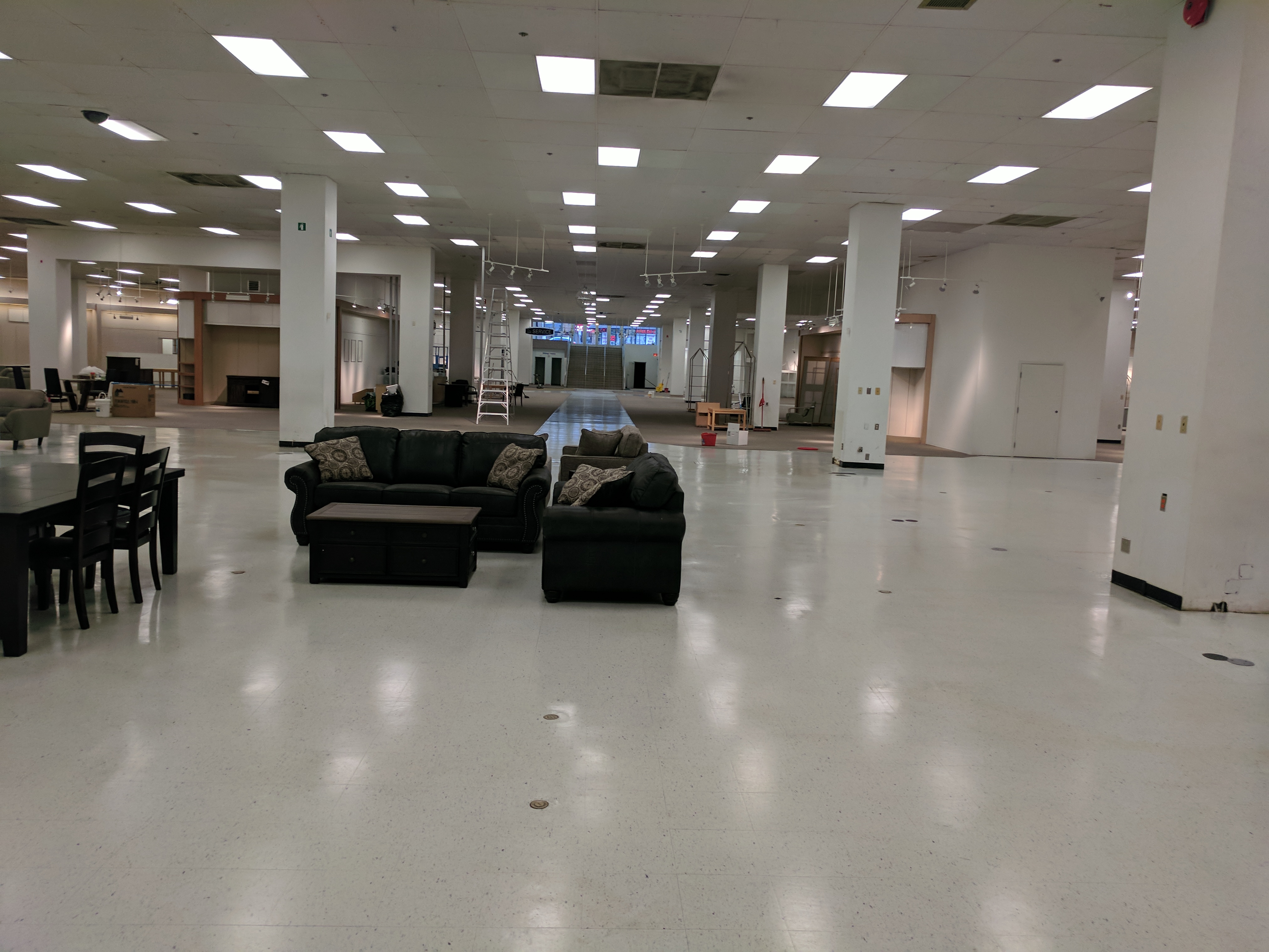

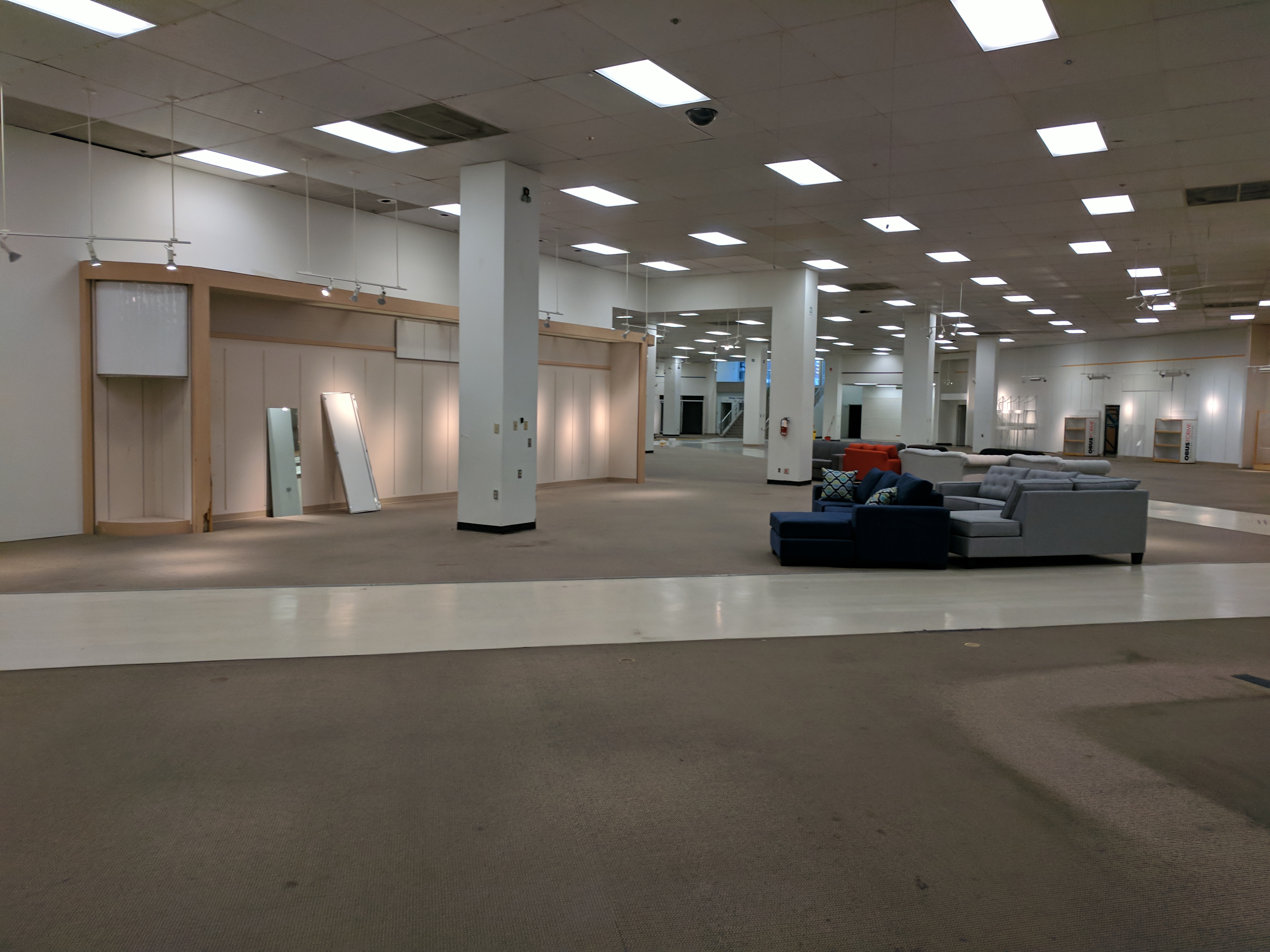

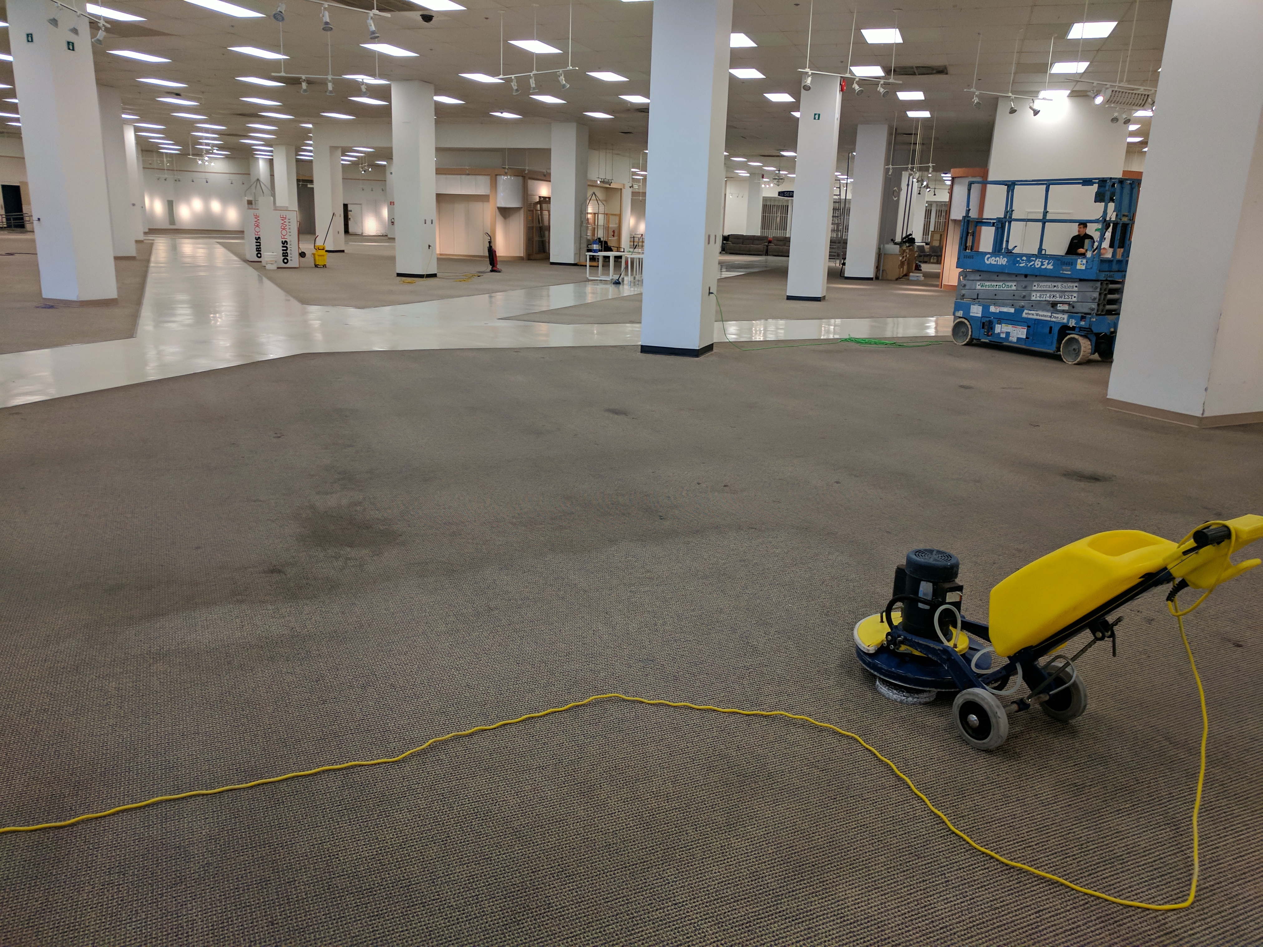

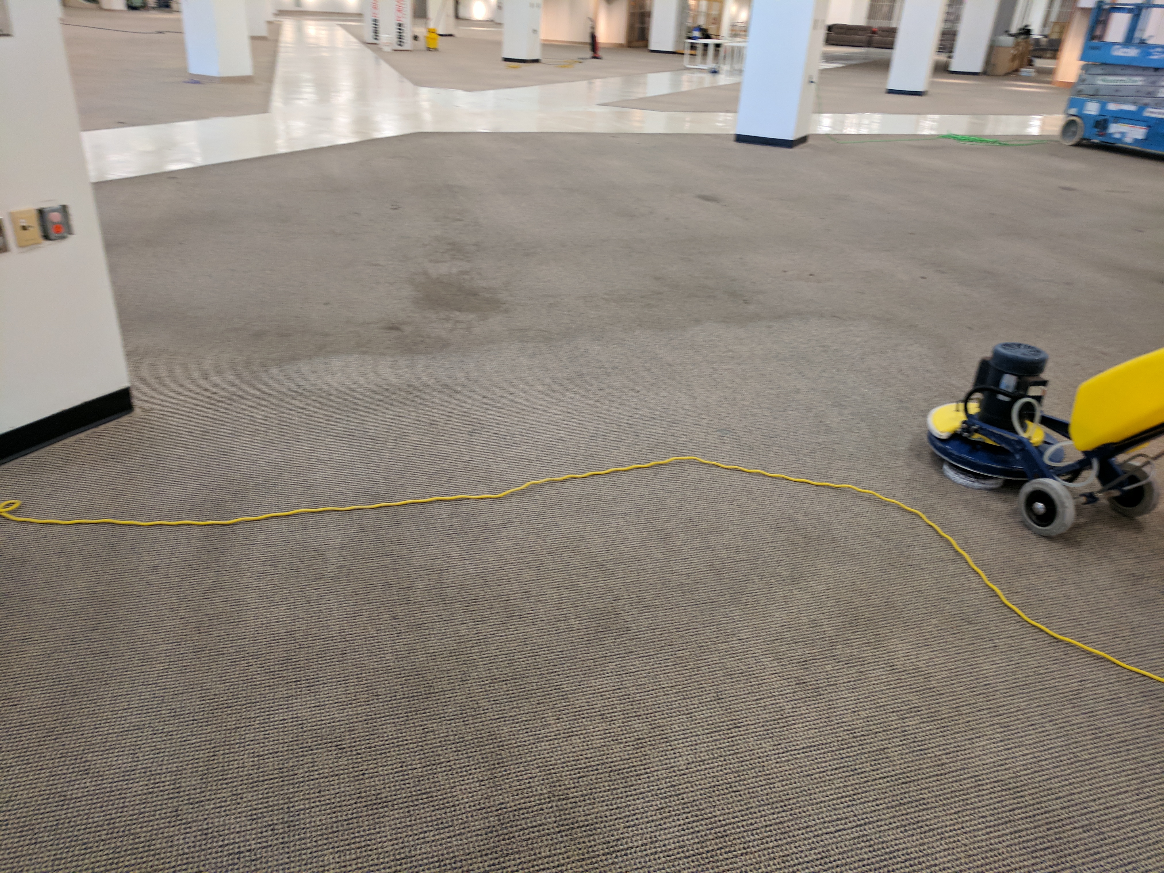

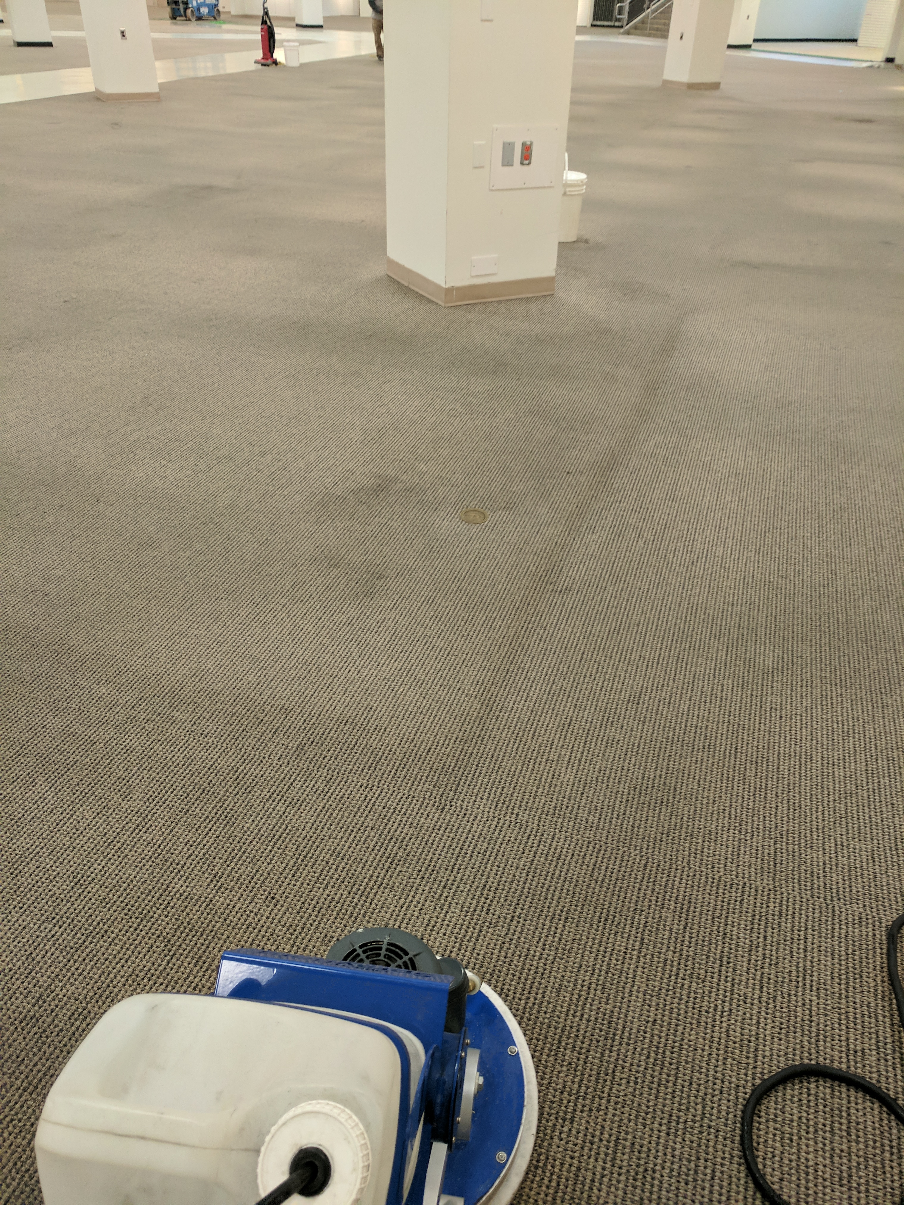

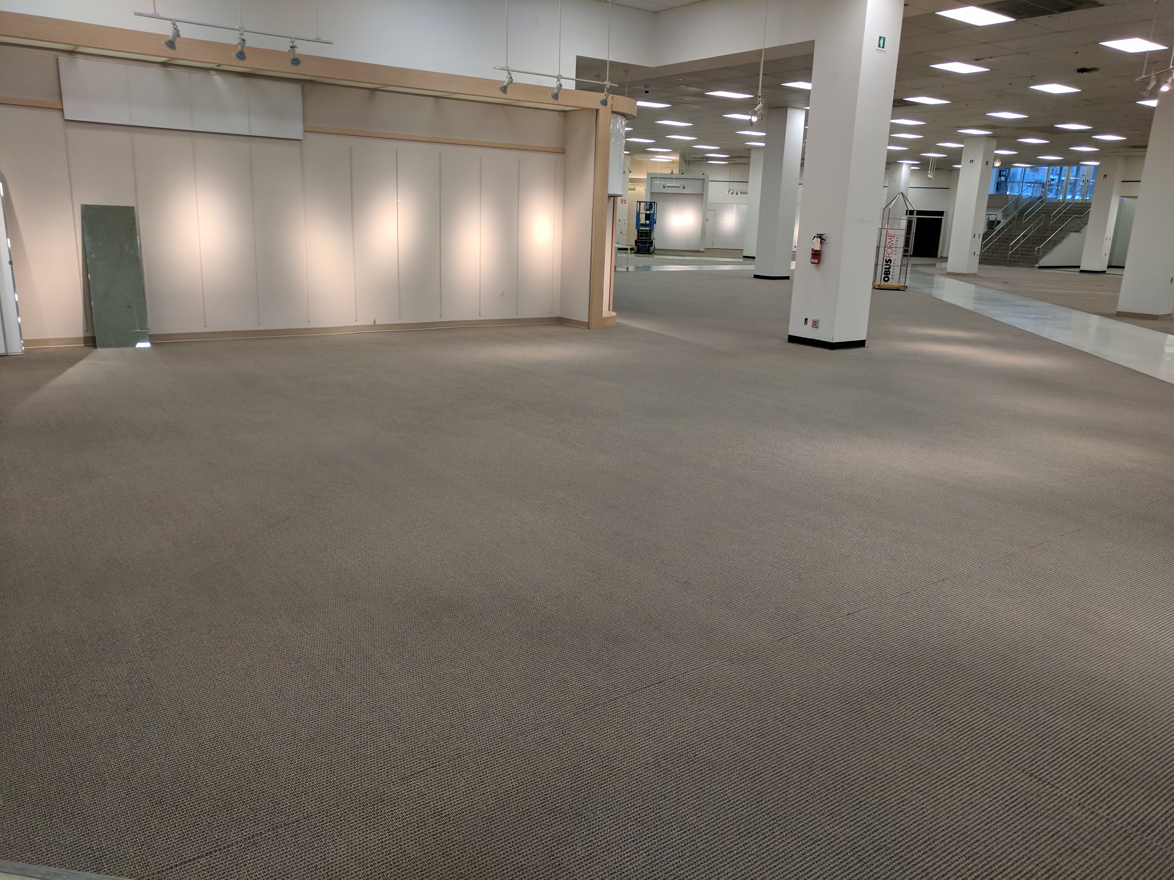

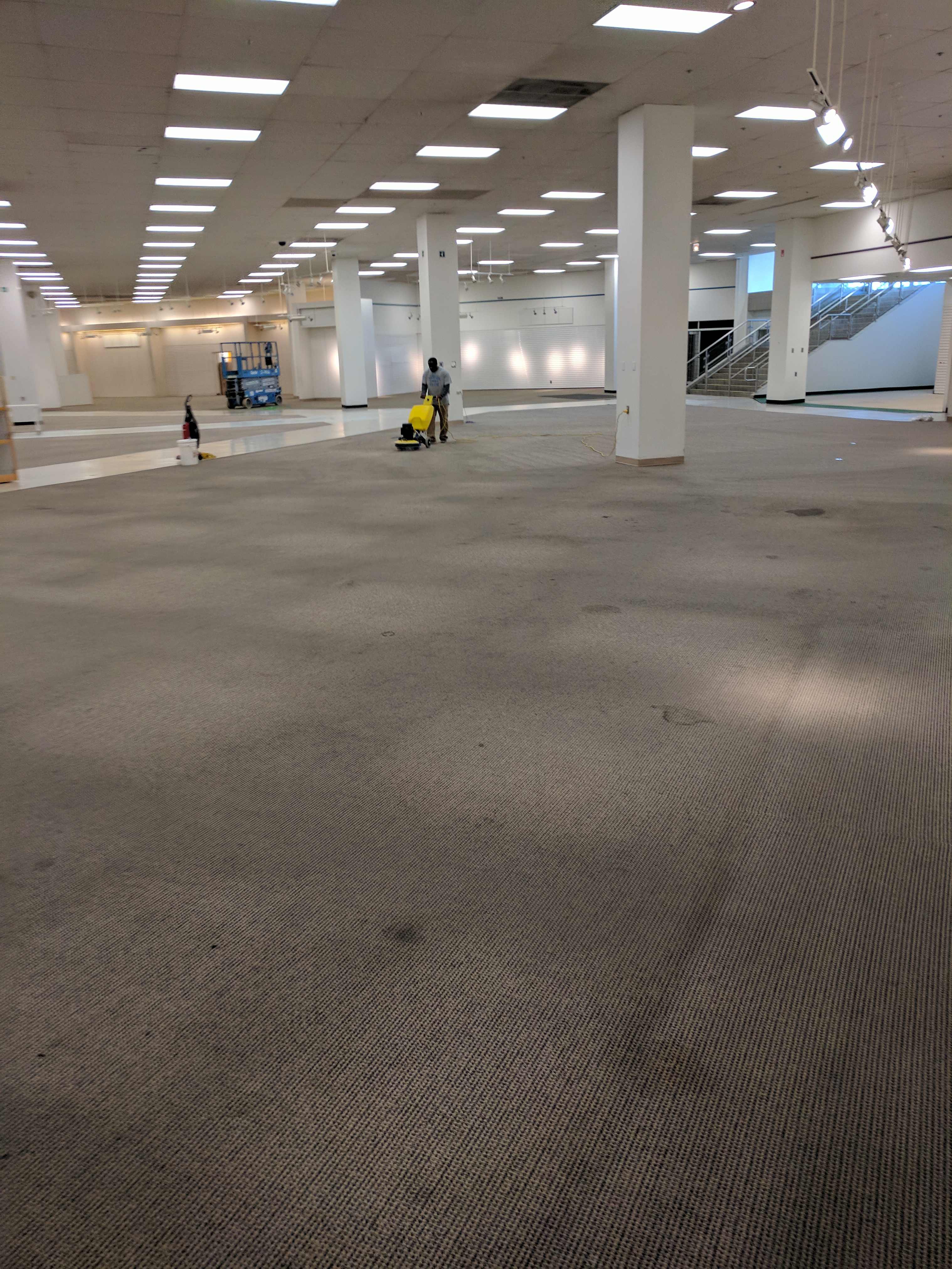

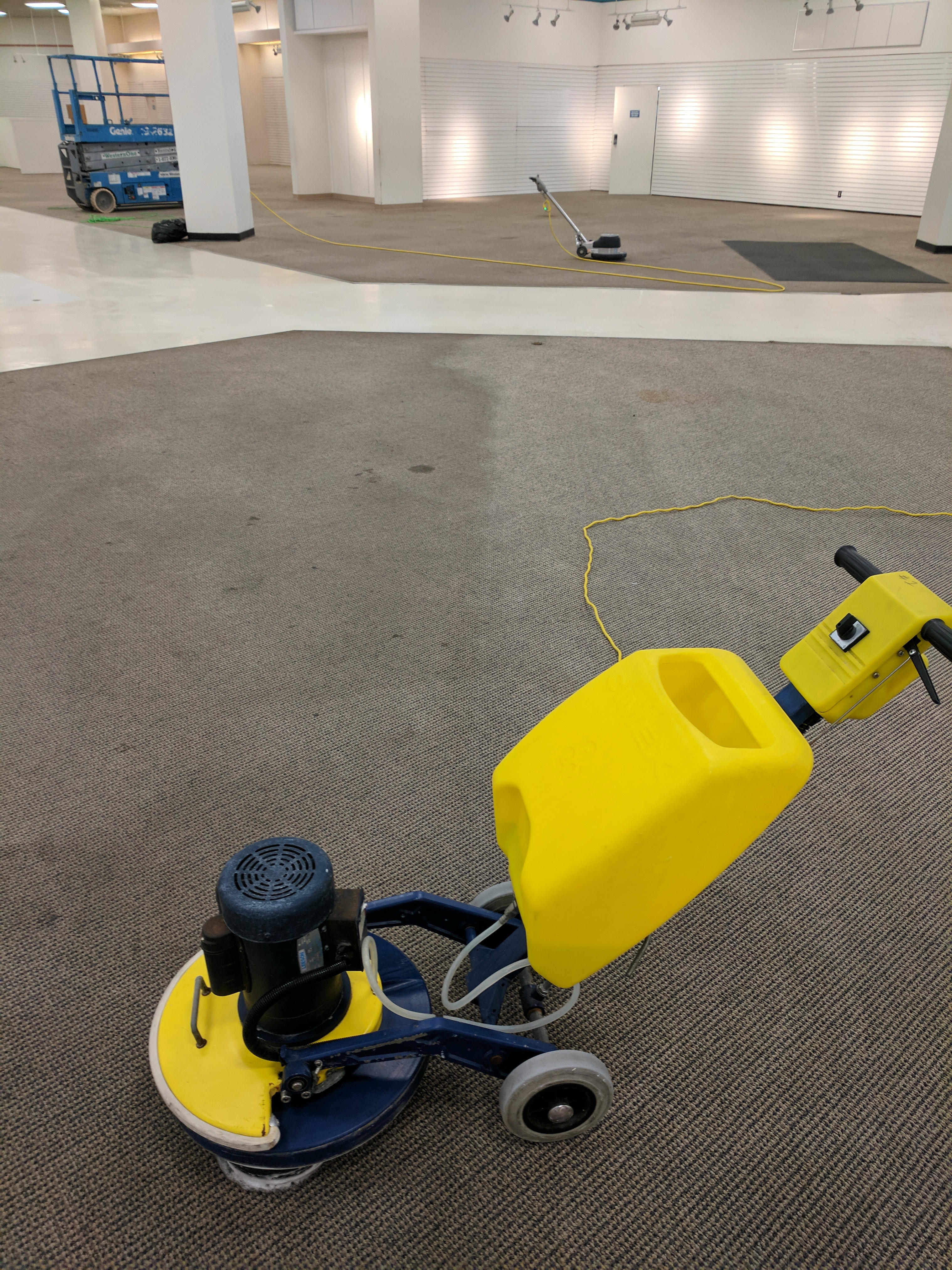

Well, done for today. They added about an extra 10, 000 sqft that they were going to replace bit decided to have cleaned as well. Probably cleaned about 18,000 sqft today. Slow going because of the heavy soiling. Also spent a lot of time vacuuming. Finally got some of their staff doing that. Used up 6 gallons of concentrate at about 10-1 dilution. 60 Gallons if mixed solution. So much different from hwe. You have to trust that your detergent is doing what it is supposed to do. Doesn't always look all that great right away but changes as it dries. Overall, most is looking good. Will touch up some of the worst areas as we go. My helper was great but tomorrow I have the legendary Willy P working with me. Should be a blast. I am finding the sprayborg is easier to operate than the Cimex and gets as good results. I would consider getting a vibe because of the built in 5 gallon tank. Here are a few pics of the store and the overall conditions. Maybe I'll shoot some video of Willy tomorrow.

Looking good.
Before you ditch the Cimex, install Big Wheels on it.
It makes maneuverability so much easier you won't believe the difference.
DON'T leave the Cimex with the pads on the carpet like that, they will leave a mark from the solution awkward to get out.
Lift the head & place a towel underneath to catch the drips.

I don't think I would ditch the Cimex but the big wheels would be great. The Cimex with aggressive pads really gets in there. I can really see the attraction of the vibe with the large tank. I have 6 2 1/2 gallon jugs that I space out for the sprayborg and 2 5 gallon jugs for the Cimex. You can really get a lot done before you have to refill them. A 3rd person would be invaluable on a job this size.

Thanks Rick I will when I get through this job. Right now I'm using the grey pads. My technique is what Richard suggested. I do a wet pass then turn around and do a dry pass over the same area. I am keeping my passes short, generally 25-30 feet. I alternate my direction every so often to avoid streaks and odd patterns. Once I collect some payments, I would like to place an order for some releasit and more pads. Maybe a big wheel kit. This job I am doing could be done with a large truck mount but you would need at least 450 feet of hose to reach. I don't think a truck would do any better and actually would probably have more wicking issues due to the nature of the stains. The beauty of the o2 encap is that you will pass over a coffee or beverage stain with not much change. Look at it an hour later and it's gone. I love my truck mount for what it does residentially but encap done right is the cats meow for cgd.
If I run a fifty foot cable, I will usually do the end first for about four trips wide.
I then leave the Big Yella inside the area I have done & take the cable back to a power point that will still give me some cable left over.
I then start at the clean end and go until I nearly run out of cable & come back doing a dry pass.
The carpet will not dry off that much and you are covering more area in the one pass, hence get through those big jobs quicker.
