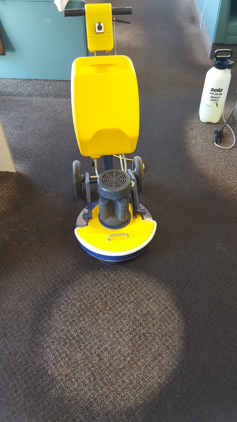

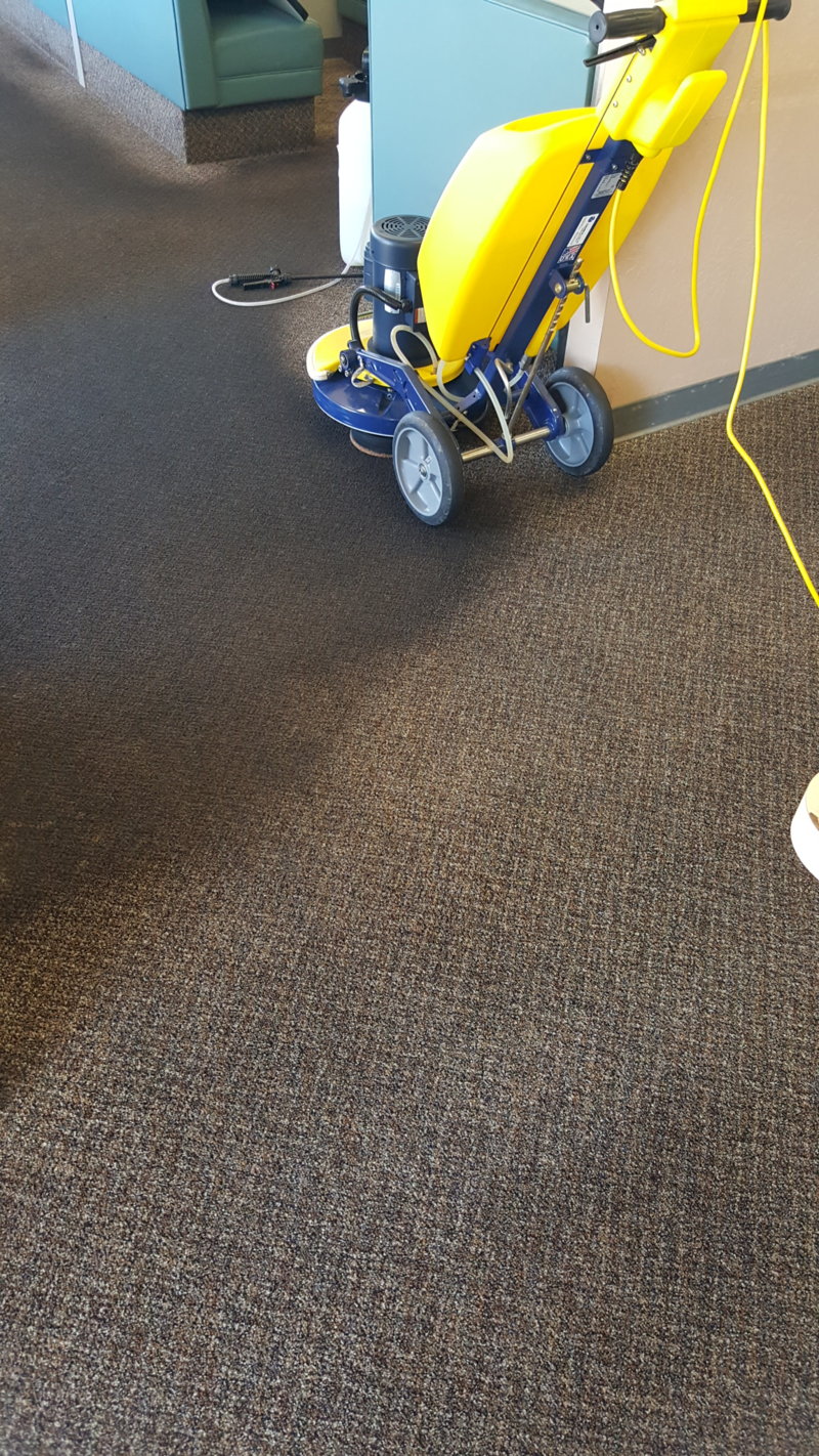

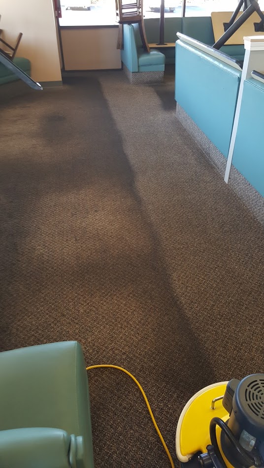

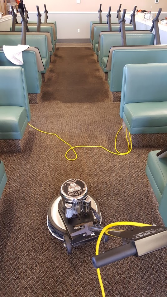

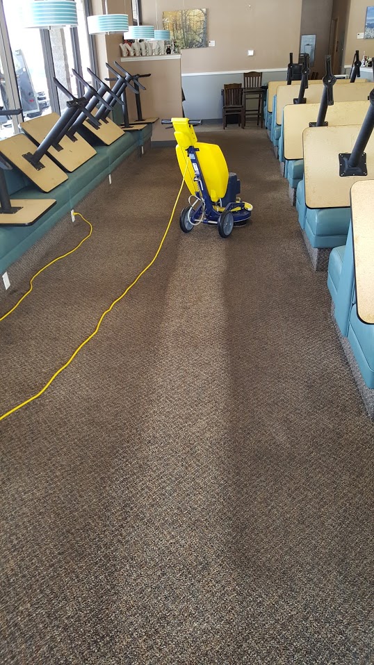

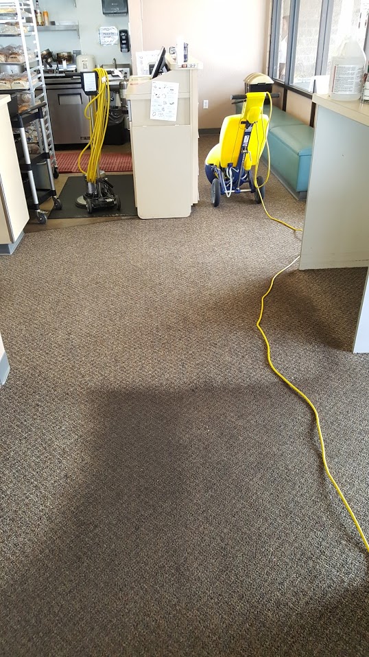

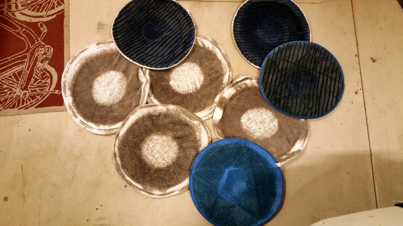

Cimexed then padded? Cleans better and/or faster than HWE? What juice?
117,324
Equal longevity, a bit quicker. No tm running.
Awesome Encap from encapstore
Ill rinse/hwe next time
9,757
8 pads over how many SF?
Looks good Mikey.... Did you use the cotton before the microfiber pads?

Looks great! What was your mix rate on the encap? Looks like you sprayed first but did you gravity feed encap also?

Very impressive.
Which do you prefer, Cimex or Edic Rotary??
Where did all the soil go?? :icon_twisted: :marty: :stir:

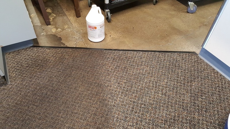

That looks like a tough account to not HWE, great job! How big of a splash of ammonia per gallon? Did you use the solution tank feed on cimex or pre spray with sprayer? This is how I have been doing VLM cleaning using my CRB and then padding with cotton. I don't have a Cimex yet.
117,324
We lightly pre sprayed 100 feet ahead of the Cimex with an 8 ounce Encap/ 4 ounce Ammonia per gallon mix. 1 gallon and a half did the whole place.
We ran the 4 ounce encap/4 ounce Ammonia through the Cimex.
The brown Planetary pads are a must.
These are photos from the last time I Cimex'd it.

That's a sizable "splash" of ammonia. More like half and half.
What was the encap you used? (If you can say it publicly)
