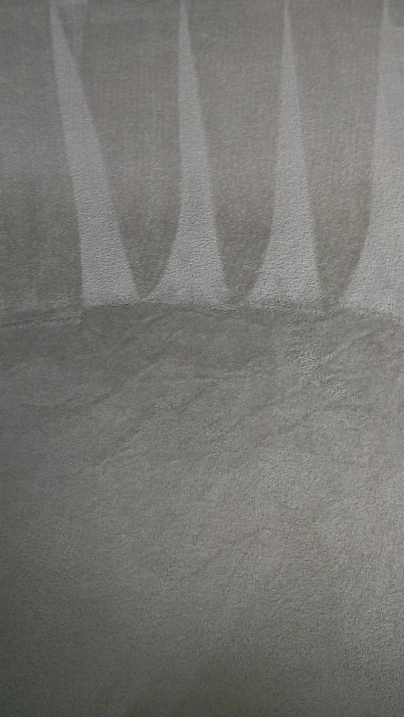

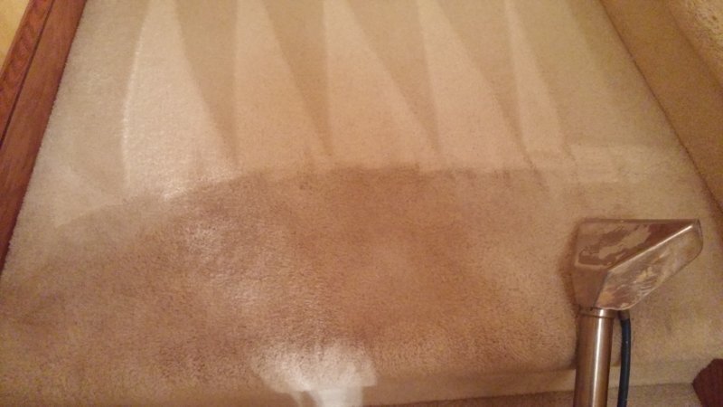

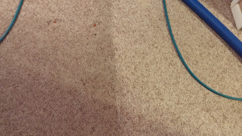

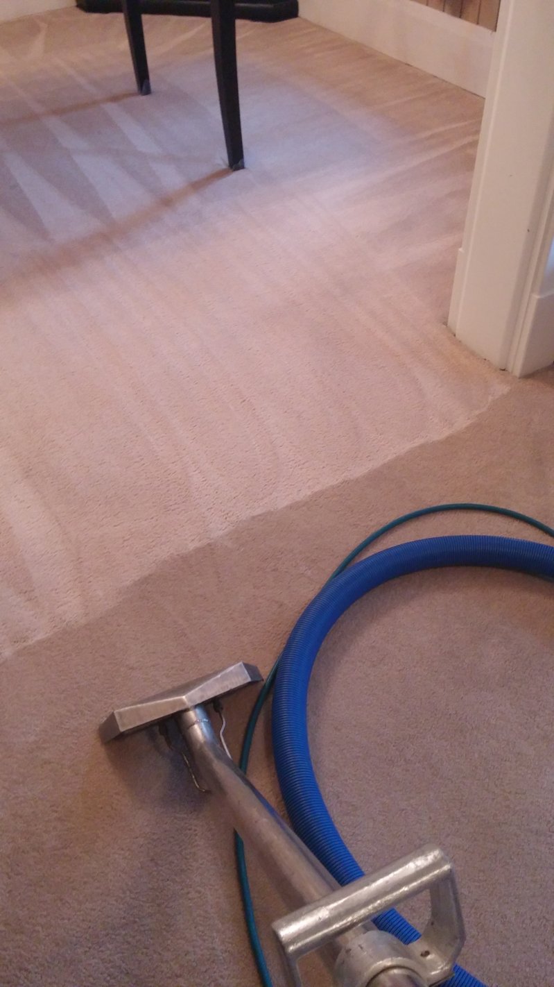

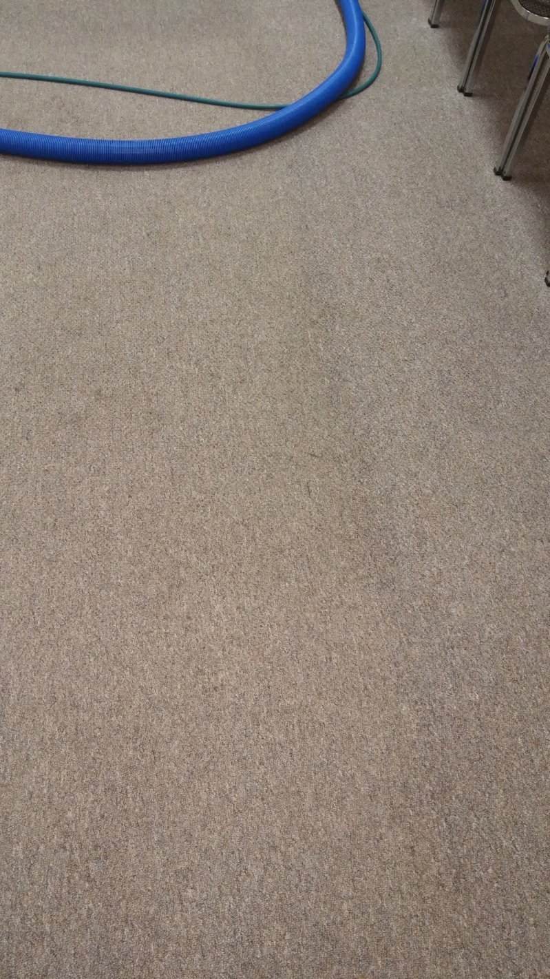

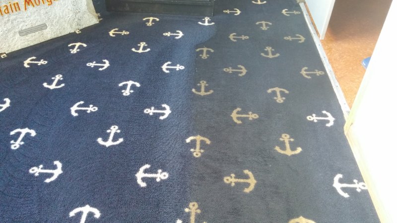

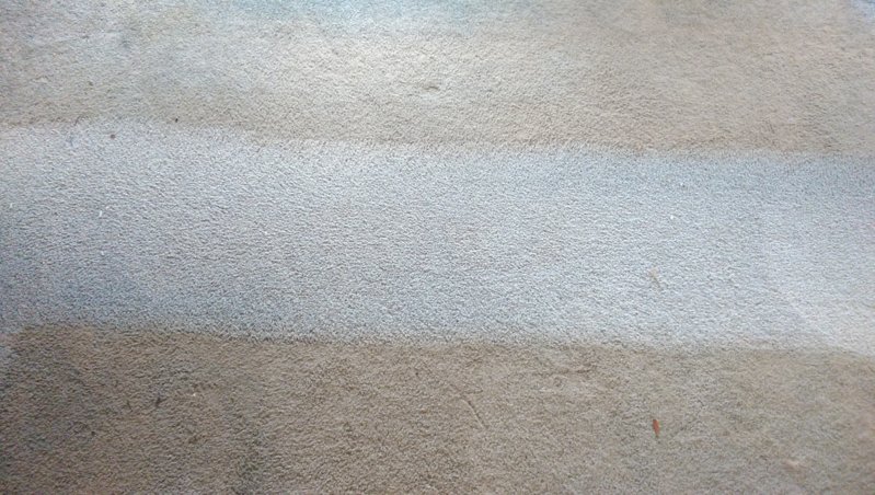

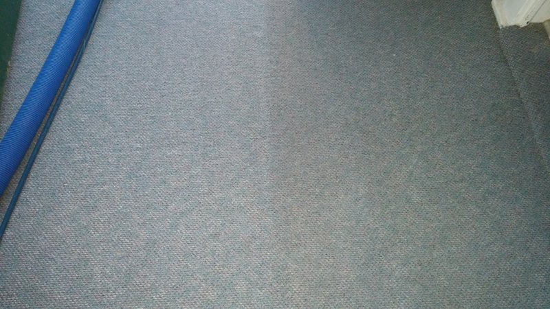

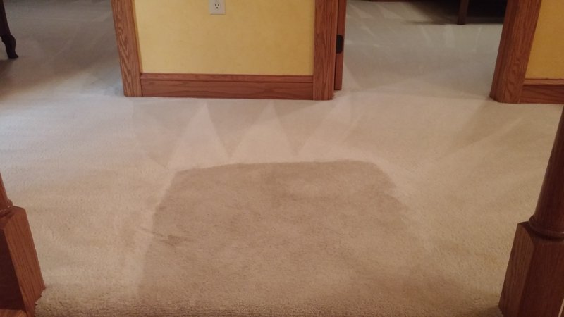

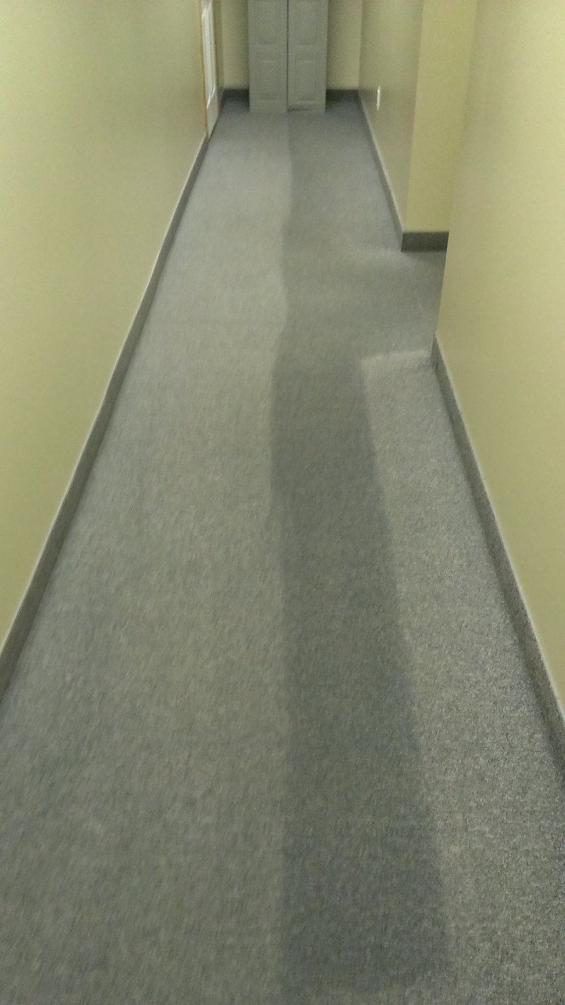

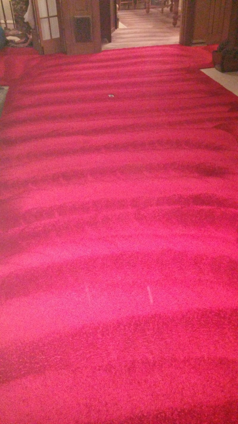

Jim pemberton got me turned onto clean free about a year and a half ago and it still amazes me. I use it as the prespray and the rinse. Picture right below text was last night. 17 year old carpet, hasnt been cleaned in 6 years, pets, kids, and the customer was flipping out because "it looks like new".

its safe for stain resistant carpet, and I find that because its an oxidizing cleaner that it brightens a lot of the dingy traffic lanes up a lot better than a normal alkaline cleaner does. I have a lot of customers who like the No scent factor, and the fact that it has no harsh solvents, and can be used on most upholstery.

Im serious about this stuff (clean free) it can be used as a prespray and a rinse, Its cheaper then dry slurry, its safe for 5th generation carpet, its alkaline, it reactivates residue from previous cleanings (customers diy machine) without adding even more soap, its safer for the operator, and it brightens the carpet.

its for light to medium soil levels. like I posted in my pictures.
