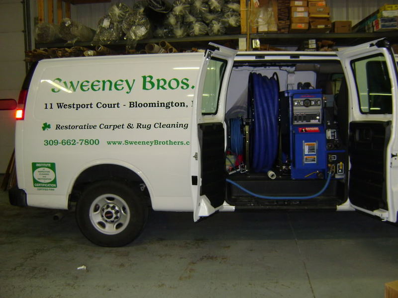

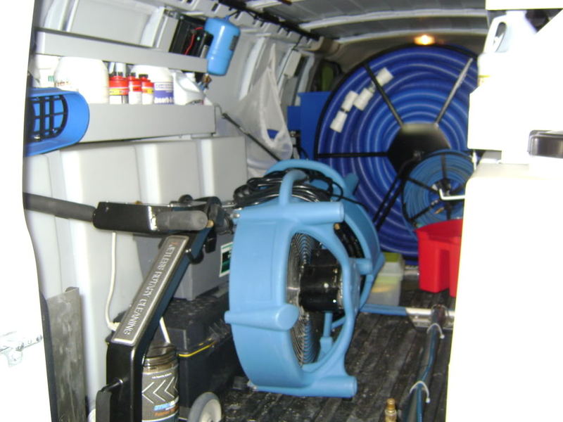

Here are a few

How many gallons does that fresh tank hold.
I love that lay out.

nice truck. I like the dual tanks as well, something I envisioned on the new mytee tanks.
i will say you are killing me with the plastic waste tank fittings, and plastic hose barbs though....lol

Well Greenie.. I'm doing pretty darn well to get my dad to let me outfit the wand. He now understands the benefit of high flow. next will be the hoses and of course the tank fitting.. Its hard when the guy in charge of the money doesn't understand high flow and cfm or cleaning all that well. and its especeilly hard to show Improvement when I get dry by the time I leave results.. (dang airpaths) . I'm doing my best to edumacate him. Slowly we'll get there. My "plan" is to replace or add only 2.5 inch hose from here on out. I think in the future if we stick with a van. I might be looking into dual 100's with an apo on the machine. Love high Flow but drinks 120 gallons in about 1500-1800 sqft. and its not fun to hook up to water in the winter time at 5 degrees... or at all for that matter. I think I have him convinced about getting a greenhorn though.. Last commercial job he came out to help me. He wanted to wand. So I presprayed and scrubbed. He now understands how another 3 inches of wand would make a big difference.
Thanks for all the complements.

I know you know...but don't want a newbie misreading my post...just yankin' the chain on teh plastic stuff, Rome was not built in a day, one stone at a time.
Do you have a 2" Y?
I'd probably leave all the rest for now..and get one of those, and stay with the 2" hose.
On the 11" 4 jet wand, with allowing a full inch of overlap, you get a solid 10" clean pass, with a 14" 5 jet you get a solid 13" pass, with a 5" differential you would in "theory" see a 30% faster cleaning rate. But i wouldn't run it head to head without the 2" Y, as it will give the extra power to fully utilize the 14" head, and let that 4007 blower do what it was made to do.

I don't think you'll be able to get away with 200 gallons of water, 1600 lbs plus the unit itself. You'll be bottoming out over any bump in the road.

Nice looking unit.
How's the heat on the Hydromaster PTO?
That is a 2008 unit non salso. In the winter time we are making about 190 to 210 at the truck. In the spring summer fall, we make between 210 and 220. On really hot days last year.. She was pinging at 230 without the wand running. Who needs salsa on a 100 degree day..
