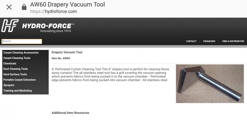

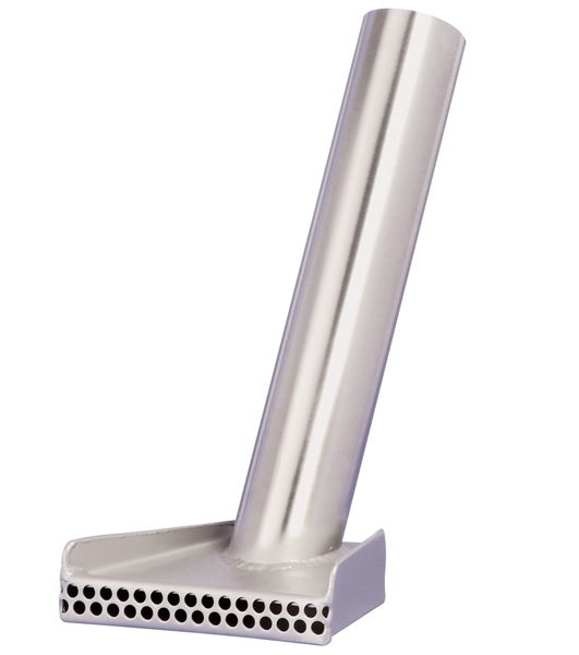

You need to invest in a perforated head drapery tool. All our fire crews have one in their vacuum attachment tote.

Very cool. I have some perforated bronze sheeting that would be perfect for that. Thanks, Richard.

Don't thank me, PMF makes then. Should be available from anyone that sells PMF.
Not for free, they aren't. I'll use the idea to fabricate an internal shield for the plastic vacuum brush head, which should give me the best tool possible for drapes.
