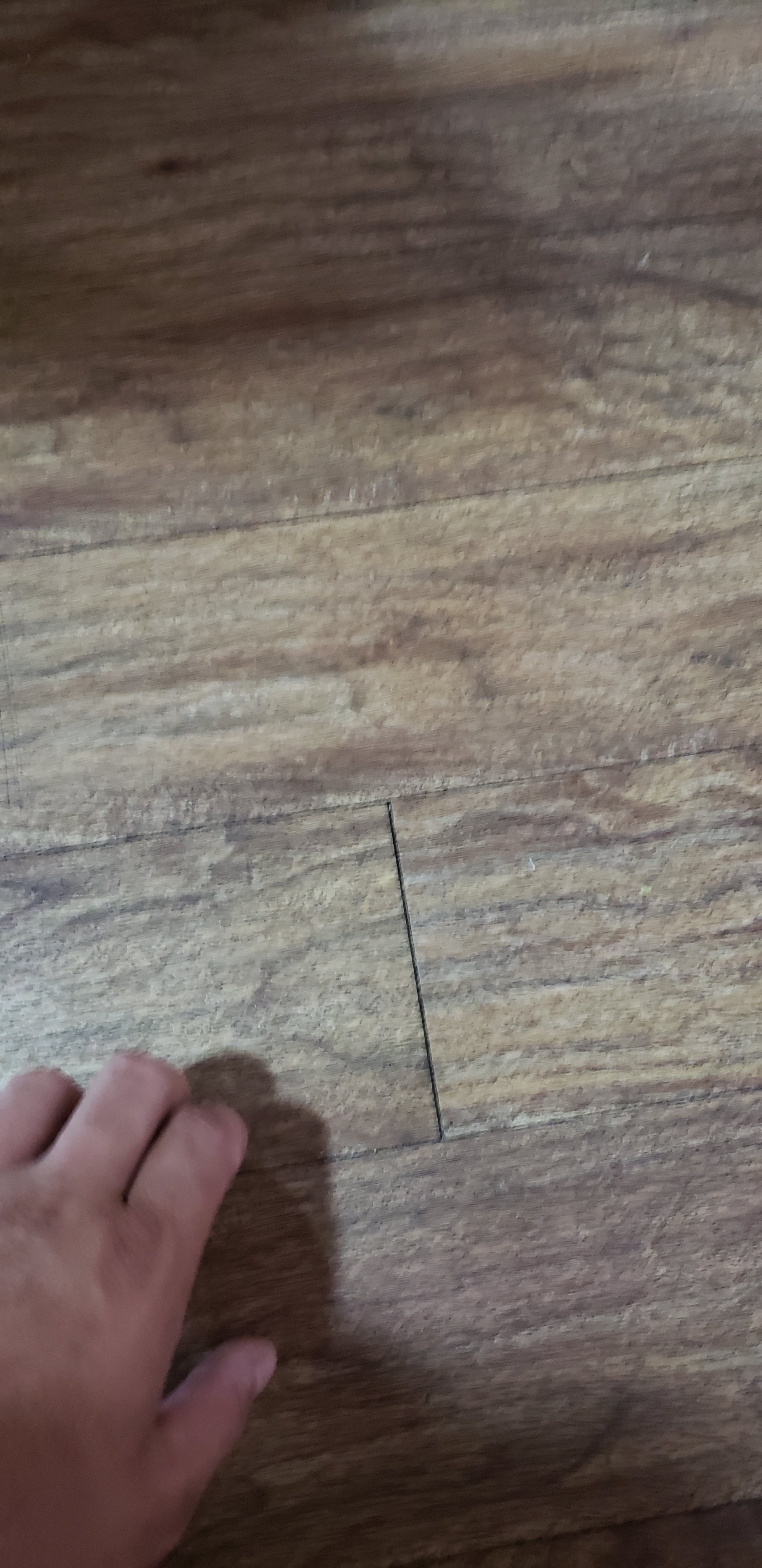

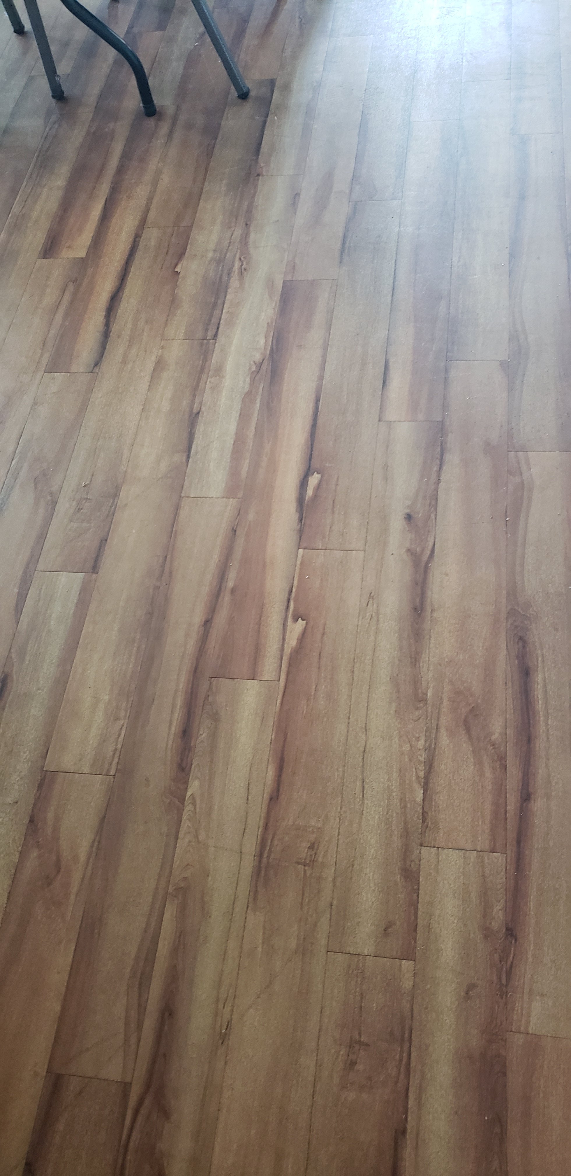

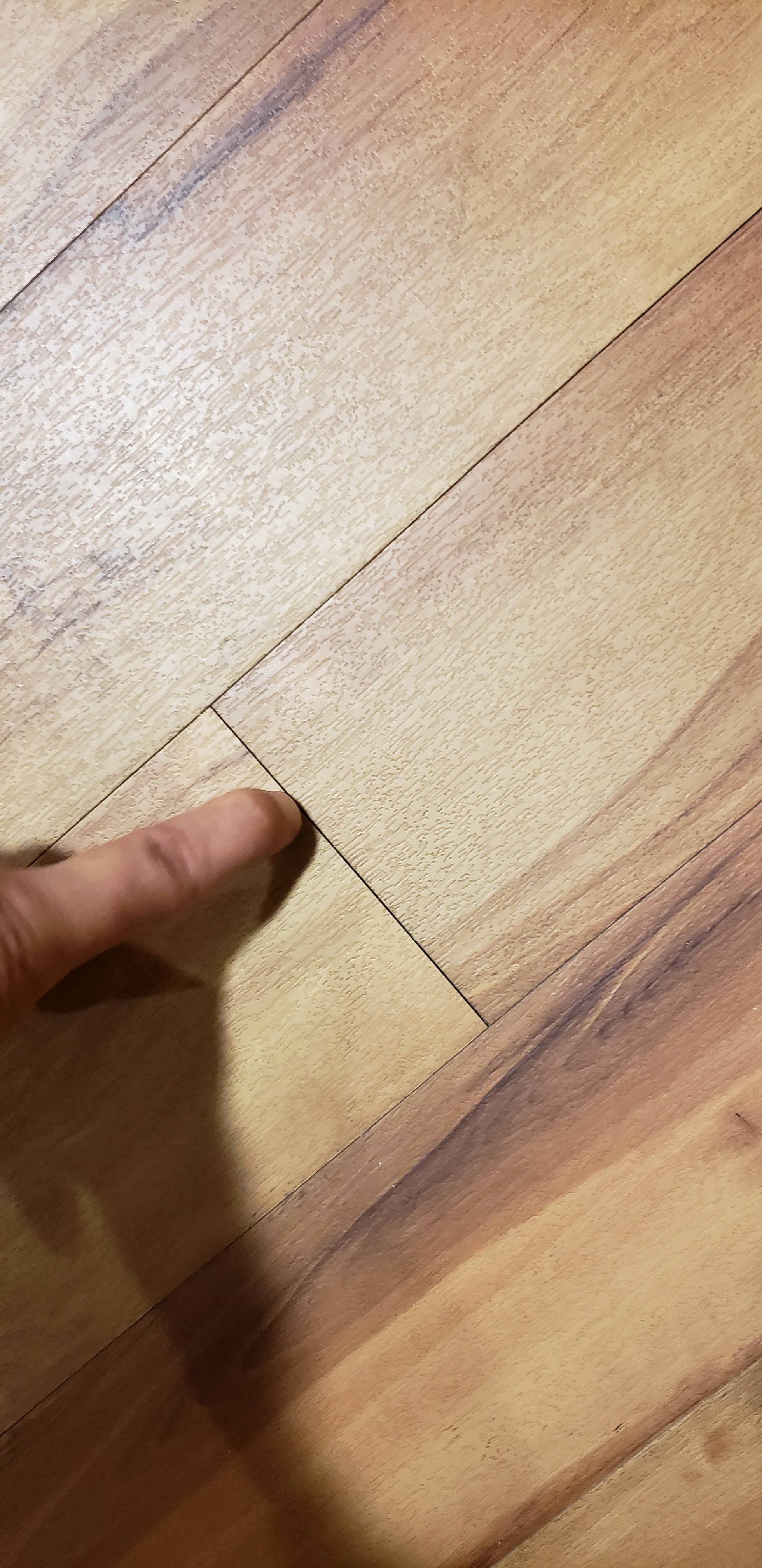

Got an oppurtinity to bid on floors for a church. Customer states that the floors are laminate or vinyl. They seem to be snap in planks and solid when i knock them. We mainly do floor stripping and waxing and we are a bit newer to this. My question is can i run this like a strip job and wet the.floor area by area and autoscrub with a red or blue pad and simply suck the water back up. Or how exactly do you clean these types of floors.

different manufacterers have different recommendations as to how to care for there product.
You can probably run a scrubber over it but I wouldn't wet down an area (scrub extract each pass) without knowing exactly the recommendations

Yes you can, but no need to put as much water as a strip. Just run your auto scrubber as normal, or do a pass or two without the vacuum like you would a scrub. My schools and churches have that and that’s what I do.

Any kind of chemical or would a neutral cleaner do the trick
Michael, they will have a few extra in the janitor’s closet. If it is the snap type, I’d consider using compound and a CRB.
13,372
Laminates can be damaged by excessive moisture and certain cleaning products. I wouldn't use a solvent base cleaner. The finish can peel or flake off and boards can swell.
Vinyl planks can trap moisture underneath but can handle solvents.
Either way don't over wet it and don't get to abrasive. They clean easily with a neutral cleaner usually.
