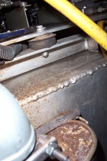

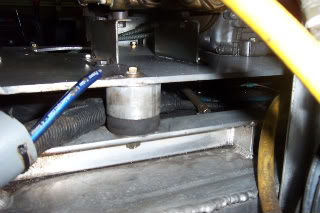

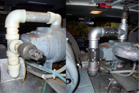

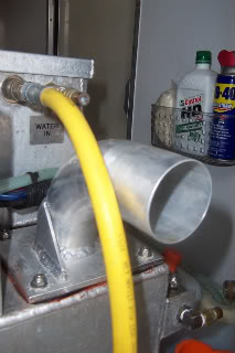

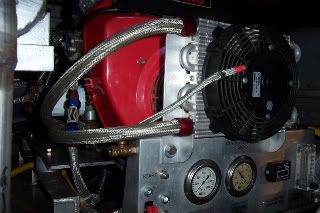

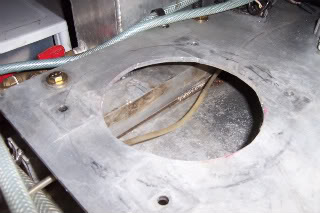

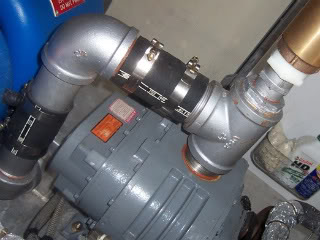

Help for the Cobb Job:
It's been a busy day and half the night, but here is a 2.5" upgrade from the 2" plastic fittings, before and after:
Cutting the blower mounting plate to allow for larger plumbing:
Old dampners, NEW dampners:
Oil coiler installed:
2.5 hook up installed over orig. 2"
and another shot of converted blower plumbing...still lots of bends, but 50% than before.
Disclaimer, this is NOT Lyon's Cobb job, it's Kevin Brenny's, and he did all of that work, but it does show how a whole lot of bang can be delivered for a few bucks and some sweat, now maybe Lyon can talk Chad into some steak dinners and get a hand with his Cobb conversion?

I'm thinking turning the blower sideways and getting a new size belt then plumbing it might be easier.
Greenie
6,820
What would be your angle for the blower filter and access?
Personally, I think you have the right idea, just bolt a 2.5 flanged elbow to the "lid" of the filterbox pointed towards the blower, and use another threaded 2.5 elbow from blower and a rubber fernco to join em, and skip the blower filter, deal with filtration out front, that would make for some easy blower exhaust plumbing for sure, and a decent muffler, then that would allow the HX to only have engine exhaust, it would surely get hotter, but then you need to add a heat management system, not too bad if you ask me, simple. I would wrap that HX as well.

Wouldn't I have to ditch my heat exchanger that I paid $1,000 for, It has 2" opening and it needs to be 2.5" if everything else is 2.5". Larry Cobb might know if I can make the opening 2.5" without ruining the heat exchanger, but I doesn't look possible unless I cut the end of and weld a larger opening. The opening from the blower and the motor will be the tricky part to cut wider.
