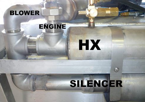

Cobb TM owners:
how does the machine cool the hx'er if you want to do upholstery or wool?
curious of that too.
what happens if you set the wand down for extended periods while tabing/blocking or other non-flow times??
If no dumping into the waste tank, does it dump excessive hot water on the ground??

I rebuild TM's the Cobb's design are missing a Heat exchanger diverter, temperature valve to protect the water pump from heat,temperarure valve control , industrial blower silencer and a better blower plumbing
Larry Cobb
5,795
Larry Cobb
We build better engineered Truckmounts . . .
Diverters allow heat exchangers to cool off,
when exhaust is diverted into silencers . . .
Our General water pumps pump cold water, and have Teflon plunger seals to allow plenty of bypass time, without water flow . . .
Temperature valves just waste Heat Exchanger BTU's, by dumping water into recovery tanks . . .
The "industrial blower silencers" are made of steel, and start rusting and restricting the blower exhaust within a few months . . .
Dynachem was the pioneer in using 100%-stainless silencers to resist corrosion.
Dynachem Blower plumbing is 2.375" minimum for only about 20" of flow length.
(How many 50' lengths of 2" I.D. vac hose is used on typical cleaning jobs?))
All other TM's have more restrictive silencers (before rusting starts),
and more restrictive recovery tank flow characteristics (filter and baffles),
than the Dynachem design.
Larry

Larry, you didn't answer my question..
what safety mechanism/devise is used to prevent a dangerous over heated water condition when no water is flowing thru wand or tools?
if none, I presume it can't be used for flood extraction?
(when a TM may be running for hours with no flow)
Also, if no safety/by-pass mechanism, isn't that a serious liability concern?
aren't you worried some retard will 'splode the damn thing??
Thanks

Larry, is there any kind of fail safe pressure relief valve in the system?
I'm assuming you saw Albert Lazo's totaled van some years ago??
Shane T
Nov 7, 2006
1,663
Shane Tiegs
I believe I saw a pressure relief valve on the heat exchanger in one the his pictures.
http://www.cobbcarpet.com/hx55.html
MattLimbach
Aug 10, 2012
18
Matt Limbach
I dont own one of larrys' machines, but from what I understand, the blower exhaust runs through the heat exchanger. This is what regulates the temperature.
The water cannot get any hotter than the blower exhaust, approx 240f.
So as long as the blower is turning the temp at the machine would never exceed 240ish.
No need for diverter,sensors,bypass, etc.
The reason it is able to maintain high temps while cleaning, etc, is that the exchanger is is quite large,holds large volume of water.
Like I said. I dont own one, but it sure does seem quite simple ,and probably safer than most heat exchange systems.
Most heat exchangers have more components that could fail and cause safety issues,explosions burns,blown hoses etc. Diverters ,sensors etc,can fail.
I think larry has come up with a very smart, efficient, and I believe safer than most, system.
Thanks
Larry;
With 2 QC's you can bypass the entire HX . . .
and water extract all day without a pump clutch.
Thanks, Matt for your understanding . . .
Larry
PS. Jimmy - they are repairable
