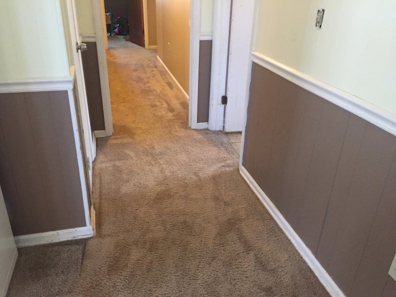

Before: Pretty soiled and a lot of urine spots. It looks much better in this pic than it really was.

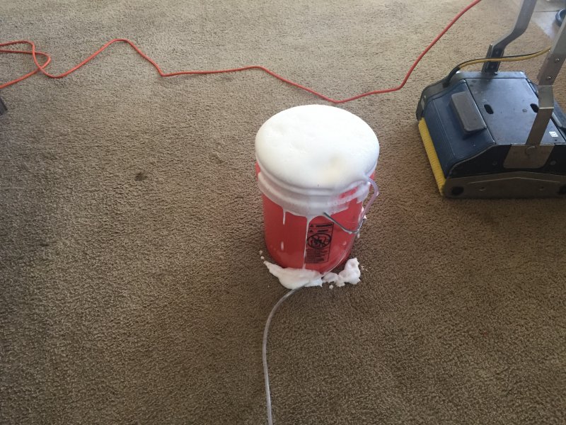

During: Cobb's oxidizing enzyme cleaner foams like mad. The color of the carpet is true to what it all looked like at the start.

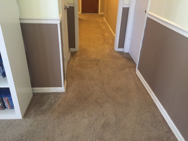

After: The color is true to how it all looked afterwards. Bright, fresh smelling without perfume and you should have seen the black water in the waste bucket.
Along with the UV light, Larry Cobb sent a 2-lb sample of his oxidizer boosted enzyme powder for treating urine. 8 ounces a gallon, so I dumped the whole shebang into 4 gallons of hot water. It slowly but steadily foamed up and overflowed bubbles on the carpet but so what? Sprayed the joint down, saturated the pee spots made visible by the outstanding UV light and discharged all of it to dwell a while.
Scrubbed in and then extracted, the carpet responded very. Very well. No perfume, but the homeowner commented on how nice and fresh it seemed.

Is thst suppose to be the after pic?
Yeah. I never seem to get why what the eye sees is so different from what the camera sees. It went from drab gray and dark to a sort of golden brown.
Really lightened up.

Is that tube coming out of the bucket going to your IPS sprayer? How did it handle the foaming ? I have found most electric sprayers don't work well with those kind of appplications.( The OSRs.)

Rick, I used piping hot water and stirred it vigorously. At the end, I found some particles trapped on the inlet filter that drops into the bucket. Other than that, I noticed that the IPS sprayer sometimes gurgled on entrained bubbles, but was mostly just fine.
Next time I think I'll mix small batches and soak urine spots instead of using it as a general cleaner. That way the foaming can work inside the contamination.
Actually, I'm not sure how to use this to best advantage, but it sure did a good job on her doggie-smelly and kid spill stained carpet.

Try this baby! Bet ya get great action with Cobbs foam in this foamer. Excellent for dwell time on uph prescrub, urine spot, etc. It comes with a pressure gauge as well. Pretty neat and useful for me on those delicate fabrics.
Also If ya want to save on shaving creme, this might be for you.
You can now offer fence cleaning as an add on to your bottom line and once Donald builds the Wall you can help him keep it clean. Imagine that government contract…you'll be cleaning for years and retire in style. Forget chasing urine, fence cleaning is were it's at!
I may diddle with an air-entraining tip for my IPS sprayer. I have a foam gun for the garden hose and once I understand the internals, would bet a doughnut I can replicate it.
