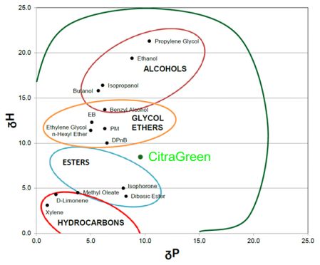

A good POG has several different solvents to work on different types of oil & grease.
This chart shows "butyl" glycol ether solubility in the middle, but petroleum grease solvents are hydrocarbons on the bottom.

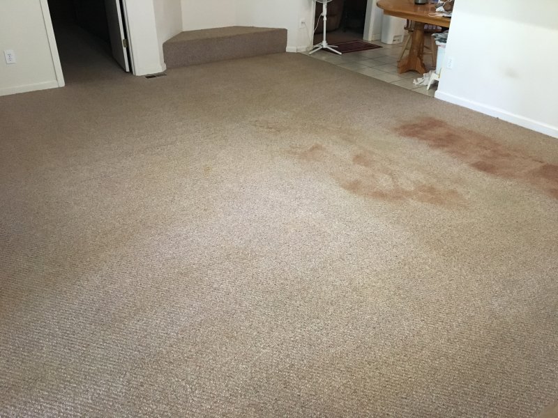

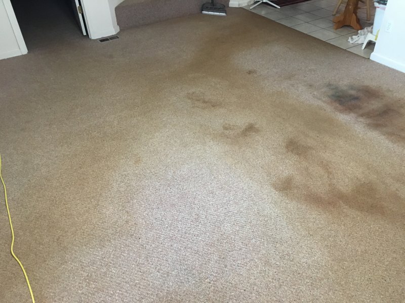

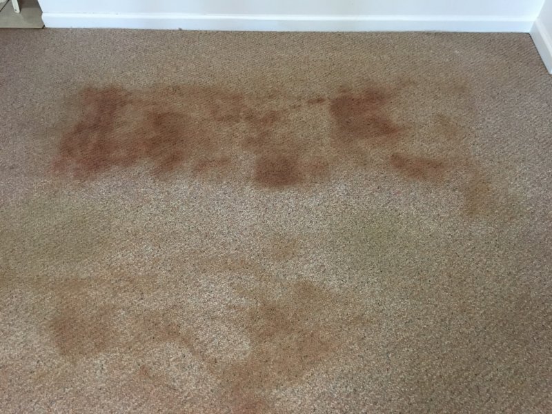

For polyester carpet with heavy red clay stains, do I need to add any butyl to rinse out any oil buildup?
It barely did anything. I cleaned it 3times, and added your POG to it on the last two times. I also scrubbed it with a 175/brush
@Larry Cobb
Red clay won the battle. I'm disappointed

Remember that Iron oxide is a color pigment that can discolor carpet fibers.
I'm sending you a quart of a new compound to try on any more red stains you run into.
