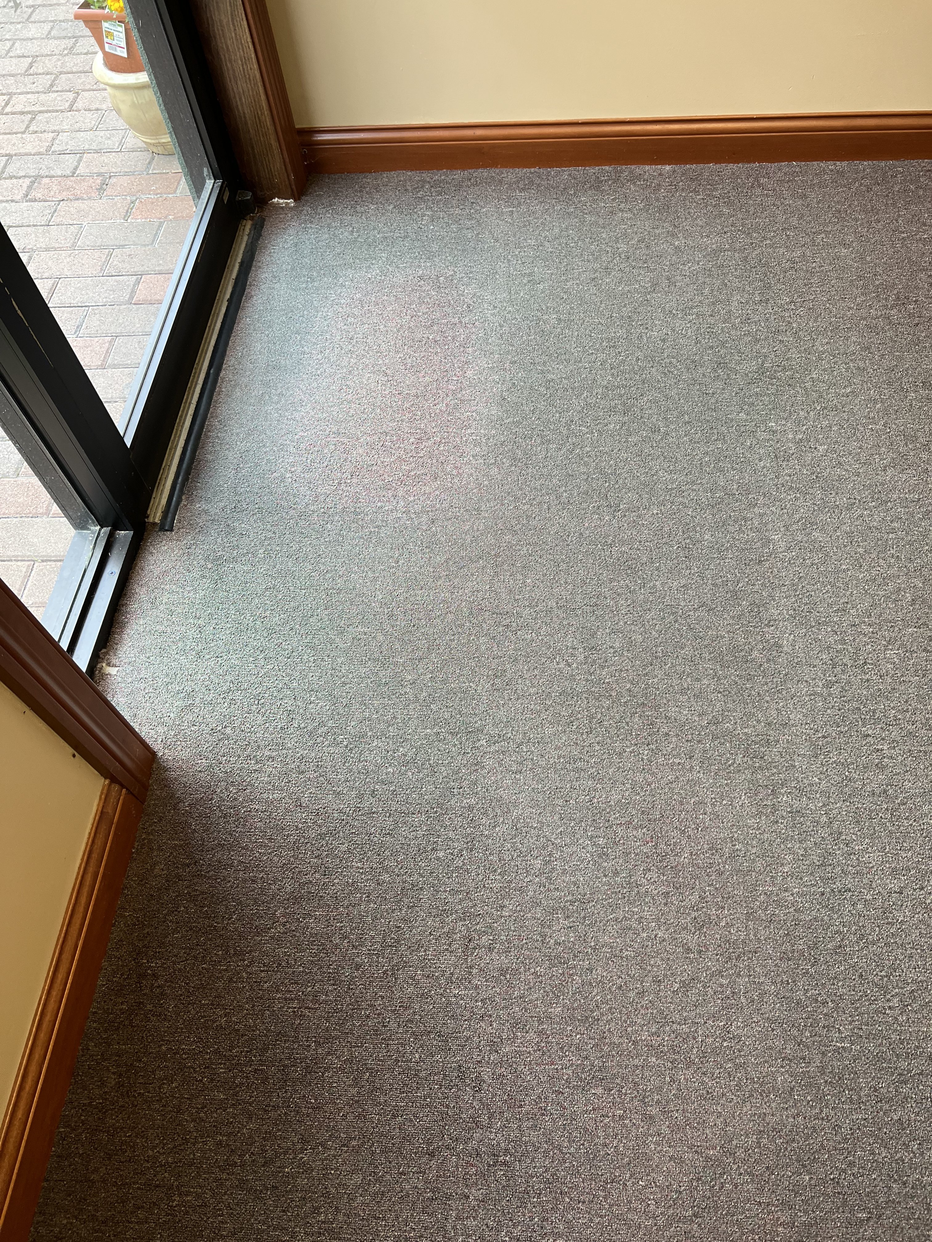

I have an urgent care that I’ve cleaned quarterly for about 12 years now. The carpets are about 14-15 years old and have slowly taken on a bleached out appearance over majority of the square footage, except in areas where nobody ever walks and under the mats, as the years roll by.
This is a small (under 1000ft2) area that receives heavy foot traffic from a staff of 5-7 and 50-60 patients per day plus their family members.
I had passing thoughts that maybe this was a result of something I’ve been doing, but I clean every square foot of this place -including where there is zero color loss. Based on that, I don’t think it’s from my cleaning procedures or products.

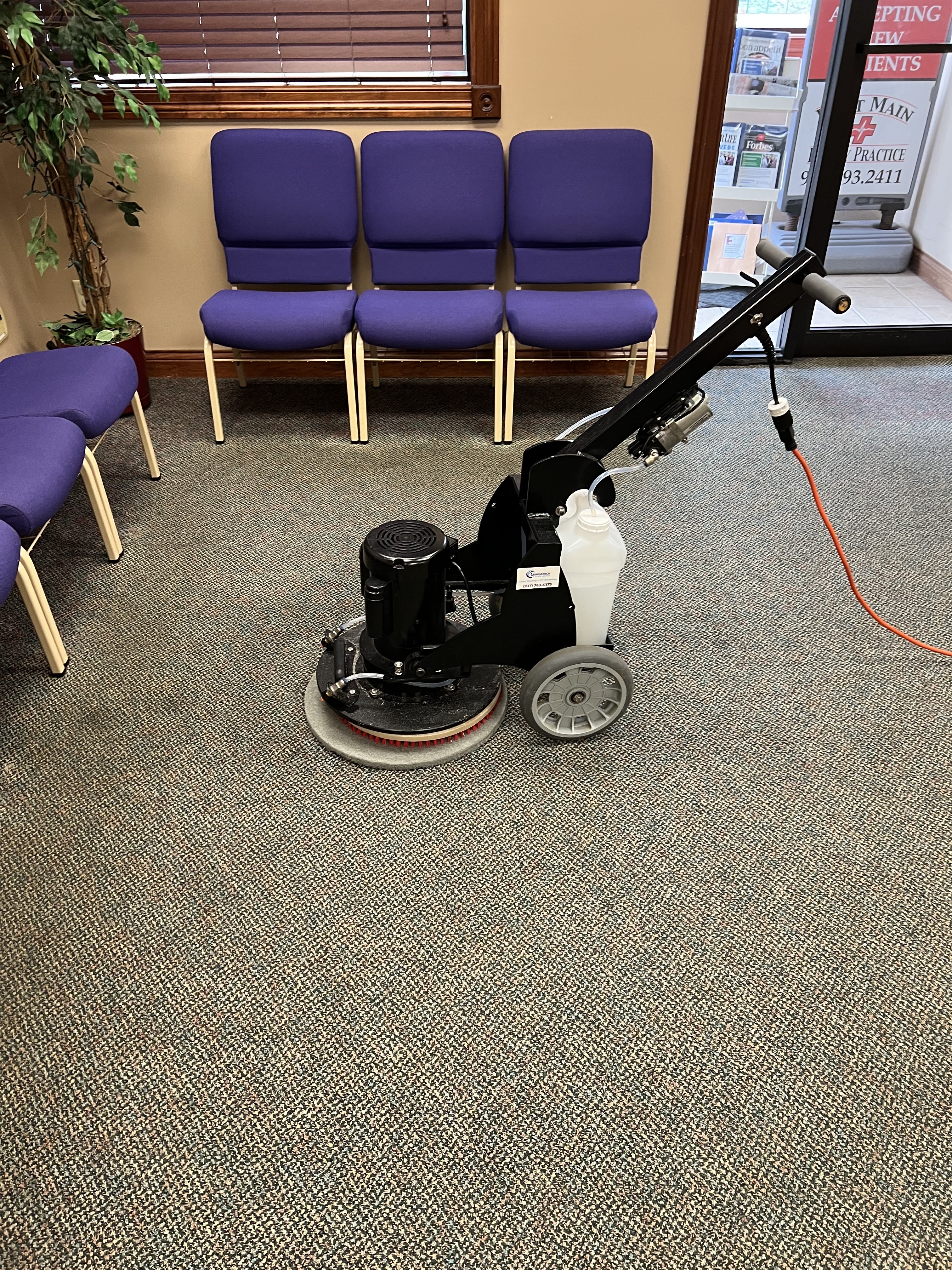

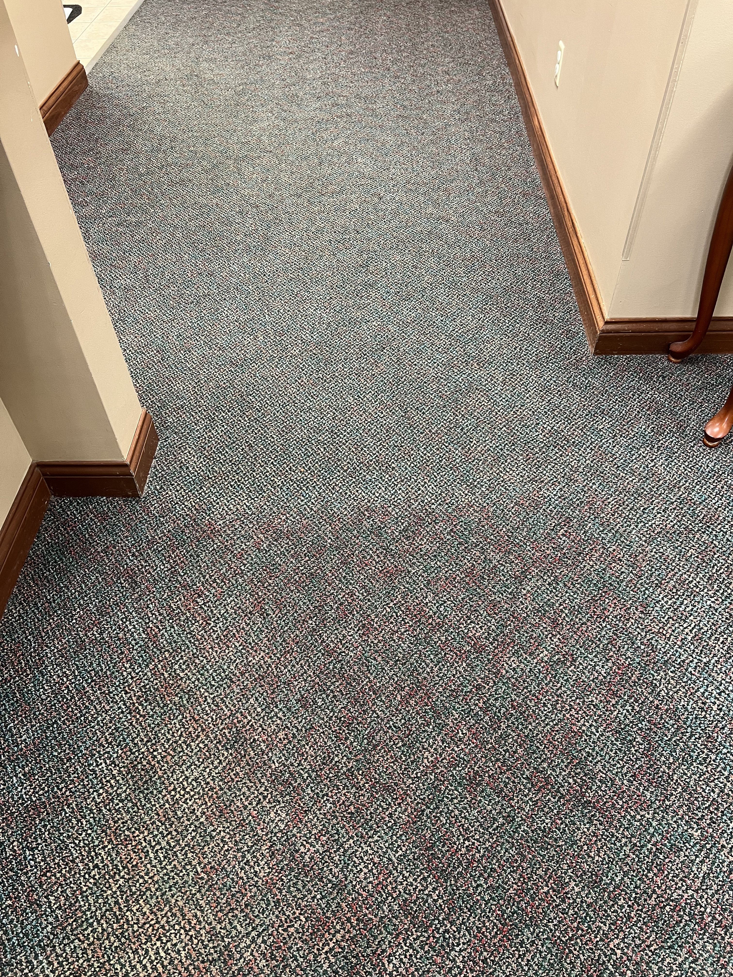

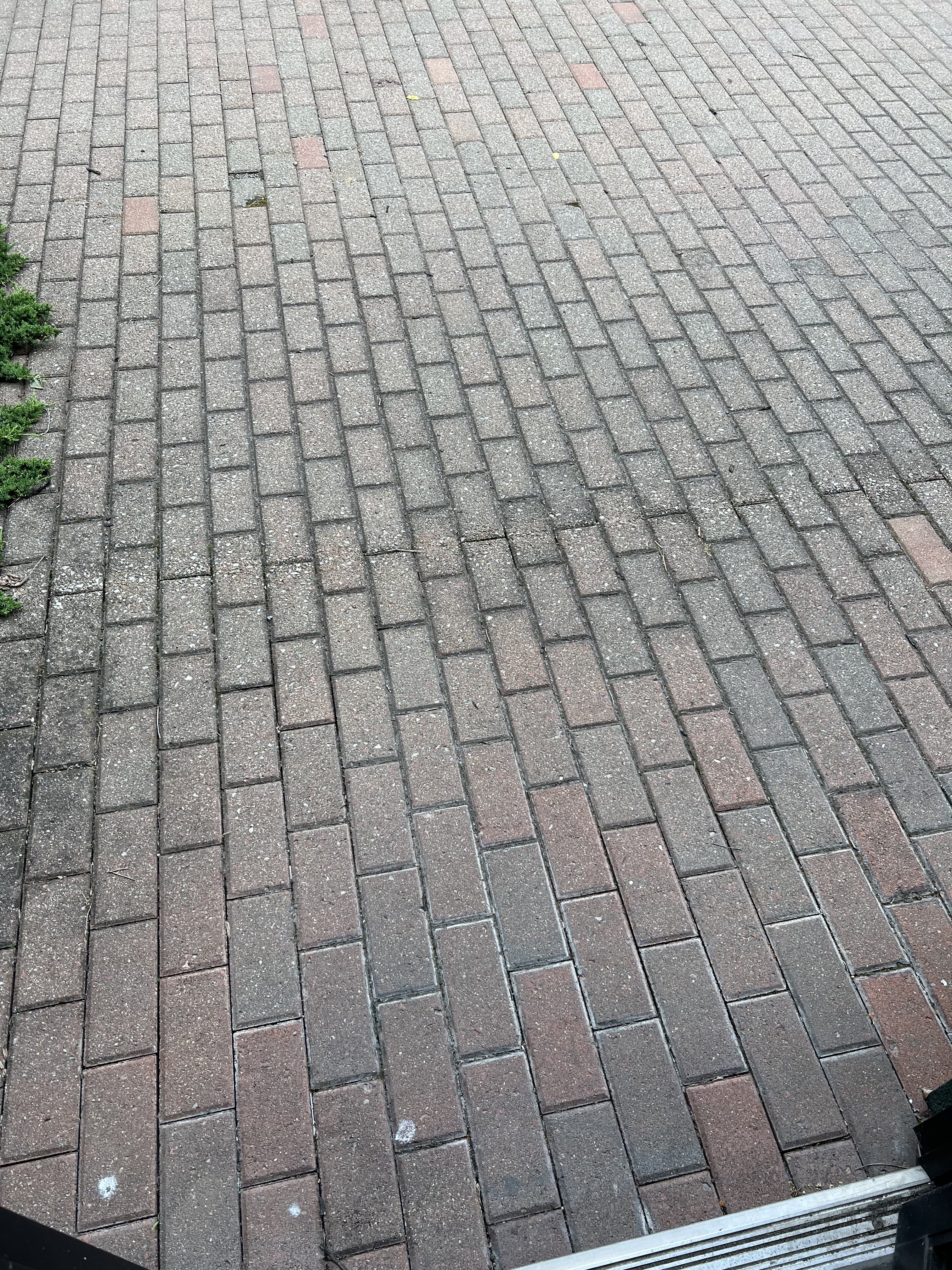

* pics of the outside entry surface, color contrast between traffic areas and under mat area, and some goofy discoloration happening on some carpet on the other side of the building.

Any of the oxy cleaners will cause color loss over time. It will be accelerated by sunshine through windows. Especially if you have used oxy spotters in certain areas. Nothing you can do outside of re-dyeing. Oxy encaps are great for coffee or water and other beverage stains but they are a low level bleach and over time can cause color loss

Pic 2 says it's uv damage
If pic 1 is where a mat also normally sits then it's 100% uv damage.

That second pic is a different type of carpet on the other side of the small building. I definitely think that could be UV damage. That specific carpet has actually only been cleaned a few times over the years. They rarely used that side of the building and when they did it was very low volume of traffic.
The carpet almost looks like it’s turning black from the bottom of the pile and migrating up over time, when you see it in person.
