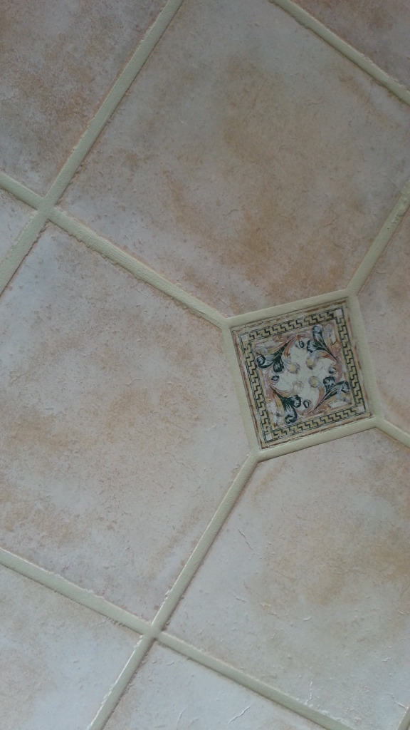

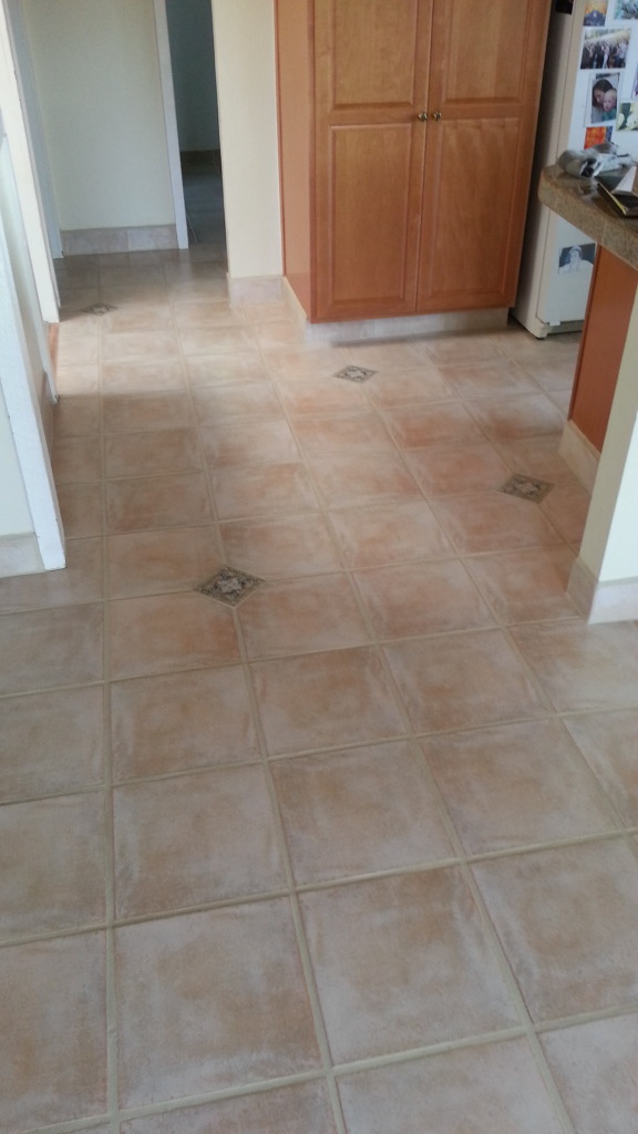

color seal awesomness.
113,261
now that we've done hundreds of Color Seal jobs they are finally starting to call back for a cleaning.
It salways a piece of cake, neutral ph prespray, light scrub in the heavy areas and a Ti Wand rinse..
Still looks "perfect"

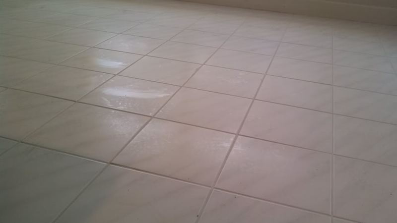

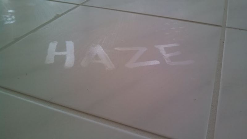

11,138
What's your clean up for haze? what are you using Mike just watched the video, got the salesman kit.
They had a oreck orbital cleaner with a white pad then clipped a terry towel to the bottom of it and buffed, what do You do?

I get the odd job now and then to clean grout haze. I pump spray pure white vinegar on the tile 10 min. dwell lightly agitate with a deck brush, then use cotton towels to remove then rinse. Don't know if this is a text book method but it works great for me.
Feb 5, 2013
527
Southern California
cameron demille
After color sealing, I spray MR Clean and buff with a tan pad. White pads work, but may not be aggressive enough. Hog's hair pads work really well, but you have to be careful. If you hit a dry spot or work it too much it can affect the glaze of the tile. I have had to refinish porcelain on more than one occasion.
If you have gnarly color seal to remove, use Acetone and a terry cloth towel. Or a white pad under a floor buffer.

we use a white pad with a 35 lb drive plate spritzing easy oxy or other neutral cleaners works great as well, except for those high groutlines that need touching up
