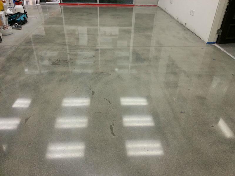

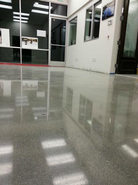

I just did this. It was ground and polished. Then I used Prosoco LS Guard and burnished it. The guard will add a shine. Stone Pro has a new guard. I havent tried it yet, but their demos in their showroom yielded very nice results.

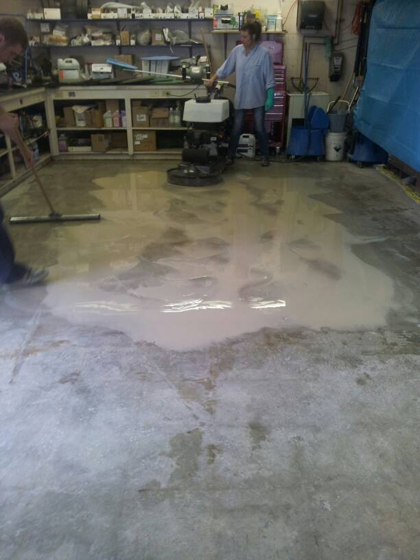

I used an Achilli machine. It's an old school machine, but the same can be done with a Cimex (which I have)
I started with 46 metals and went all the up to 5000 grit. This is a wet setup, most people do it dry. there were some extra steps that weren't needed but I did them anyway to get a feel for the new equipment. 46, 60 metals, 60, 120, 220, 360, 500, 600, 800, 1200, 1500, 2500, 5000. The first step was the longest because I was grinding out some bloqouts and divots and wanted to get a little aggregate going. I did 3 slow passes on the 46's.
I have a job coming up where the client wants the interior of his home done, but not a high polish. It will be a little less than half the time that I spent on this. One quick pass with the 60 metals, or maybe not even. Then up to 500 and seal it.

yes i prefer wet....I am sorry i dont care how good of filtration you have...that silca shit is gonna get through....
do it wet keep it on the ground...
though after the dens step then i am dry, due to very little removal on the higher grits....

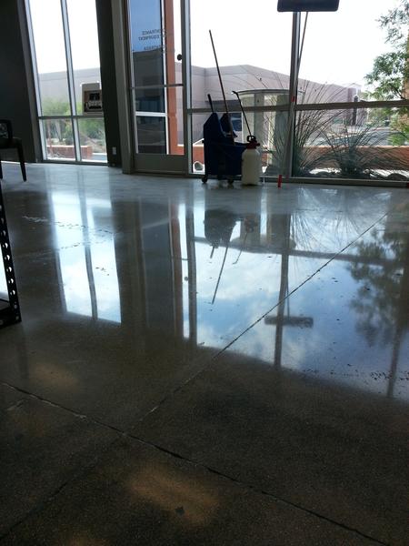

This is the Stone Pro Smart Guard SP I did last night. Awesome clarity and a lot easier to burnish without a propane burnisher

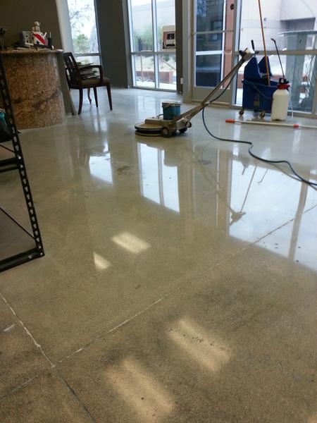

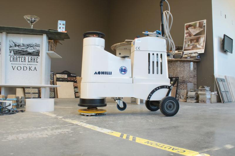

This is the machine
That looks like it would take a long time to polish with.
One thing I would like to point out is that you are getting amazing results with a machine and diamonds that are not intended for concrete. This proves what I try to tell everyone; it is the operator, not the equipment. It also proves that good stone guys can easily become good concrete polishers.
Feb 5, 2013
527
Southern California
cameron demille
Full of water, it's 350lbs on a 12" foot print. it's not as bad as it looks. After the 60 grit everything goes very quickly. It's definitely not good for large commercial stuff, but this machine is a beast. It's on par with my 19" Cimex on 220v 300lbs. It's just a really old fashioned design. We bought it for texturing and antiquing, which it excels at. It's more physical effort though, without a doubt.

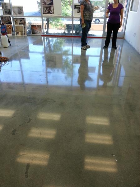

Was present for this small demo using a new machine from Pioneer eclipse.. 50 year old building where vct was installed..didn't even use the deepest cut they have available but did use a 30 grit to start.
Was pretty neat. Put the machine into burnishing mode and used a special heat pad along with a special product that ...according to them turns concrete into quartz.
This stuff is super durable. Used a screw driver with all my power behind it and first scrapped the unfinished stuff. It scratched quite easy...then onto the finished project..barely anything.

John looks good.
Concrete, other then being dirty looked like it was in good shape though?
How much time did it take start to finish there?
Sent from my GT-I9100M using Tapatalk 2
John G
Oct 16, 2006
911
Right at 20 minutes start to finish. lConcrete was in good shape but we started at step one with the Cheetahs anyway.
