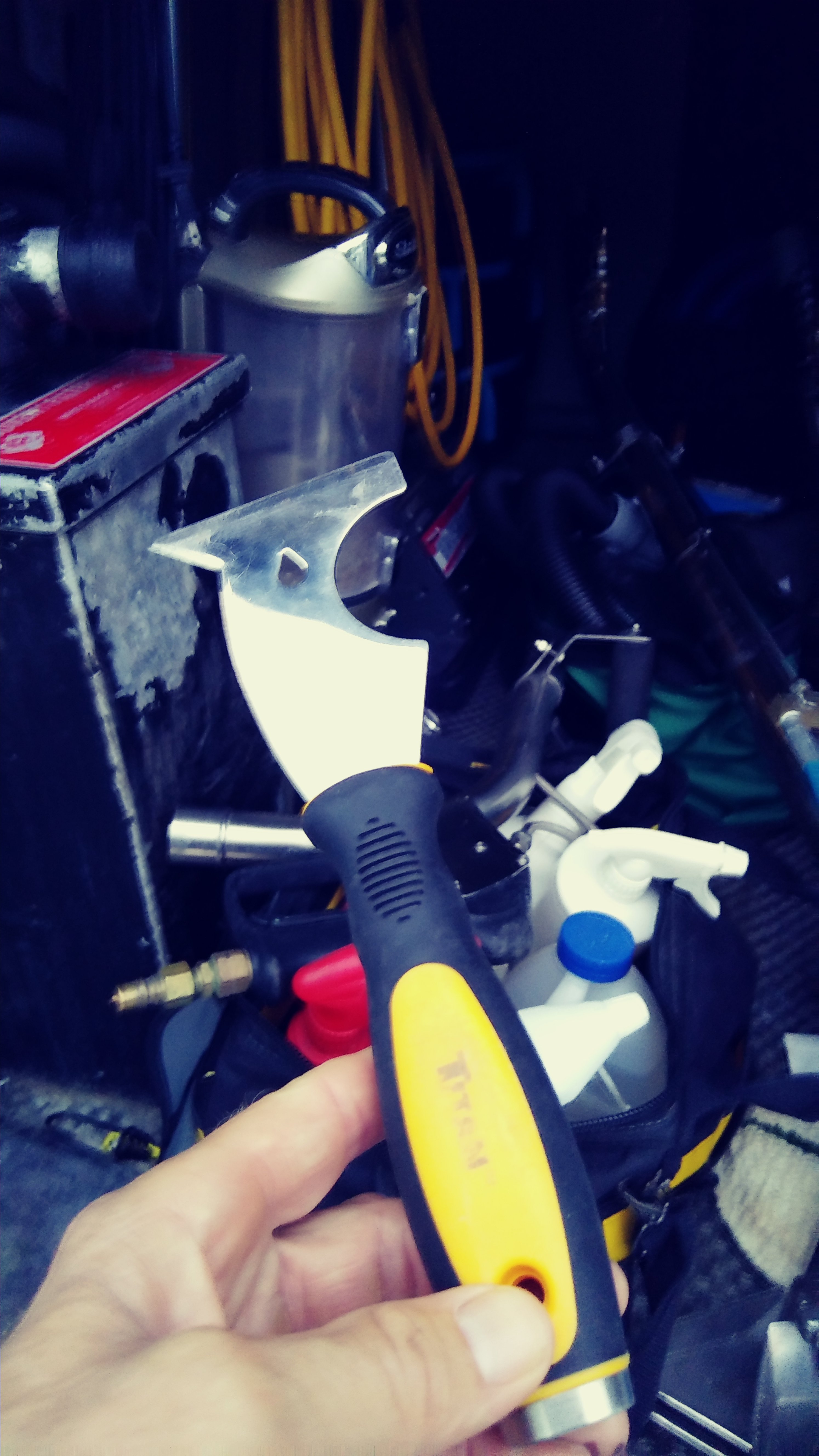

Carry a heavy duty scraper to remove glue and paint while shop vaccing.

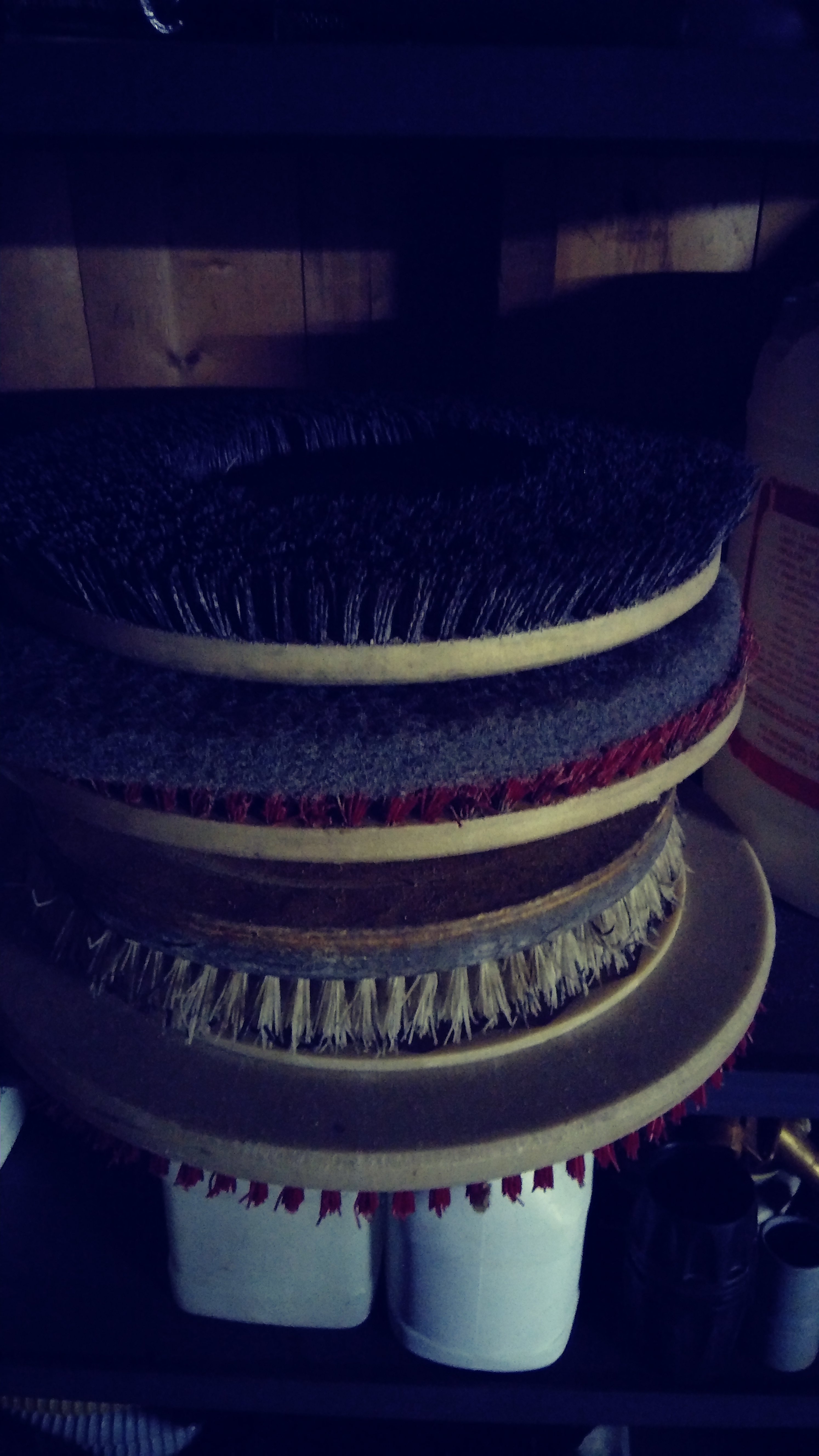

13,372
Need to keep the vac slots clear for good water and soil removal.
When I've skipped shop vaccing the floor still feels gritty when dry.
Same with leaving puddles.
My filters on the van plug up even after shop vaccing too. Lots of sawdust.
13,372
You can get a filter for the exhaust too but I found that blows the air in different directions causing settling issues. Blowing 2 feet over the ground doesn't stir it up much.
And a sharp one of these.
