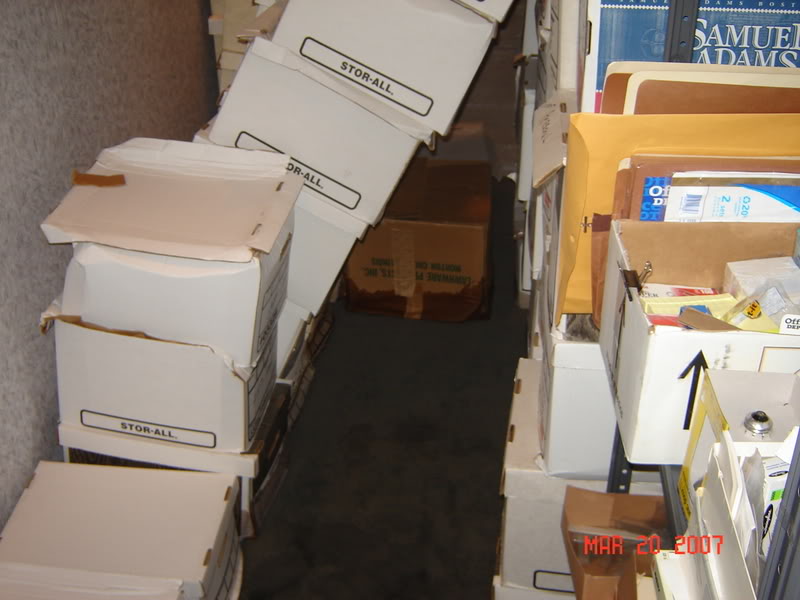

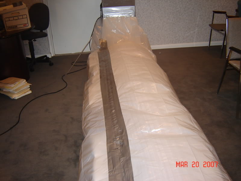

On that loss, the lawyer did not want the document seen at all...I just dried the entire box and contents of the boxes...

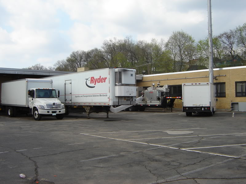

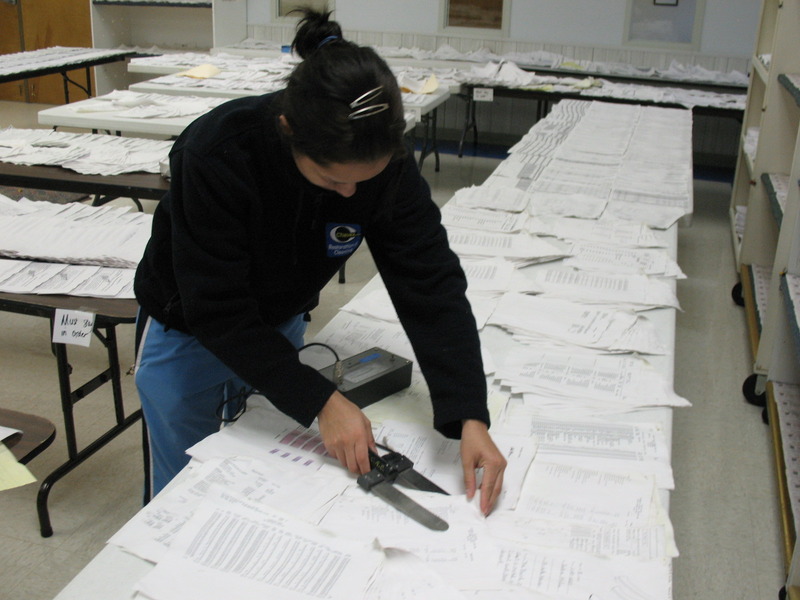

Other large commercial document recovery losses, I've brought in refer trailers sent off to be processed...
We've never run into any big book or document loss. Usually just enough for them to be concerned but not enough for them to call in the big boys.
We've dried books that had sentimental value. Still warped but dry. Boxes and boxes of old records (things you store in a basement) again just for retrievable use. Often with ink run and water stains but dry.
