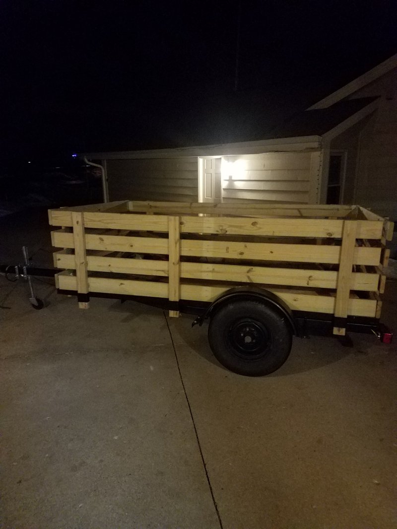

9'6X6' I think you could get 4 in there sideways, but you know best..

Treated 2"X10" floor boards, and 2X6 for the sides.. I don't have a good daytime finished picture, so..

It's a little heavy on the tongue,I think I'm going to go with a gate ramp on the back to even it out..

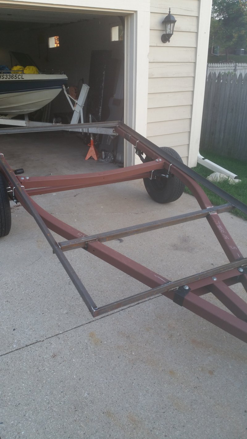

Axle is moved as far as I could forward due to the shape of the original trailer..

If you are judging by the picture with the frame you are correct.. I moved it up after that picture right to the point where it starts to turn in.
