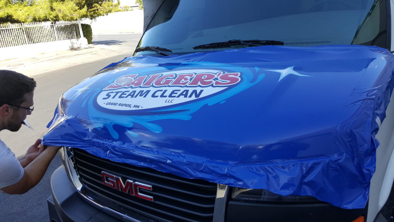

This picture makes me feel good, I got the hood on with out ever stretching the vinyl,
I ripped the middle section of paper off, put it on the hood and smoothed it out to make a "hinge" , removed one side of paper and gradually smoothed it on, then did the same with the other.
Went on like butter :D

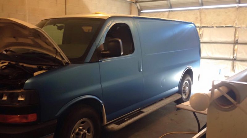

All done. Outside shots to come later today :)
