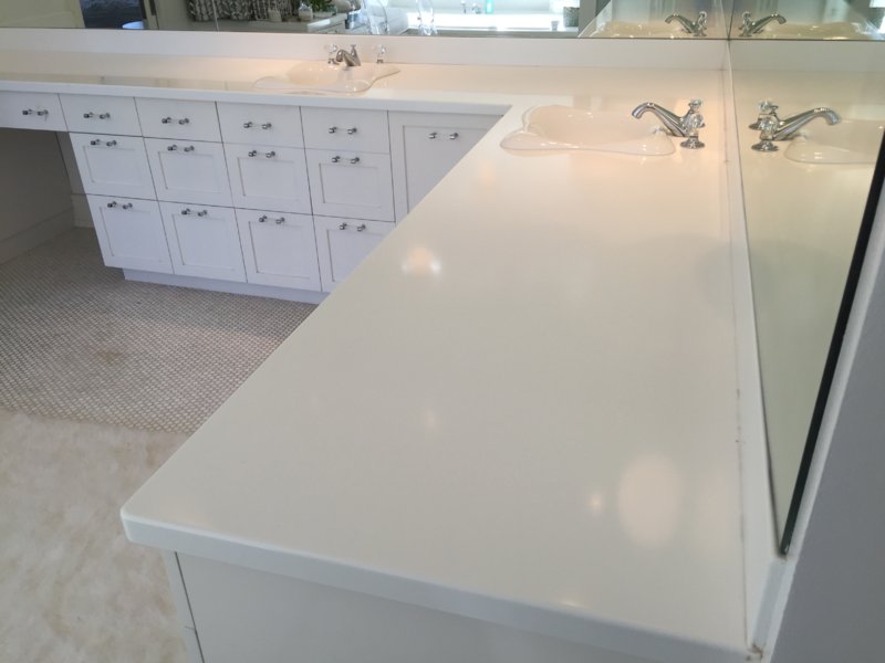

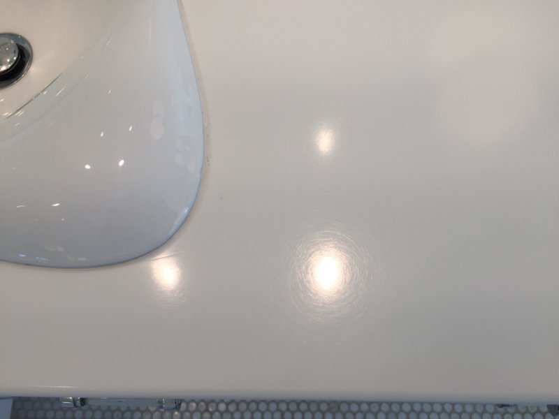

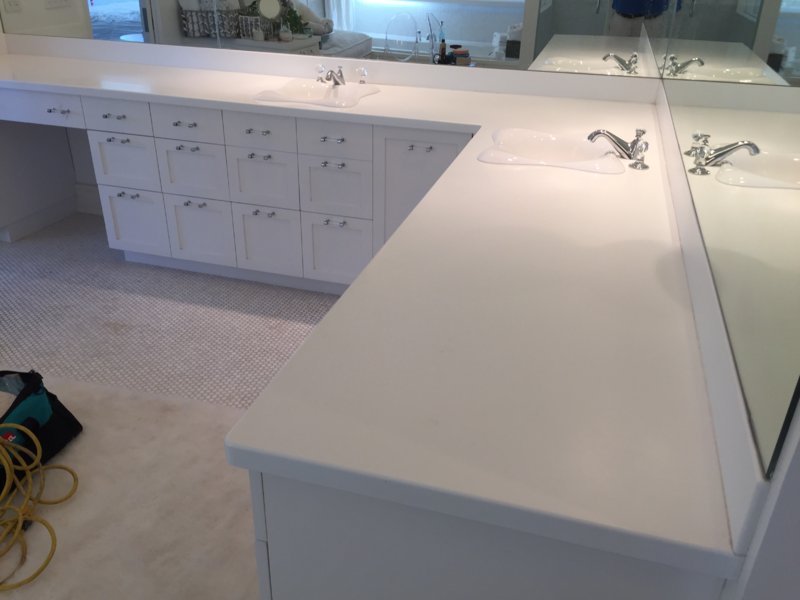

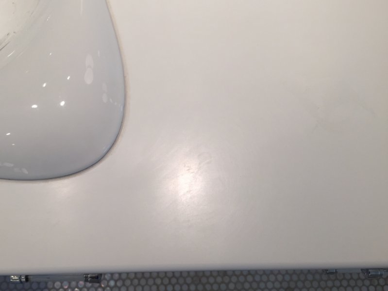

Simple buff, happy customer:
Heart of Dixie
Do you think you could of wet ended the scratches out?
Mike, no tutorial.
Michael, yes. Corian is not a difficult refinish. In this case, the customer only wanted it to look spiffy for company, so as with fiberglass, I just used a polishing cream and a buffing cream at 1 and 2 with a Makita. About 900 rpm or it flings everywhere.
It looked very nice. She just didn't want to spend a bundle.
