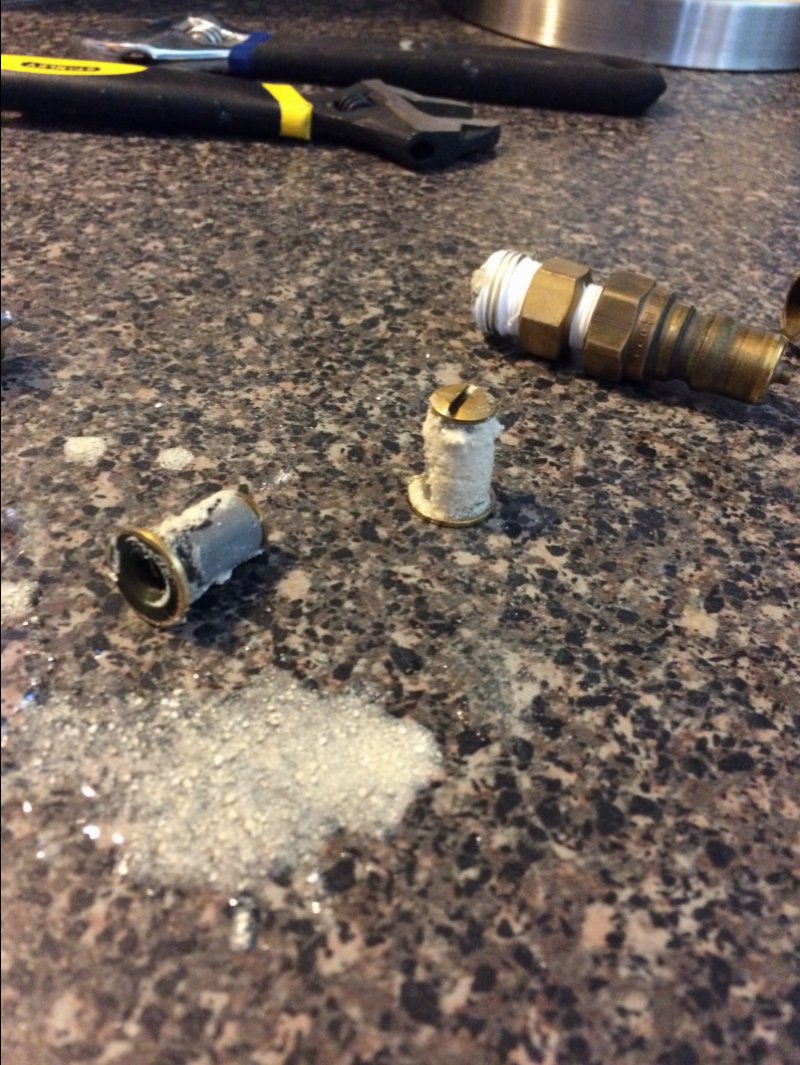

Corrosion from emulsifiers
11,504
The soap free from MB ate brass, liquid slurry and effiecent extract left a lot of white powder build up regardless of uncle Larry's rinse theory. Effiecent extract says right on the label flush, I think because of a anti resoil agent. Also magic potion left a wicked white powder coat, but in defense of magic potion the outbound check valve valve lost an o ring on the machine a chemical was flow through out the whole machine. Formula 90 powder completely disappears like your using nothing when your using high heat.
11,504
But I do agree after every job turn chemical off run fresh water through system and hoses. I use a stair hook on the wand to keep water flowing while cooling machine.

Lastly something to think about not all machine are created equal. The prochem/sapphire designs chemical pump and brass fitting can be a problem. I'm not sure about steam way machine if they use last step chemical injection too?

This started happening in my filters. It just looks like hard calcium buildup.
I did a de scale yesterday and will be playing with it more on Tuesday (taking Mon off).
My hope is that "Blazin' Blue" is actually cleaning some of the scale out of my system (Cleanco 47).
Is this wishful thinking?
Could this be caused simply because I've been changing it up too much?
About a month ago I ran Cobbs "All Fiber Rinse" (Acid). I probably only ran 2, 2.5 gallon jugs through it while cleaning apartments.
Maybe the acid rinse broke some calcium free?
I'd love to find a last step that keeps the system free of crap but I might be dreaming?
Either way, I have to get a handle on this clogging of my filters. It's a production killer.
Any advice is appreciated.

The clogged in line filters continue, even after a descale and just a fresh water rinse on quite a few jobs. It seems to be improving though.
I've got a few gallons of your All Fiber Rinse. It may have been that, that started to break the scale out of there.
Advice on what to do would be great. Should I go back to that rinse to try to get more crap out?
Do you have a better de scaler than the (pretty mild) Hydramaster Truckmount de scaler?
I really don't think I have a good understanding of the scale in my exchangers. I have a Cleanco 47 with Max Heat.
She has been awesome and plan on running it for years to come. I really want to get a thorough de scale done.
The de scale I did was just run through my Chem feed jug. Maybe there's a better way?

Russ run a gallon of regular vinegar thru your jug and let it sit for half an hr. Then purge it thru your hoses to clean them out too.
