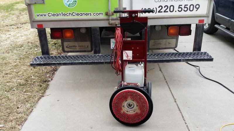

what happened to all this talk about big trucks dying and etm will be the future with mytee? lol
........ exactly ;)
Tracy what are your thoughts on single vs dual recovery tank?
all day cleaning ( literally ) or added room for other tools+ pump out?\
Ive only ever worked with dual tank at's.
Some days I wish I had the added room but then winter rolls in....apo = nope. Or just massive jobs.
Even as Is on monster size jobs I have had a cimex, rotary, op,autoscrubber and rx20 plus room for all my odds and ends for out of town jobs, and thats just the very back.....
(I like back up stuff for my back up when Im far out lol)
the Cm fits nicely in the at and is even Mb approved. The sticker says so :stir:
