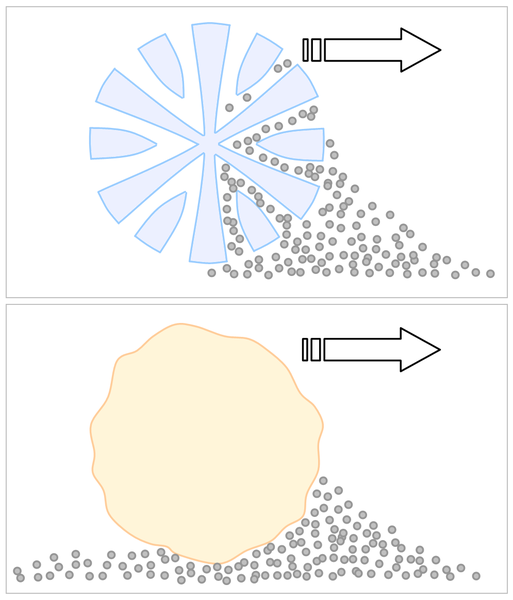

The information on Wikipedia regarding Microfiber is interesting. Notice especially the section heading "Rags" (as that relates to cleaning)... http://en.wikipedia.org/wiki/Microfiber
Here's a copy & paste from Wikipedia...
Microfiber products used for consumer cleaning are generally constructed from split conjugated fibers of polyester and polyamide. Microfiber used for commercial cleaning products also includes many products constructed of 100% polyester microfiber. Fabrics made with microfibers are exceptionally soft and hold their shape well. When high-quality microfiber is combined with the right knitting process, it creates an extremely effective cleaning material. This material can hold up to eight times its weight in water. Microfiber products have exceptional ability to absorb oils, and are not hard enough to scratch even paintwork unless they have retained grit or hard particles from previous use.
Microfiber is widely used by car detailers to handle tasks such as removing wax from paintwork, quick detailing, cleaning interior, cleaning glass, and drying. Due to their fine fibers which leave no lint or dust, microfiber towels are used by car detailers and enthusiasts in a similar manner to a chamois leather.
Microfiber is used in many professional cleaning applications, for example in mops and cleaning cloths. Although microfiber mops cost more than non-microfiber mops, they may be more economical because they last longer and require less effort to use.[SUP][10][/SUP][SUP][11][/SUP]
Microfiber textiles designed for cleaning clean on a microscopic scale. According to tests using microfiber materials to clean a surface leads to reducing the number of bacteria by 99%, whereas a conventional cleaning material reduces this number only by 33%.[SUP][12][/SUP] Microfiber cleaning tools also absorb fat and grease and their electrostatic properties give them a high dust-attracting power.[SUP][citation needed][/SUP]
Microfiber cloths are used to clean photographic lenses as they absorb oily matter without being abrasive or leaving a residue, and are sold by major manufacturers such as Sinar,[SUP][13][/SUP] Nikon and Canon. Small microfiber cleaning cloths are commonly sold for cleaning computer screens and eyeglasses.
Microfiber is unsuitable for some cleaning applications as it accumulates dust, debris, and particles. Sensitive surfaces (such as all high-tech coated surfaces e.g. CRT, LCD and plasma screens) can easily be damaged by a microfiber cloth if it has picked up grit or other abrasive particles during use. One way to minimize the risk of damage to flat surfaces is to use a flat, non-rugged microfiber cloth, as these tend to be less prone to retaining grit.
Rags made of microfiber must only be washed in regular washing detergent, not oily, self-softening, soap-based detergents. Fabric softener must not be used. The oils in the softener and self-softening detergents will clog up the fibers and make them less effective until the oils are washed out.
​Cross sections: microfiber thread above, cotton thread below
