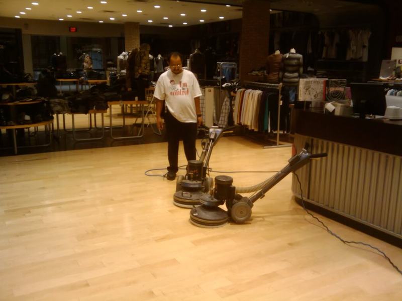

YOu can do whatever you want with an RX-20.
