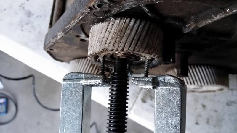

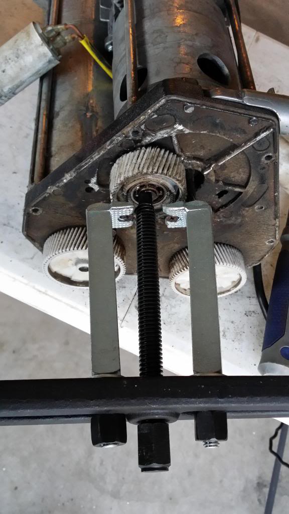

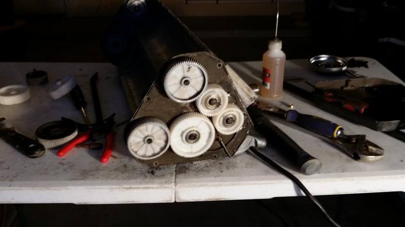

the gears were stripped and they all came off easy except one. it was frozen on the shaft. so, i put a couple wood screws in it then used a puller from harbor freight.
it was like a 20 minute repair.
