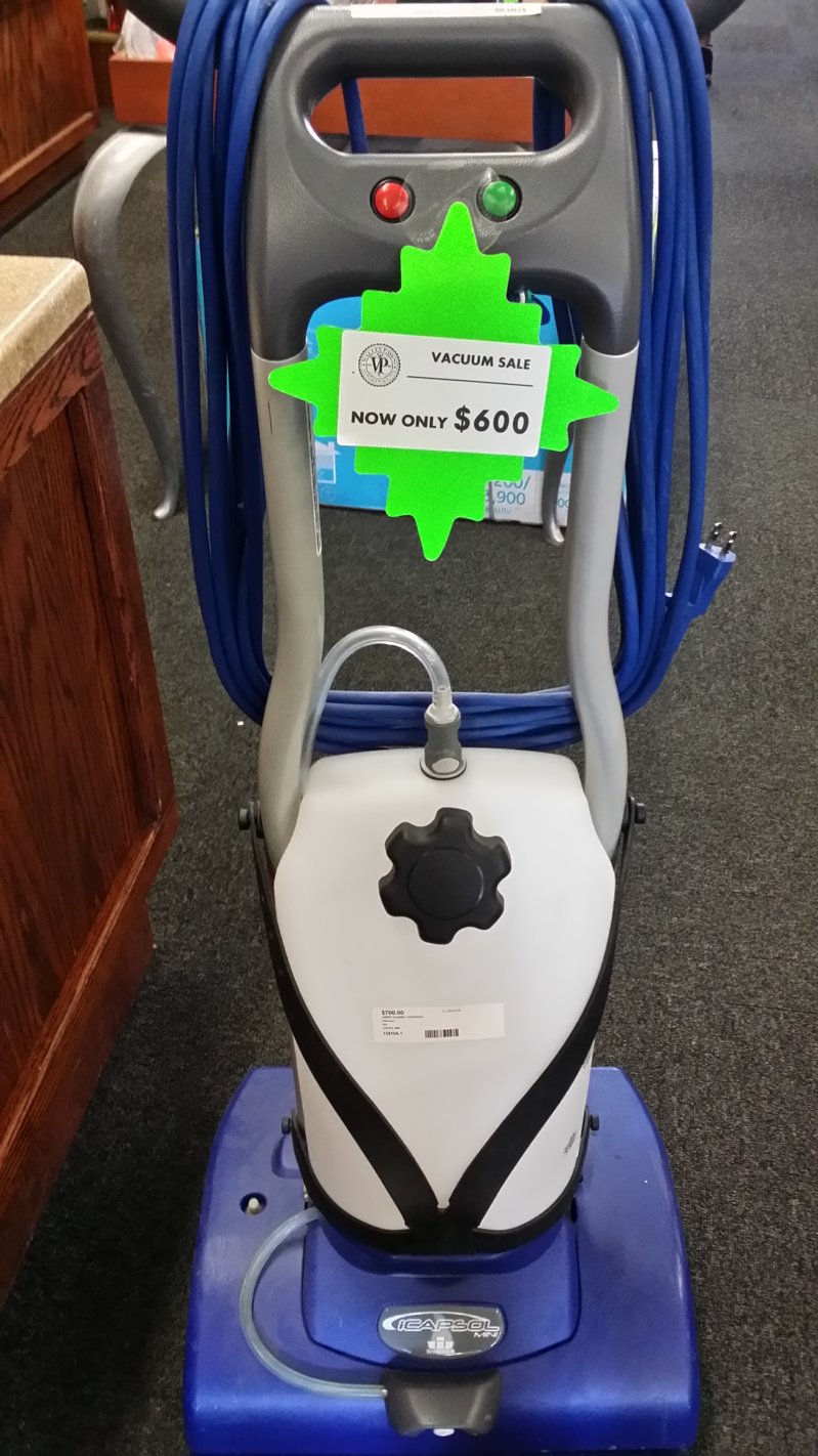

I never met a CRB I didn't like. I like the small Host machines, the 10 and 20 inch Whittaker's are great, and I especially like the new Prochem CRB I scored at a local pawn shop.
