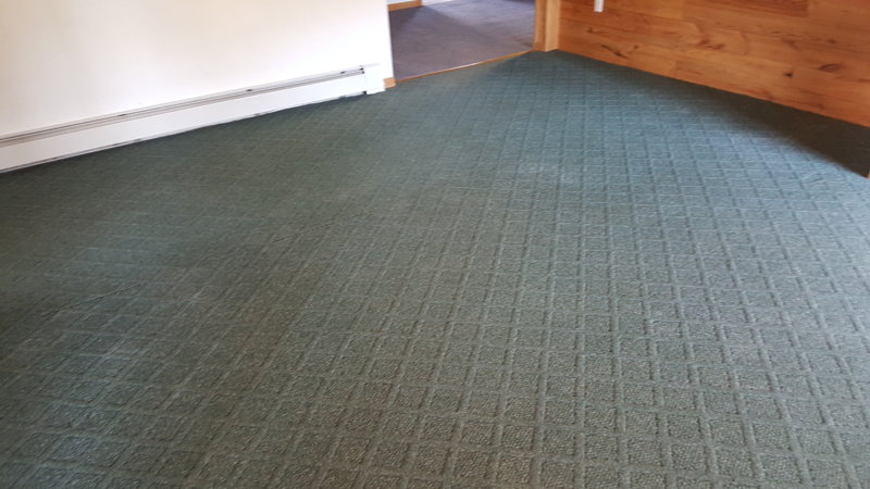

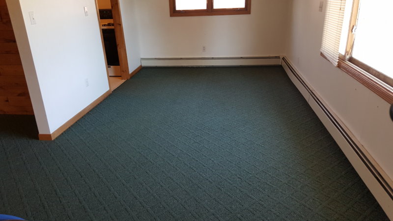

Well, here was my urine job from few days ago in empty.
This is the carpet powder, carpet fresh that came to the surface.
Sculpted Berber... We didn't see any carpet fresh, powder when first prevac, but obvious it was there...

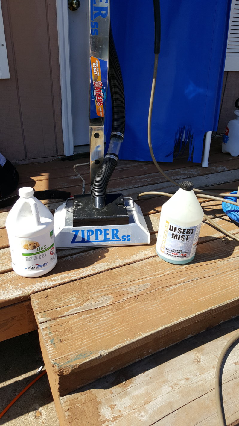

Just went and did more prevac, got out a little more...
Then treated with Hydrmaster UPS and some Harvard Desert Mist deodorizer with quat properties (neutral 7 pH)
Let dwell and hit again with the Zipper SS Super Spinner and used an encap acid pH in the rinse.
Will see what happens this time... Green and Blue Berber.. It will show up if still problem

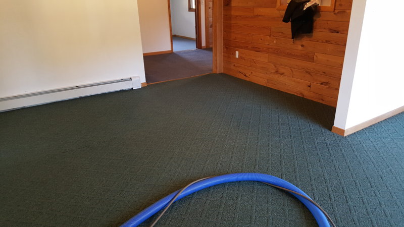

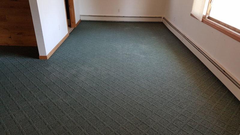

Well......
To update you one our situation....(not my rough looking hands :) )
This green Berber is really being a pain in our rear....
We cannot get the powder to vac up worth a dang and blasted it again the other day as noted...and still being a problem....
So....back again tomorrow and see what we can do....
