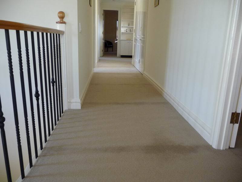

Continuously getting called in to remove crush bands such as these below
Now on nylon and wool, mostly very easy and problem solved.
But we're getting more and more polypropylene carpet, and crush bands in those just don't wanna be fixed.
Anyone have any success on poly?

I often removed crush bands with lots of wet heat (from Jiffy Steamer or my Powermatic) and Grandi Brush or Grandi Groomer.
The sucess rate for poly was much lower than for nylon and wool. Nylon and wool problem solved 90% of the time. Polyester problem solved 30% of the time.

What the hell is a crush band?...I can't tell from the pic.

A band of carpet running across the width. The tufts usually lay opposite of the normal pile direction or may simply be flattened. Appears as dark bands across the carpet.
Likely cause from the carpet on the bottom of a pile being crushed from tto much weight or too long in storage.

Brian,
As the installer rolls out the piece, the part on the bottom of the roll is flattened where the top is not. This leads to the difference in appearance. The smaller the roll becomes the closer the bands.
Some times it is because the cardboard insert flattens due to the weight of rolls piled on top which places all the weight on the bottom.

Mikey, steam and grooming will always rectify a nylon carpet with this problem. Wool mostly, although if the carpet has had a lot of usage, and the pile has started packing down in the wrong direction (not unlike shading) it can be difficult to rectify the wool pile.
Scott, thanks for the description.
Billy, the cardboard tube is responsible for a lot of bands at the start (inside) of the roll. It can be as you say, the tube flattening, and also the edge (or the start) of the carpet can set up some bands. Rolls stacked on top of each other is the main culprit. And pre cut and stored house lots are often a problem, because most don't have a cardboard core, and often get flattened before they get laid. And a loose roll can have the sides squashed, and also end up with crush bands.
Steven and Josh, your terminology is correct. The carpet manufacturers here call it roll pile crush bands. I got tired of typing all that and just call them crush bands.
With the popularity?! :evil: of polyprop, I'd like to find a way to fix these, if there is a fix.

Just reading back, I think I should explain further.
Carpet is manufactured with a slight lean (for various reasons). Assuming this lean is the same all the way along the length of the carpet, the carpet will look the same.
If some of the pile is squashed further down, or laying (even slightly) sideways or back in completely the opposite direction, there will be a difference in light reflection.
If you look at the pic, all the carpet pile is laying away from the camera, except the dark lines, where the pile is laying back in the wrong direction and instead of reflecting back light, it's absorbing more of the light (looking at the tips of the pile instead of the sides). Hence it looks 'darker'.

"M," my experience with repairing roll crush on Polyester is that it requires hotter steam with more volume and more contact time between carpet and steam head.
I have had limited success by using a pile lifter to remove crush marks on Olefin carpets.
