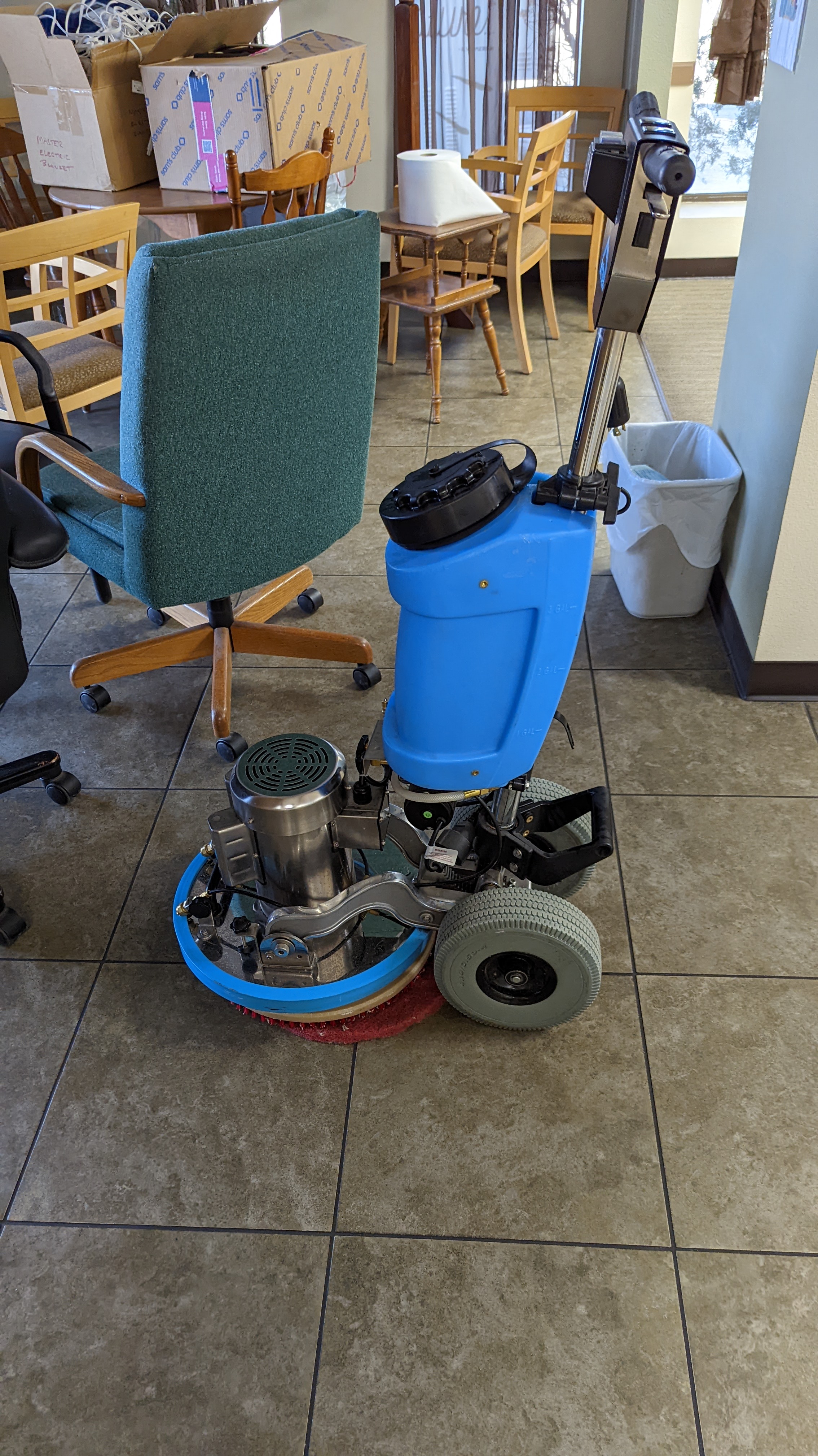

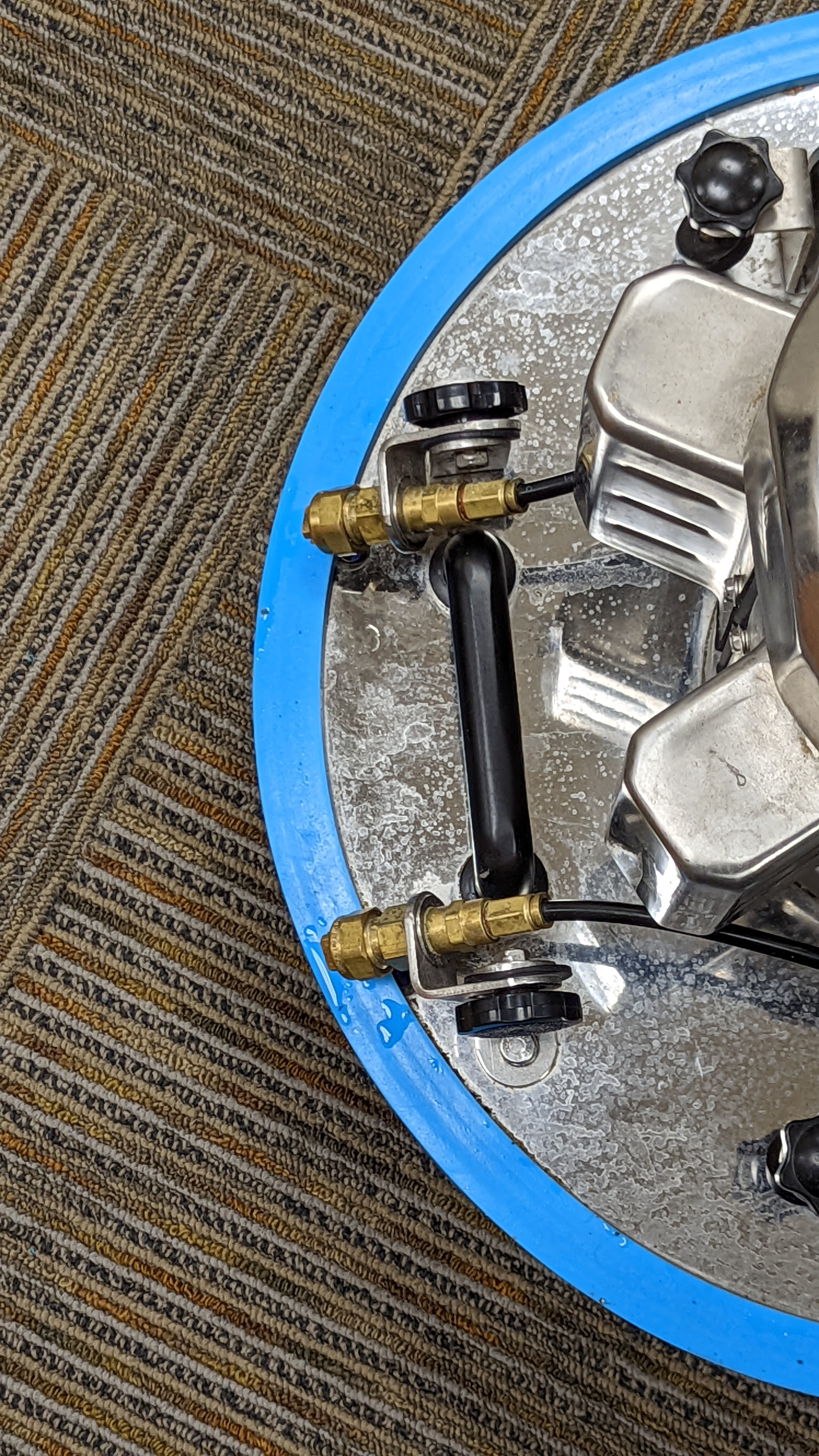

spending some real time with the now extinct Mytee Eco OP
way too tall/long
sprays ahead 15" or so compared to the TOPS 5"
no tamping action, which is very missed
horrible on/off switch configuration
tipping it back to flip or switch pads is a pain, the head does not do a full tilt and solution comes out of the tank if you go too far back
now way to run water through the system after a job with out draining the tank
its almost like who ever designed it never cleaned carpet.....

It does have it's little flaws, but overall mine has been a great unit. I used it yesterday to put down some Obliterate, Chlorine Dioxide, that I won on auction here.
