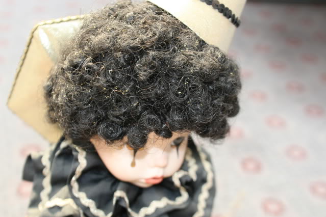

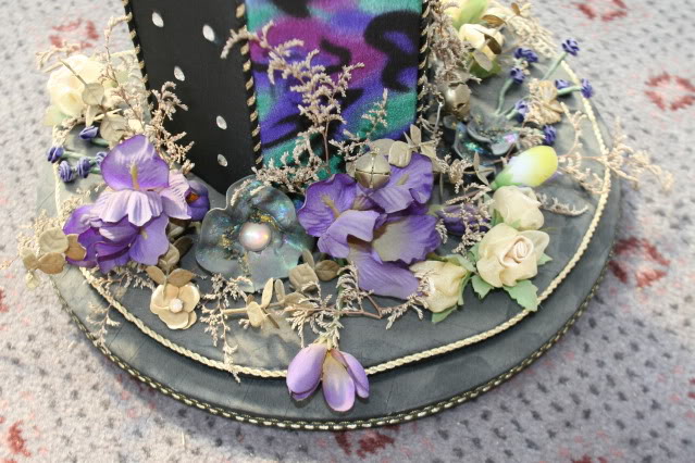

I've tried air dusting (done it in the past successfully, but there appears to maybe be a oily film that teh dust is settled in and so dusting will not budge.
Soot content is reasonably minor and mainly building materials burnt so should have been a simple dry soot cleanup.

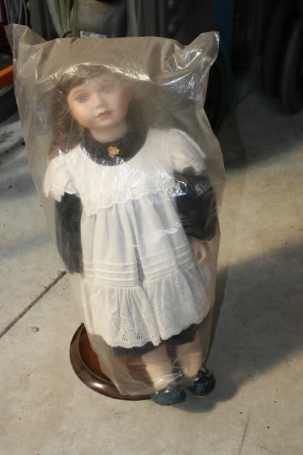

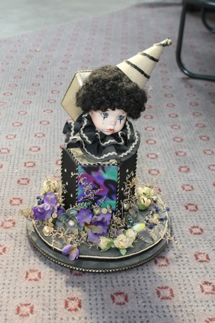

These are items of HIGH sentimental value as they are made by the lady and she can no longer make them. These are the two prize pieces she kept.

Paint brush and Q-tips and OMS for hair and fabric. All purpose cleaner or glass cleaner for the rest. Check all surfaces first with cleaning solution to make sure of no damage.
If it is water safe, it could be dipped in an ultrasonic machine. Although the painted surfaces can be damaged if left in contact too long. I would do several quick dips instead of one long one.
If not water safe, replace the hair and OMS the fabric.

Thanks Richard, I've gone back to teh Adjuster with some options and costs and the ball is back in his court now. He did tell me that they are now finding that they are slightly uninsured so he indicated we'll now find out really how valueable they are to them. The doll ins't too bad overall, there is soot on the feet/socks/shoes but the rest of it is more light dusting and then deodorisation.

Here is an idea for you, try Ultrasound with DI water or Pure Water System if it is water safe I would think if it works it would do it in seconds, tops a minute.

Greg, items have water sensitive materials under the fabric giving it shape.
