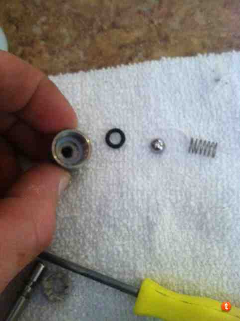

if the jug is filling up, the problem is the ball bearing and the spring on the draw tube. I can not find a picture to show it, but on the draw tube were it connects to the dema valve, there is a spring and ball bearing in there that prevents water from back filling the jug.
Man I really feel stupit : )
Forgot the O ring!
Thanks Tim!

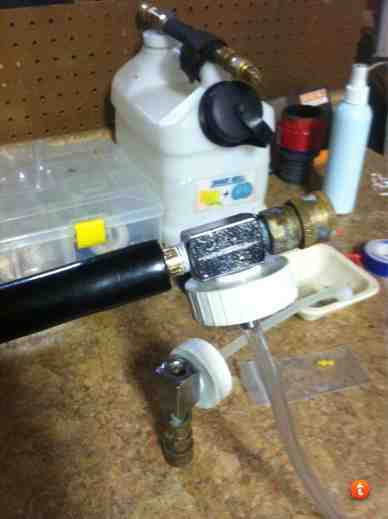

put a video up showing the setup and watching it back fill.....
Its snowing. When the porty gets here thurs it will be easier to work on, so I will try then. Worked on them a little last night but it was way too late to fire up the Genie so...

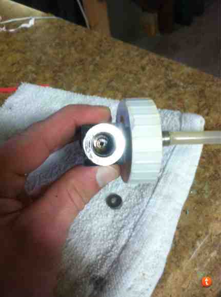

Remove the handle!
Inside the block, in front of the water nozzle is a thick gray plastic looking washer as shown on the white towel.
Also stretched the spring out under the ball. Replace the Ball O ring aswell.
All user repairable with a few cheap parts.
