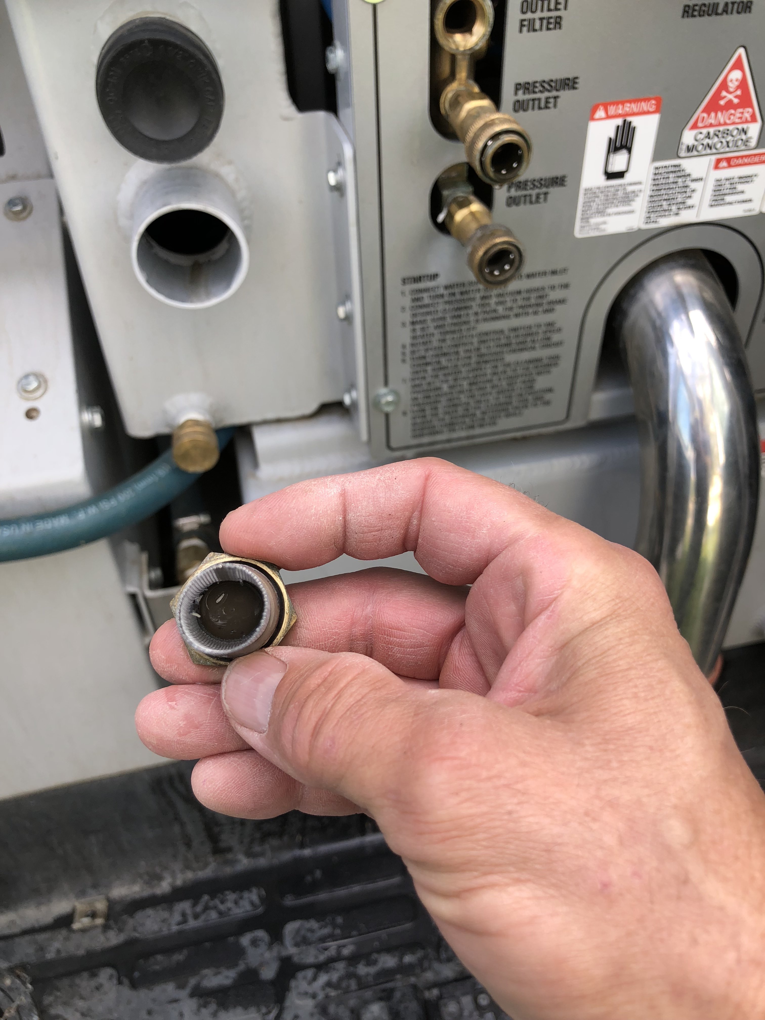

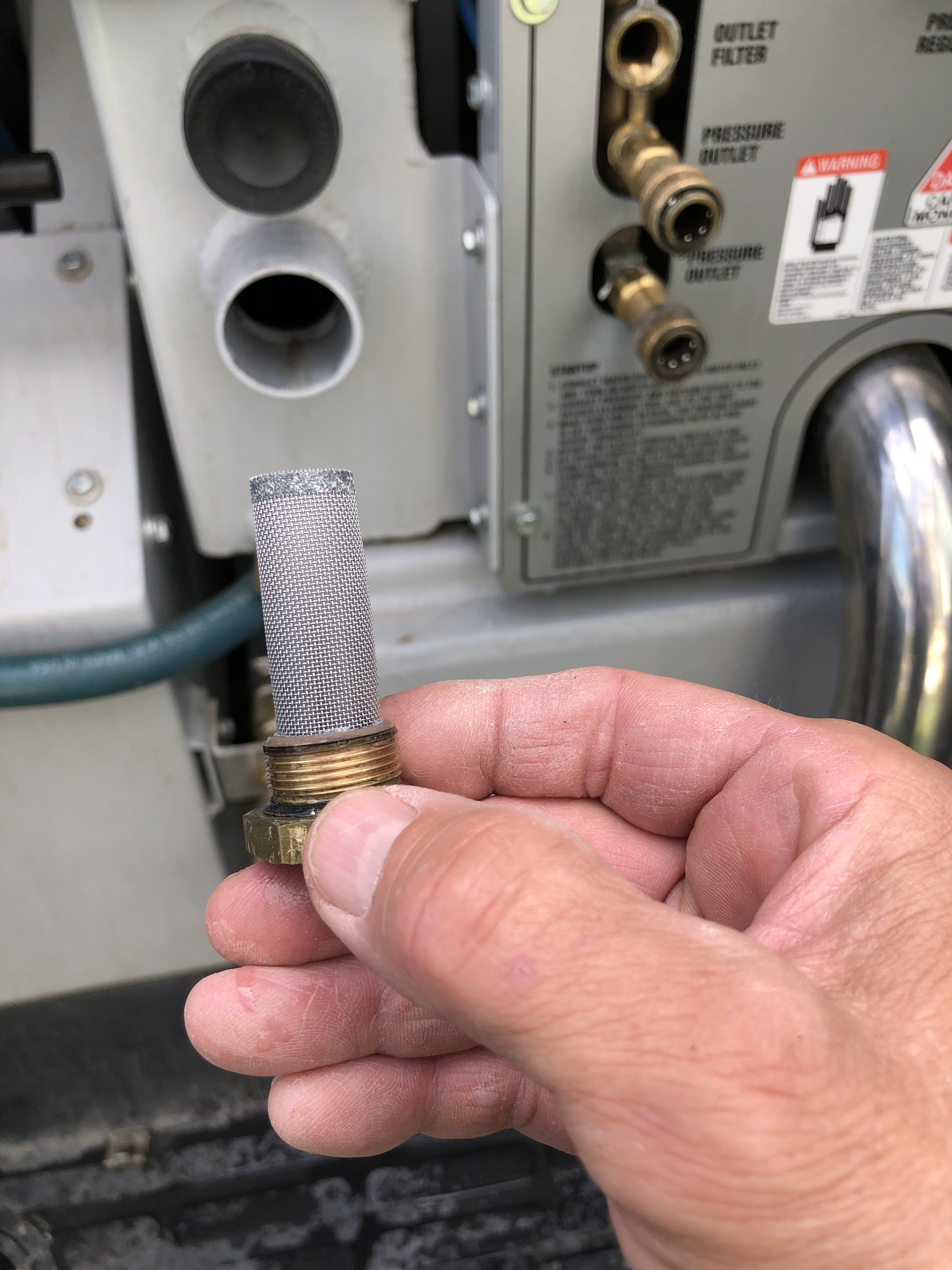

11,348
Pulled off out bound filter looks pretty clean!

Based on my pictures and user soft water and the outbound filter being clean, do you think I need to worry about yet 950 hours on machine
A water softener defiantly helps, I have always recommended at least once a year on descaling as a preventative maintenance.
